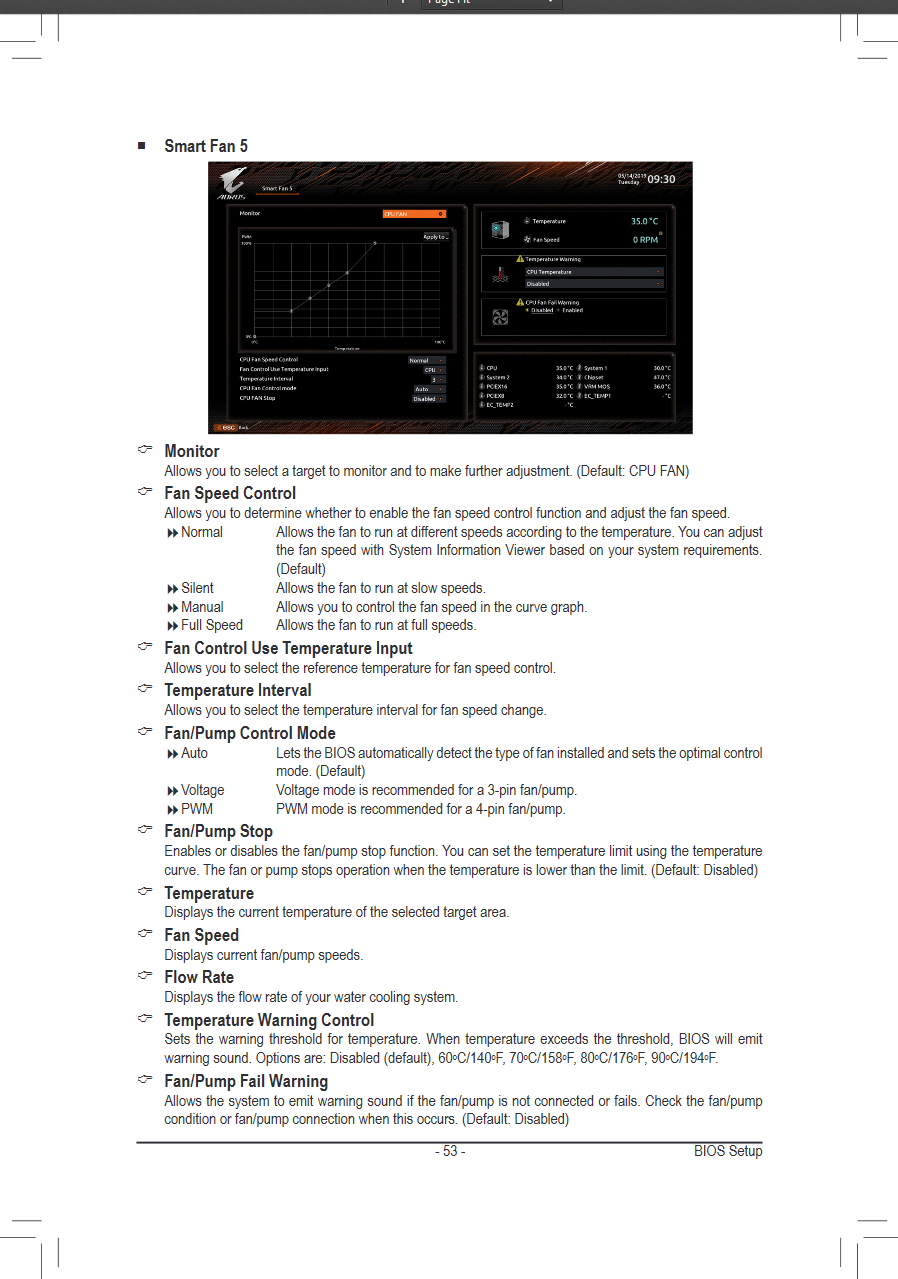

Es lässt sich doch eine Kurve einstellen
X570 AORUS MASTER Manual
Fan Speed Control
Manual Allows you to control the fan speed in the curve graph.
Fan Control Use Temperature Input
Allows you to select the reference temperature for fan speed control
Temperature Interval
Allows you to select the temperature interval for fan speed change.
Reaktionen: sloven
