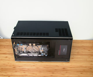

After long brake have received sfx prototype build ....
some pictures below, full gallry on imgur http://imgur.com/a/qfEI5
Usage of SFX power supply allows to install 60mm radiator:
with good spacing to the psu:
Below build with 38mm thick radiator:
Combo bracket allows to install D5 and DDC pumps for example Alphacool,Aquacomputer,Ekwb, Laing DDC, Heatsing for DDC:
Got the testing done with CPU on Water and GPU on Air - have to finish the video and upload :)

thanks, still copule of subjects to corecct and finish.
have video with temps testing for the cpu on water and gpu on air:
https://youtu.be/Tqdz5a-vKGA
