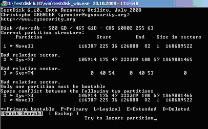

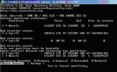

Da weiterhin nichts geht verwende ich Testdisk 6.10
Nach Intel und Analyse erhalte ich:
1 * Novell
Bad relative sector
2 * Sys = 73
Bad relative sector
3 * Sys = 74
Bad relative sector
3 * Sys = 74
Warning: Bad ending sector (CHS and LBA don’t match)
Only one partition must be bootable.
Space conflict between the following two partitions
Nach Quick Search:
The harddisk (500 GB/ 465 GiB) seems too small! (4948396 TB / 4500540 TiB)
Check the harddisk size: HD jumpers settings, Bios detection…
The following partitions can’t be recovered.
HFS ......
HFS ......

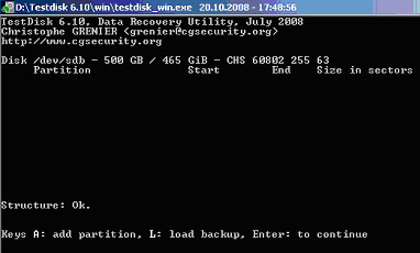

Nach Quick Search:
Disk /dev/sdb - 500 GB / 465 GiB - CHS 60802 255 63
Structure: Ok

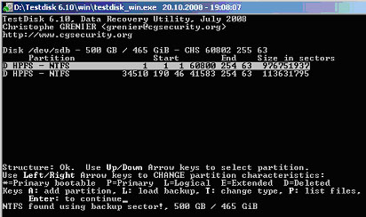

Nach Deeper Search:
D HPFS - NTFS 1 1 1 60800 254 63 976751937
D HPFS - NTFS 34510 190 46 41583 254 63 113631795
NTFS found using backup sector!, 500 GB / 465 GiB
-> P

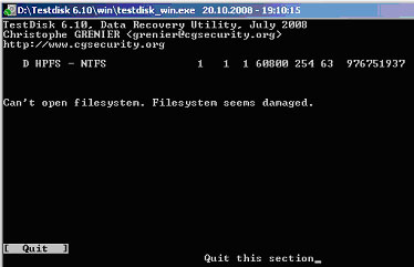

Can’t open filesystem. Filesystem seems damaged.
-> P
Directory /
dr - xr - xr - x ………………………………
