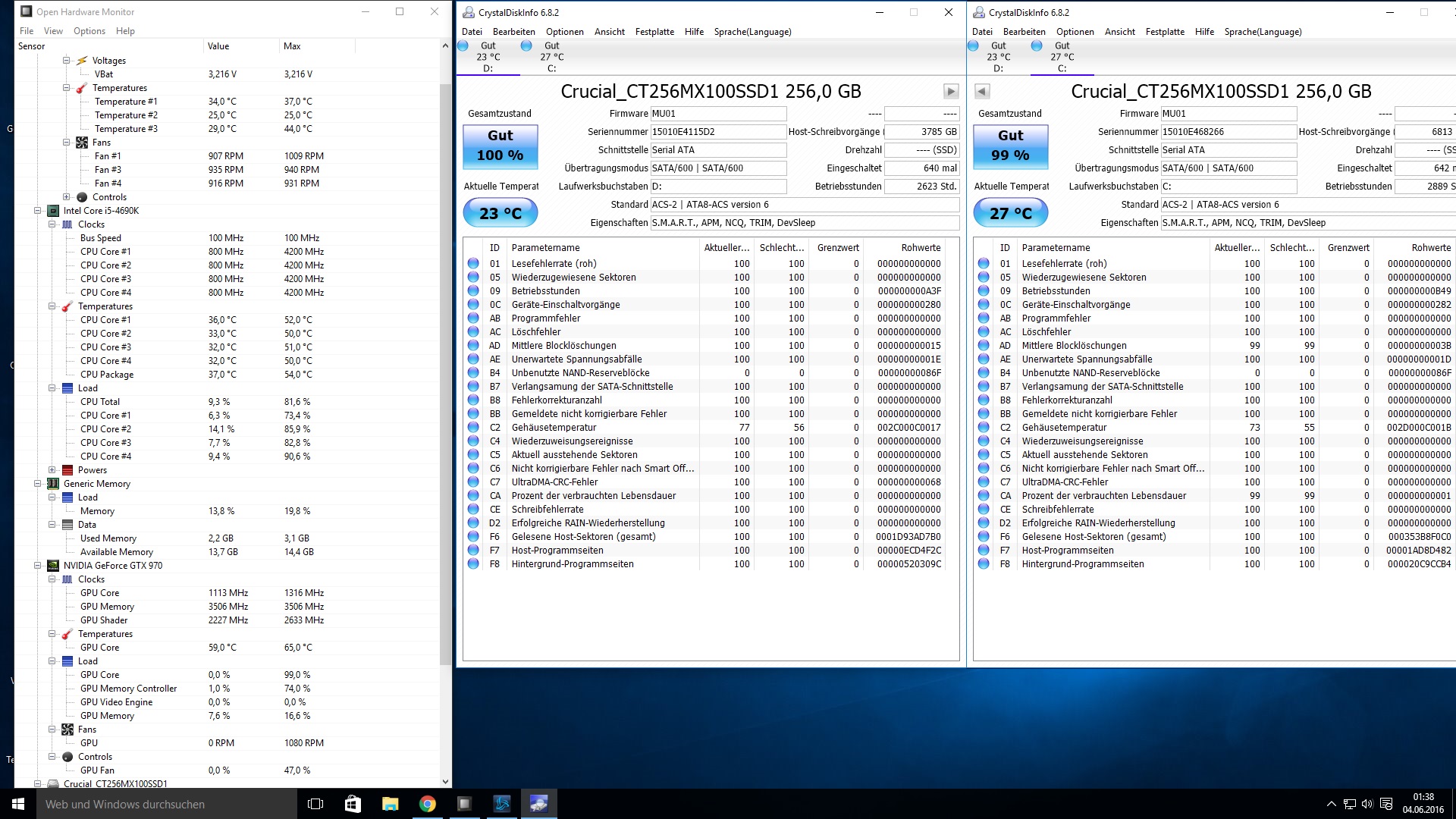

Diskinfo und Temps:
Edit: Firmware habe ich mal auf MU02 aktualisiert für die MX100'er
Improved stability, Efficiency, and Performance during power state transitions
Improved handling of environments with unstable power supplies
Improved handling of environments with SATA interface signal integrity issues <---- vllt auch mein Problem?
Improved response time for SMART read commands
Corrected error handling NCQ Trim Commands
Corrected reporting of SMART Attribute 5
