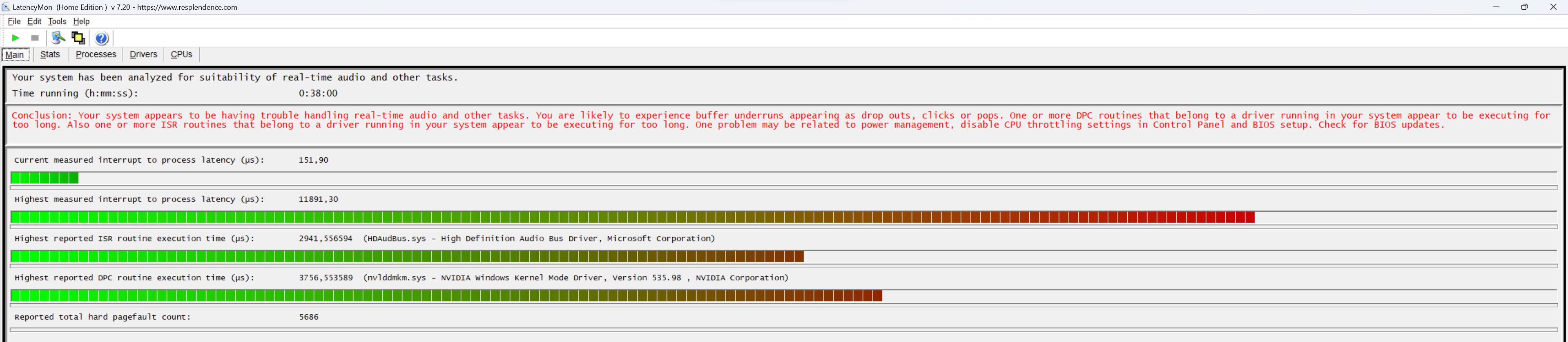

LATENCYMON
_________________________________________________________________________________________________________
CONCLUSION
Your system appears to be having trouble handling real-time audio and other tasks. You are likely to experience buffer underruns appearing as drop outs, clicks or pops. One or more DPC routines that belong to a driver running in your system appear to be executing for too long. Also one or more ISR routines that belong to a driver running in your system appear to be executing for too long. One problem may be related to power management, disable CPU throttling settings in Control Panel and BIOS setup. Check for BIOS updates.
LatencyMon has been analyzing your system for 0:38:00 (h:mm:ss) on all processors.

MEASURED INTERRUPT TO USER PROCESS LATENCIES
The interrupt to process latency reflects the measured interval that a usermode process needed to respond to a hardware request from the moment the interrupt service routine started execution. This includes the scheduling and execution of a DPC routine, the signaling of an event and the waking up of a usermode thread from an idle wait state in response to that event.
Highest measured interrupt to process latency (µs): 11891,30
Average measured interrupt to process latency (µs): 11,45090
Highest measured interrupt to DPC latency (µs): 671,20
Average measured interrupt to DPC latency (µs): 2,145774
REPORTED ISRs
Interrupt service routines are routines installed by the OS and device drivers that execute in response to a hardware interrupt signal.
Highest ISR routine execution time (µs): 2941,556594
Driver with highest ISR routine execution time: HDAudBus.sys - High Definition Audio Bus Driver, Microsoft Corporation
Highest reported total ISR routine time (%): 0,006043
Driver with highest ISR total time: dxgkrnl.sys - DirectX Graphics Kernel, Microsoft Corporation
Total time spent in ISRs (%) 0,007069
ISR count (execution time <250 µs): 138615
ISR count (execution time 250-500 µs): 0
ISR count (execution time 500-1000 µs): 321
ISR count (execution time 1000-2000 µs): 1
ISR count (execution time 2000-4000 µs): 2
ISR count (execution time >=4000 µs): 0
REPORTED DPCs
DPC routines are part of the interrupt servicing dispatch mechanism and disable the possibility for a process to utilize the CPU while it is interrupted until the DPC has finished execution.
Highest DPC routine execution time (µs): 3756,553589
Driver with highest DPC routine execution time: nvlddmkm.sys - NVIDIA Windows Kernel Mode Driver, Version 535.98 , NVIDIA Corporation
Highest reported total DPC routine time (%): 0,003797
Driver with highest DPC total execution time: ntoskrnl.exe - NT Kernel & System, Microsoft Corporation
Total time spent in DPCs (%) 0,010697
DPC count (execution time <250 µs): 611496
DPC count (execution time 250-500 µs): 0
DPC count (execution time 500-10000 µs): 1872
DPC count (execution time 1000-2000 µs): 13
DPC count (execution time 2000-4000 µs): 14
DPC count (execution time >=4000 µs): 0
REPORTED HARD PAGEFAULTS
Hard pagefaults are events that get triggered by making use of virtual memory that is not resident in RAM but backed by a memory mapped file on disk. The process of resolving the hard pagefault requires reading in the memory from disk while the process is interrupted and blocked from execution.
NOTE: some processes were hit by hard pagefaults. If these were programs producing audio, they are likely to interrupt the audio stream resulting in dropouts, clicks and pops. Check the Processes tab to see which programs were hit.
Process with highest pagefault count: chrome.exe
Total number of hard pagefaults 5686
Hard pagefault count of hardest hit process: 942
Number of processes hit: 42

Vielleicht hat jemand eine Idee, wie ich die Interrupt-Probleme lösen könnte? Leider brachte das MSI-Tool keine Abhilfe. Wäre Euch total dankbar!

"nvlddmkm.sys" & "ntoskrnl.exe" zeigen die höchsten Latenzen. Dabei schien es egal zu sein, welcher NVIDIA-Treiber oder welches BIOS installiert war.
