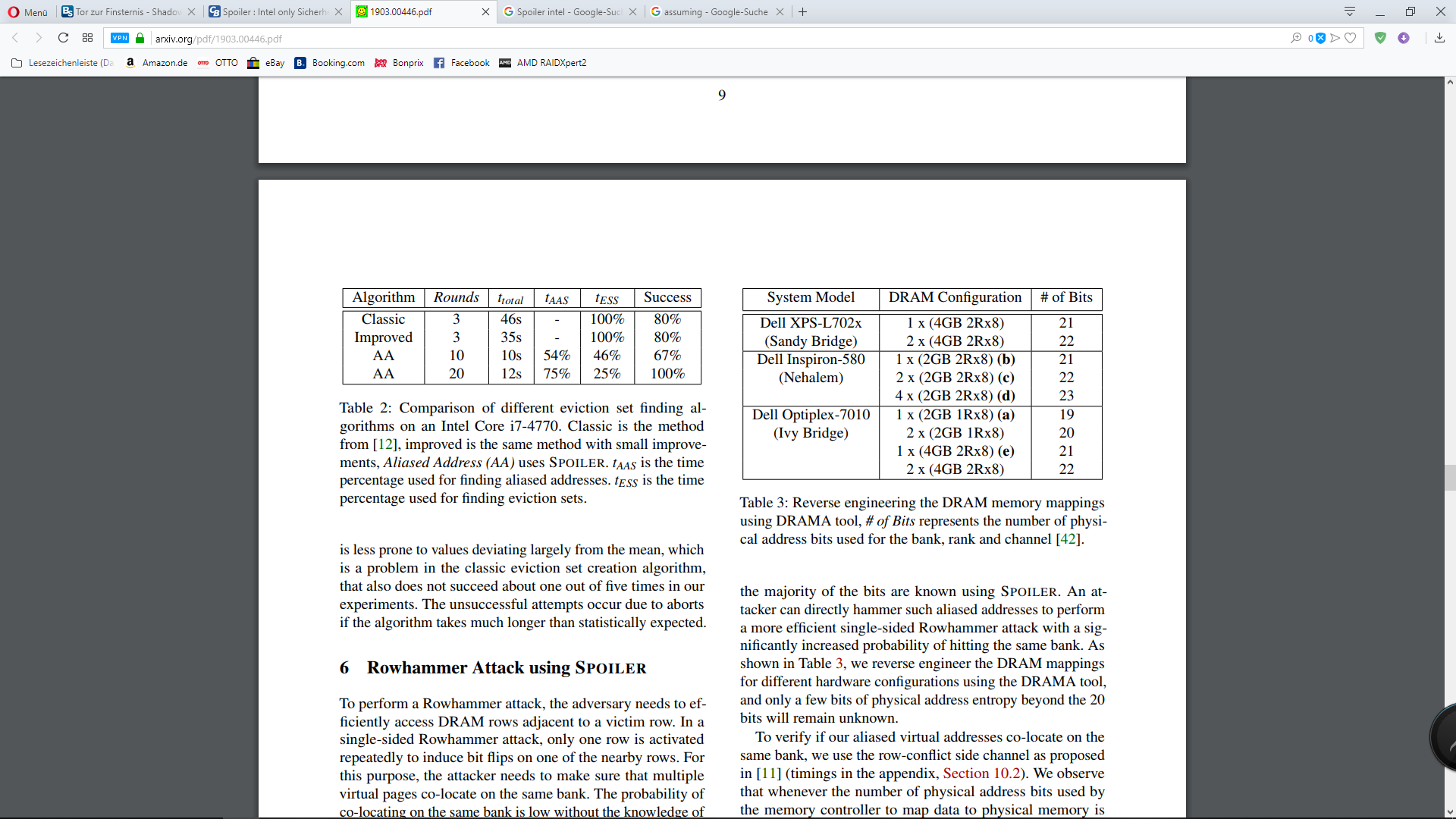

9 Conclusion We introduced SPOILER, a novel approach for gaining physical address information by exploiting a new information leakage due to speculative execution. To exploit the leakage, we used the speculative load behavior after jamming the store buffer. SPOILER can be executed from user space and requires no special privileges. While speculative execution enables both SPOILER and Spectre and Meltdown, our newly found leakage stems from a completely different hardware unit, the Memory Order Buffer. We exploited the leakage to reveal information on the 8 least significant bits of the physical page number, which are critical for many microarchitectural attacks such as Rowhammer and cache attacks. We analyzed the causes of the discovered leakage in detail and showed how to exploit it to extract physical address information. Further, we showed the impact of SPOILER by performing a highly targeted Rowhammer attack in a native user-level environment. We further demonstrated the applicability of SPOILER in sandboxed environments by constructing efficient eviction sets from JavaScript, an extremely restrictive environment that usually does not grant any access to physical addresses. Gaining even partial knowledge of the physical address will make new attack targets feasible in browsers even though JavaScript-enabled attacks are known to be difficult to realize in practice due to the limited nature of the JavaScript environment. Broadly put, the leakage described in this paper will enable attackers to perform existing attacks more efficiently, or to devise new attacks using the novel knowledge.
Responsible Disclosure We have informed the Intel Product Security Incident Response Team of our findings on December 1st, 2018, and they have acknowledged the receipt.
mit anderen Worten , bereits exestierende Malware wird durch die Informationen die man mit Spoiler erhalten kann wesentlich effektiver , zielgerichteter und erfolgsversprechender , das gilt erst recht für potenzielle neue Attacken
eine herkömmliche Attacke " Classic " = 46 Sekunden Erfolgsquote 80 %
mit Spoiler = 12 Sekunden Erfolgsquote 100 %
