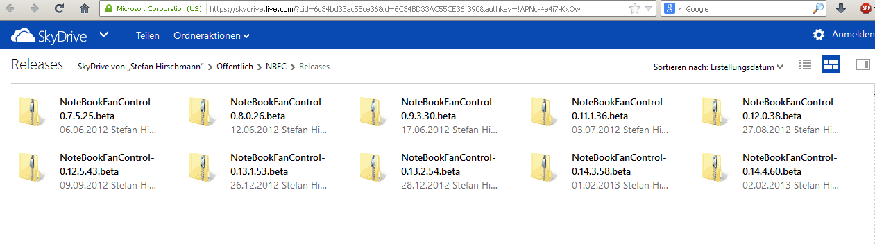

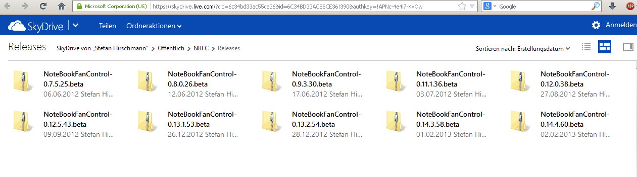

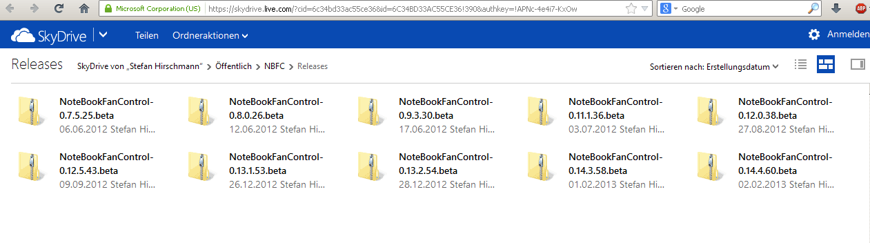

You have to "Klick" on the link in the red area on first post in this thread: nfc.png
Then should open this side: skydrive.png
Now should a "Klick" on a version start the download.
May be, java will be needed.
