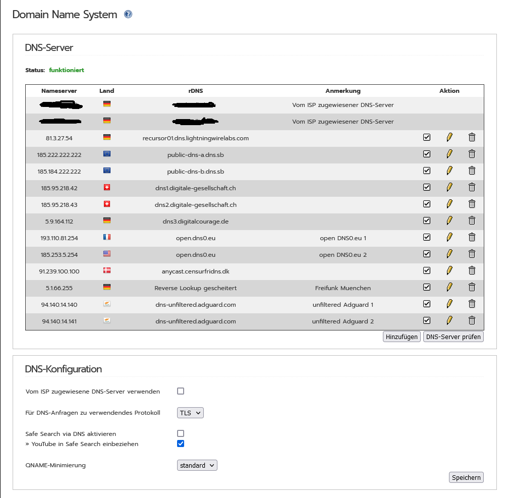

Benutze ja IPFire und da kannste die verschiedensten DNS-Resolver hinterlegen. Die werden auch regelmäßig getestet und Server, die schlechte Response-Zeiten haben, werden auch seltener genutzt. Ansonsten werden die DNS-Anfragen über die Server gespreaded, so dass die DNS-Resolver nur eine unvollständige DNS-History bekommen.
Code:
                         Will check now your configured DNS-over-TLS servers from '/var/ipfire/dns/servers'
From Host: unfiltered.adguard-dns.com ---- With IP: 94.140.14.141 ---- Date: Thu Mar  7 11:24:31 AM CET 2024
in 140.4 ms
The encryption is OK and works with: TLS1.3-ECDHE-X25519-ECDSA-SECP256R1-SHA256-AES-128-GCM
The certificate is trusted and OK
The DNSSEC validation works and is OK
From Host: dns.sb ---- With IP: 185.222.222.222 ---- Date: Thu Mar  7 11:24:31 AM CET 2024
in 111.2 ms
The encryption is OK and works with: TLS1.3-ECDHE-SECP256R1-ECDSA-SECP256R1-SHA256-AES-256-GCM
From Host: open.dns0.eu ---- With IP: 193.110.81.254 ---- Date: Thu Mar  7 11:24:32 AM CET 2024
in 110.3 ms
From Host: anycast.censurfridns.dk ---- With IP: 91.239.100.100 ---- Date: Thu Mar  7 11:24:32 AM CET 2024
in 147.6 ms
The encryption is OK and works with: TLS1.3-ECDHE-SECP256R1-ECDSA-SECP384R1-SHA384-AES-256-GCM
From Host: open.dns0.eu ---- With IP: 185.253.5.254 ---- Date: Thu Mar  7 11:24:32 AM CET 2024
in 112.1 ms
From Host: dns.digitale-gesellschaft.ch ---- With IP: 185.95.218.43 ---- Date: Thu Mar  7 11:24:32 AM CET 2024
in 137.1 ms
From Host: dns.digitale-gesellschaft.ch ---- With IP: 185.95.218.42 ---- Date: Thu Mar  7 11:24:32 AM CET 2024
in 136.8 ms
From Host: recursor01.dns.ipfire.org ---- With IP: 81.3.27.54 ---- Date: Thu Mar  7 11:24:33 AM CET 2024
in 149.8 ms
From Host: dot.ffmuc.net ---- With IP: 5.1.66.255 ---- Date: Thu Mar  7 11:24:33 AM CET 2024
in 129.6 ms
The encryption is OK and works with: TLS1.3-ECDHE-SECP256R1-RSA-PSS-RSAE-SHA256-AES-256-GCM
From Host: dns3.digitalcourage.de ---- With IP: 5.9.164.112 ---- Date: Thu Mar  7 11:24:33 AM CET 2024
in 196.0 ms
From Host: unfiltered.adguard-dns.com ---- With IP: 94.140.14.140 ---- Date: Thu Mar  7 11:24:33 AM CET 2024
in 123.1 ms
From Host: dns.sb ---- With IP: 185.184.222.222 ---- Date: Thu Mar  7 11:24:33 AM CET 2024
in 113.8 ms
All enabled DNS-over-TLS servers from /var/ipfire/dns/servers has been tested.
Reaktionen: CaptainPighead
