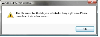

Wenn ich auf der Asus Seite downloaden will erscheint eine meldung
Please note, BIOS update is only recommended when experiencing technical difficulties with your system, And is not recommended to be performed regularly.
Moreover, due to the nature of BIOS update, there is certain level of dangers involved. BIOS update must be performed with extreme caution . During BIOS update process, your system must be maintained without interference or power loss to prevent unexpected damage.
In case of BIOS update failure, please follow instructions in your User's Manual for guidelines on BIOS recovery via CrashFree BIOS. In the event that BIOS recovery is not recoverable via CrashFree BIOS, please contact your place of purchase for further assistance on BIOS recovery.
Auch bei den anderen bzw älteren Bios versionen bekomm ich diese Meldung..
Downloaden kann ich anschließend nichts.. :(
