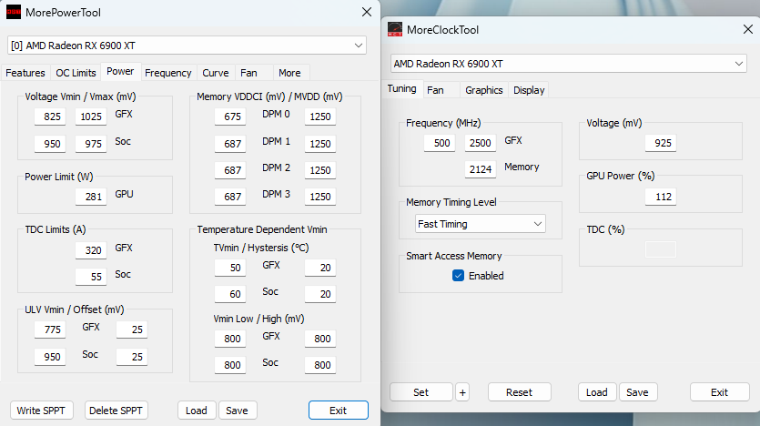

cra3khead schrieb:
Update: It's not stable; 2124 at 687/1250 mv gets through more BO6 matches without crashing; I can't finish one game with the previous setting.
Did you try in COD to limit the Vram-Usage to 0,6?
may be the Engine creates more stress@open Vram-Limit then required / allowed
some People have seen 24GB-Vram-Usage = full Usage = not normal
memory leak ?

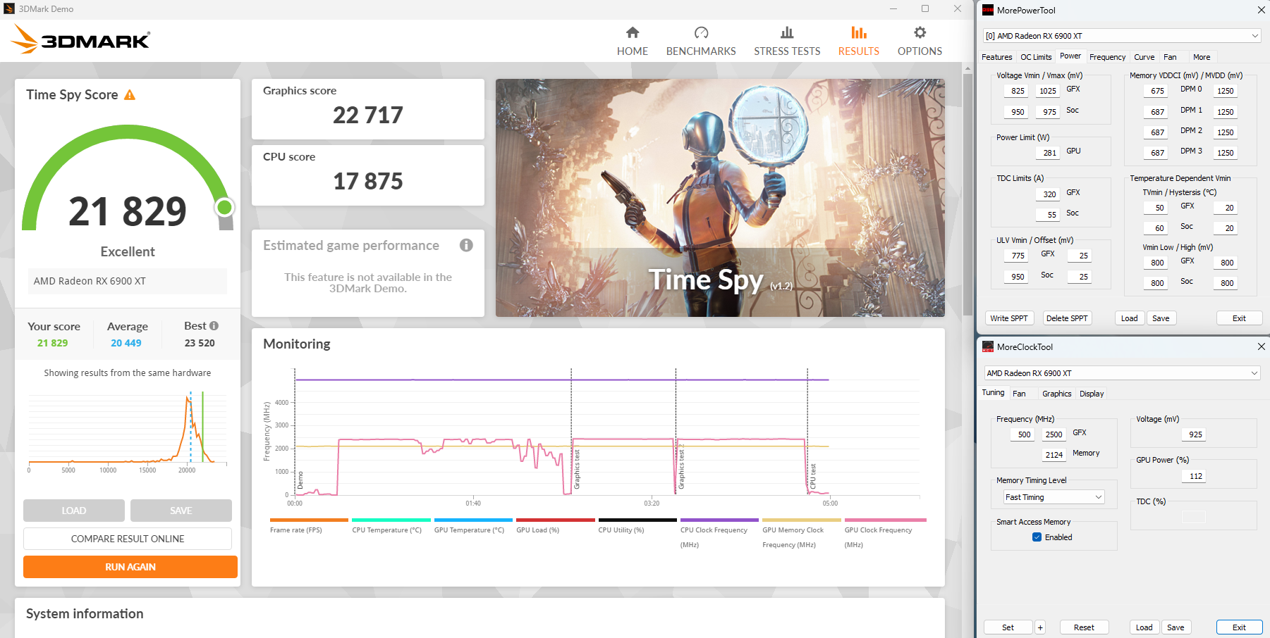

@GerryB I lowered the core voltage and clock speed a little and haven't had a crash so far. Do you think my vram wasn't a problem all along? Should I just leave like this? I wish I could keep a 2.5GHz effective speed though; this setup is 2440MHz.

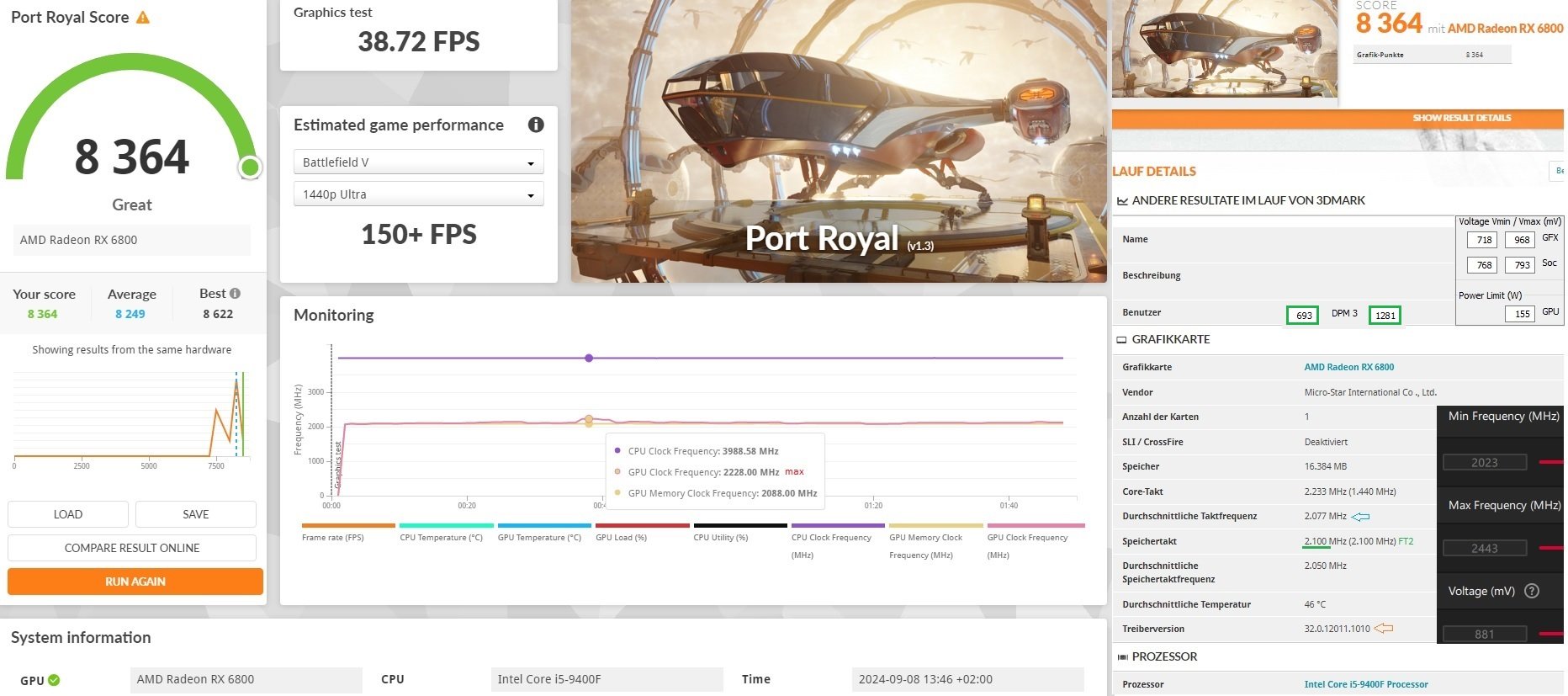

It's about 100 points lower than my last setting, but in games it performs worse.
Update: Nevermind, it lasted longer without crashing, but instead of a crash after 3 games, it was a crash after like 5 games. I still think it's heat-related, but what could be getting too hot that causes a DX12 error? I don't think it would be the ddr5 ram since I just get an AMD error, not whea or system crash.
looks good, but why GPU Power 112% ?
with this clock<2500MHz may be 105% is enough and not so much slower, score>22k should be enough@24/7
and
may be SOC+fclk a little bit slower with lessVolts, some 6...12mV less?
(25...50MHz less fclk-clock 1875? and SOC=1000...975MHz is enough)

try less Offset, your combination MPT 1025mV with MCT 925mV is 100mV Offset
whats with MCT 931mV ? ... only in this game

btw.

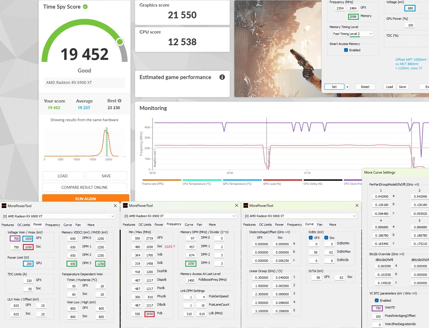

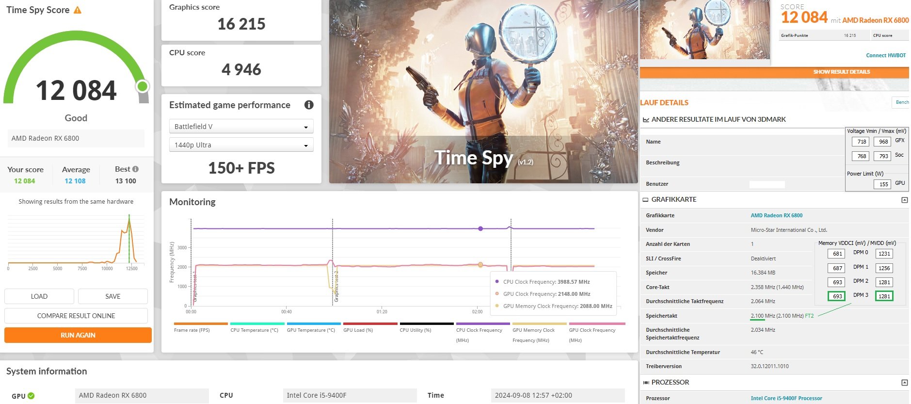

Fas7play@Luxx takes only 2098FT2 with DPM3=1050, seems to run at his very good and cold Vram
with low 650/1250 volts, = easier+more stable then 2124FT1 ?
(may be, thats too low volts with my bad vram, ... needs 693/1281mV)

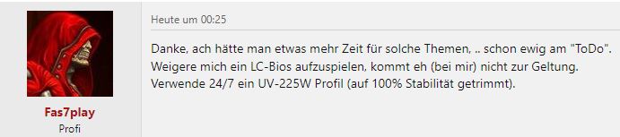

Fas7play said, it´s optimized stable, but may be in games that offset MPT 1000mV MCT 880mV doesn´t work.(x)
I think he means SOC+fclk+vram-volts are stable enough@24/7 with 225W, but he has really very good vram.
(I need more = 693/1281mV with this vramclock@FT2)
(x) that´s the point, where everyone could a have a difference between stable TS and real games
in TS is Offset easier to achieve in 1 Run, then gaming 2-3 hours

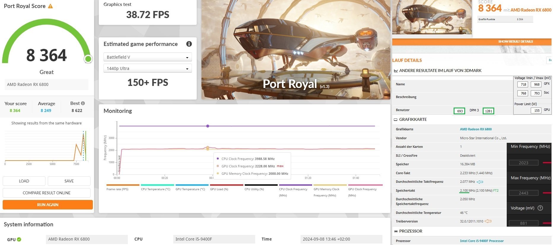

btw.
I don´t know if my little 6800 this more bandwidth+FT2 needs in TS, but PR should be also a good test.
The bigger 6900 should have more advantage with FT2.

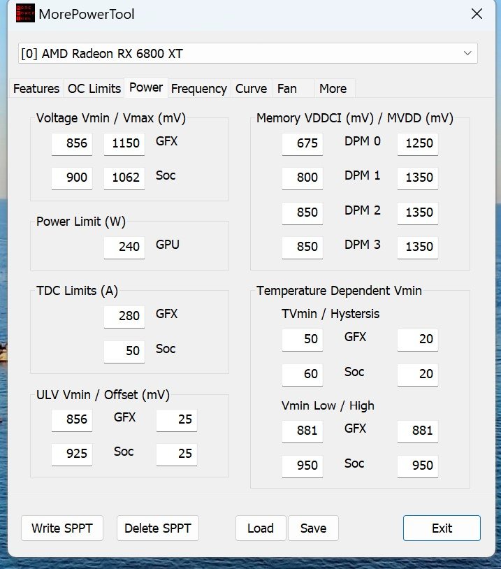

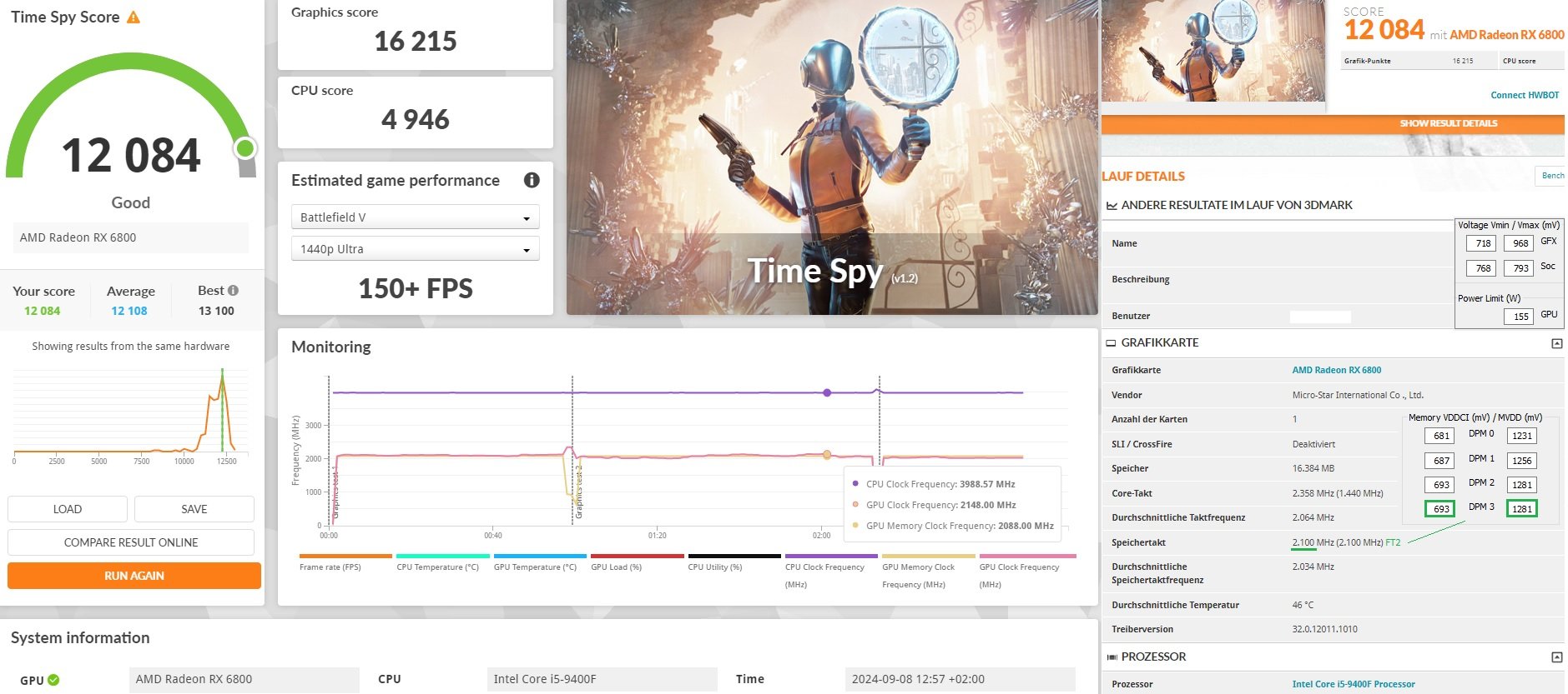

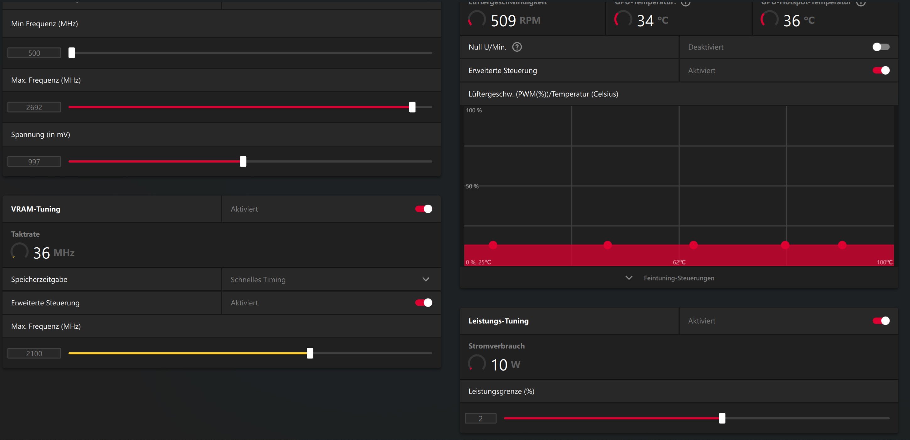

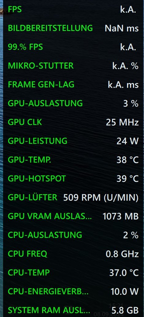

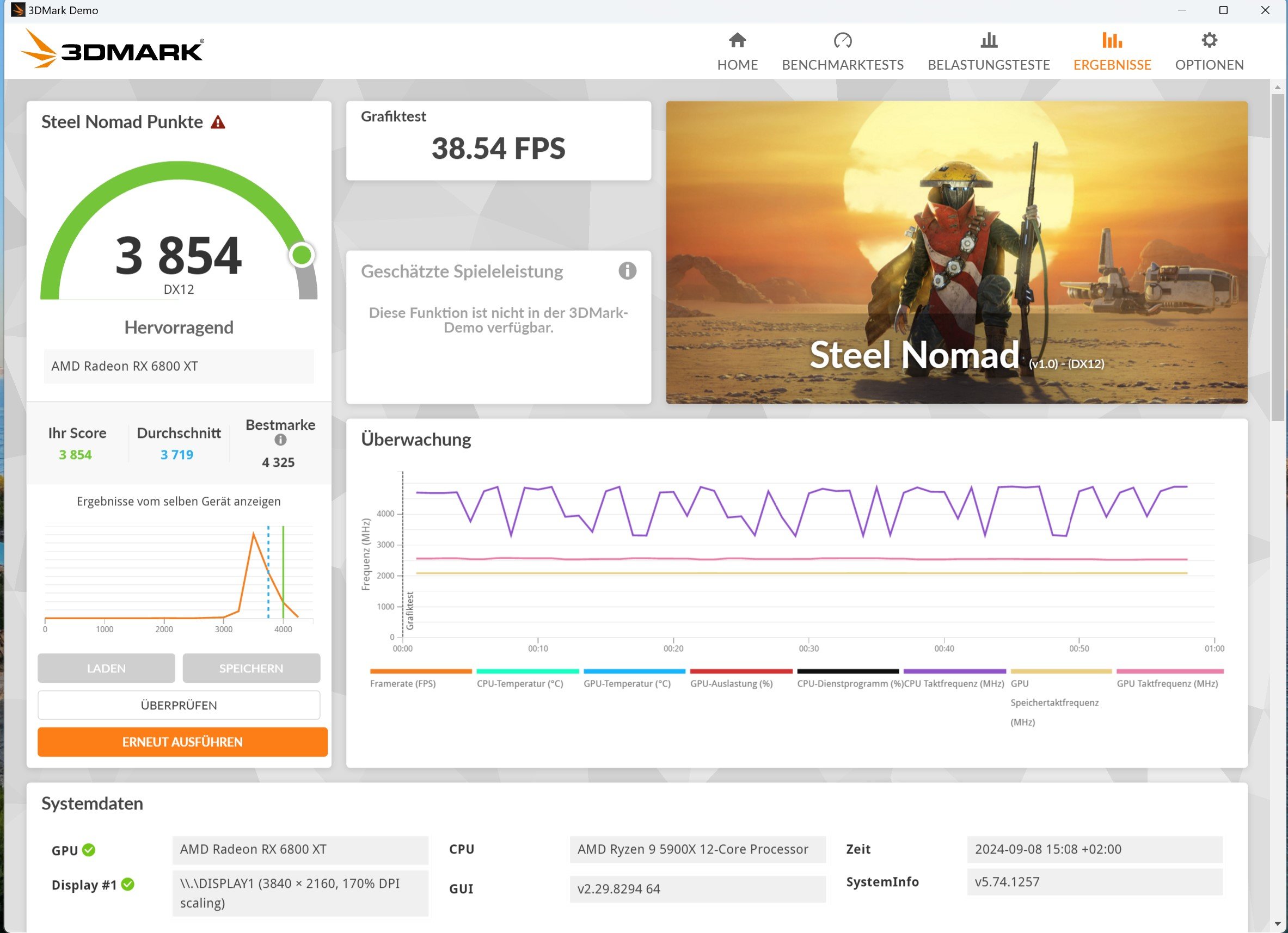

Hallo, bin auch mal wieder da, musste mal wieder meine Grafikkarte öffnen und WLP tauschen und mit thermal Putty Unterfüttern.
Temps sind wieder super, aber wollte noch ein wenig meine 6800XT etwas mehr fein Tuning betreiben, also UV mit Taktanhebung ohne den schönen hohen Takt zu verlieren.
Hat vielleicht noch jemand eine Idde was ich noch ändern könnte ohne den schönen hohen Takt zu verlieren
Screenshot 2024-09-08 150618.jpgScreenshot 2024-09-08 150658.jpgScreenshot 2024-09-08 151025.jpg

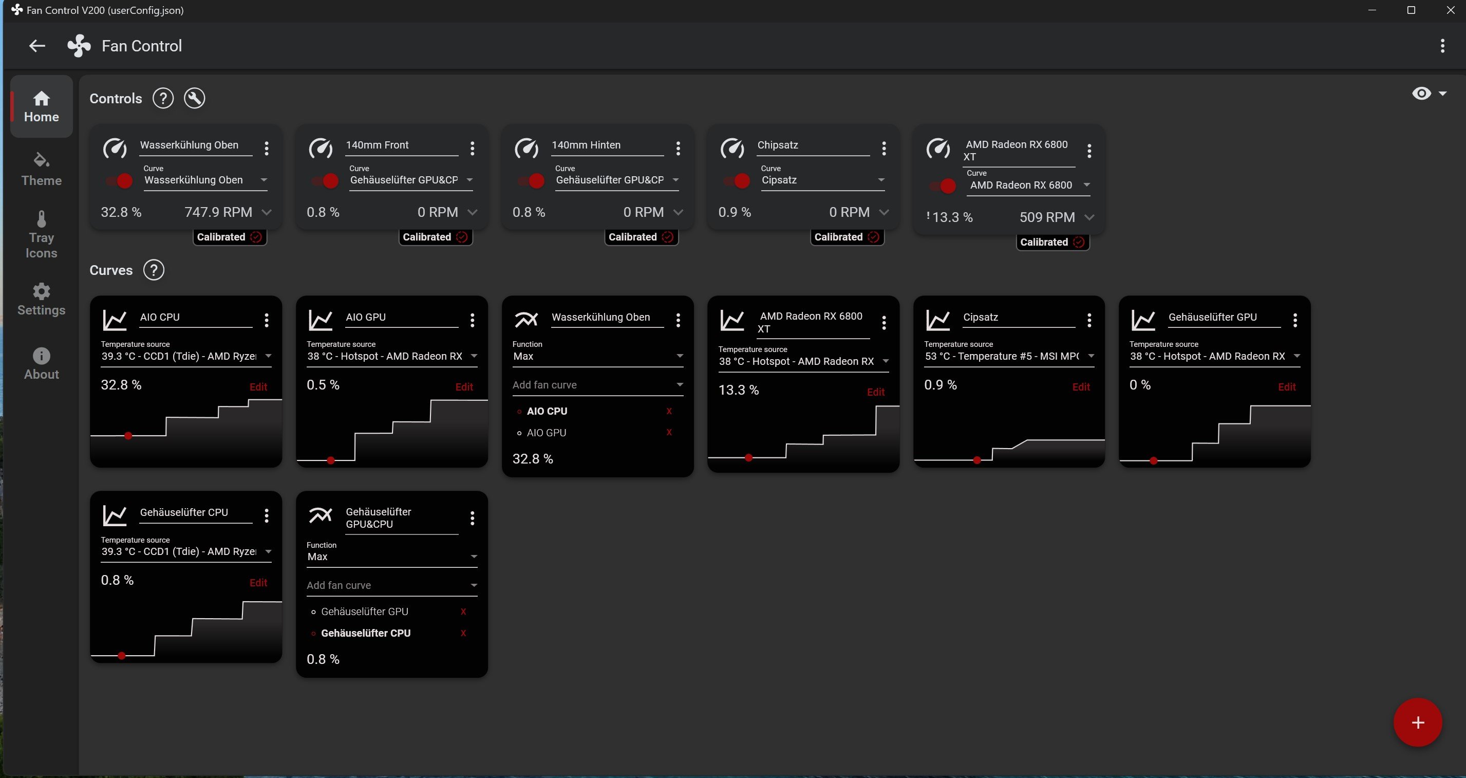

Aso Lüfter werden über fan Control gesteuert nicht wundern 😊

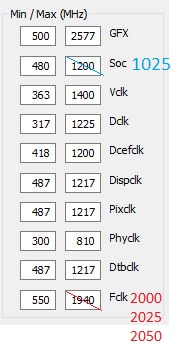

Versuch doch mal, ob Du mit Deinen 1063mV den SOC=1025MHz und den fclk=2050MHz laufen lassen kannst.
... wenn nicht, reicht ja auch SOC=1000MHz und fclk=2000MHz
und
Natürlich wie immer beim Vram die Volt optimieren, damit die neue Putty nicht so schnell austrocknet.
(die Putty sollte nur auf Vram+Spawas sein)

MSI-MATZE schrieb:
Wollte doch am takt nix ändern, Würde schon gerne die Geschwindigkeit bei behalten. ...
Vram immer so bei 2100mhz das reicht vollkommen.
Das Du so hohe Volt beim Vram brauchst bzw. default 850/1350 lässt, ist nicht optimal.
bzw.
Geschwindigkeit ist ja erstmal nur GPU-Takt+UVen, woran sich nichts ändert, aber bei der hohen SOC-Spannung
würde ich schon versuchen fclk-Takt und SOC-Takt zu optimieren.
Alles bezogen auf Deinen Post#6.809, der wenig optimiert ist:

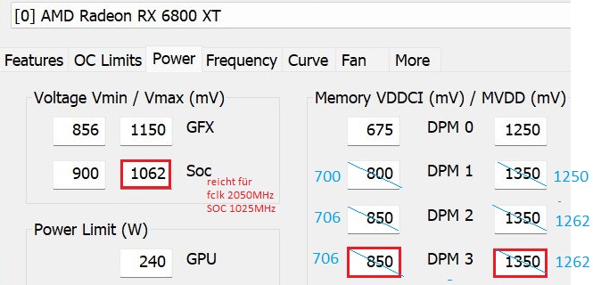

meistens sollte SOC-Takt 1025MHz gut zu fclk 2050MHz passen, ... habe bis jetzt kaum Jemanden gesehen
der mit dem Verhältnis 1:2 nicht ausgereicht hat
k.A. ob bei Dir der SOC-Takt noch mit 1200MHz = default drin steht, = mehr als der fclk braucht
und mit den 1062mV geht vllt. sogar ein Anheben des fclk von 1940 auf 2000....2025...2050MHz
(würde ich schrittweise austesten)
