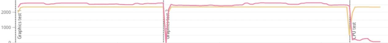

nice to see, the great Offset@your 6900
may be, the score could be higher with more maxClock 2590...2595MHz@1062mV (?)
the clockrate looks to flat = most of time the GPU is not powerlimited but clocklimited
Reaktionen: cra3khead
sounds not ideal, may be MCT minClock 500-->2300MHz helps, .... if minClock=LD3
(or 1075....1081mV with min2500/max2600MHz would be the next higher interesting Combination, if minClock=LD4 )

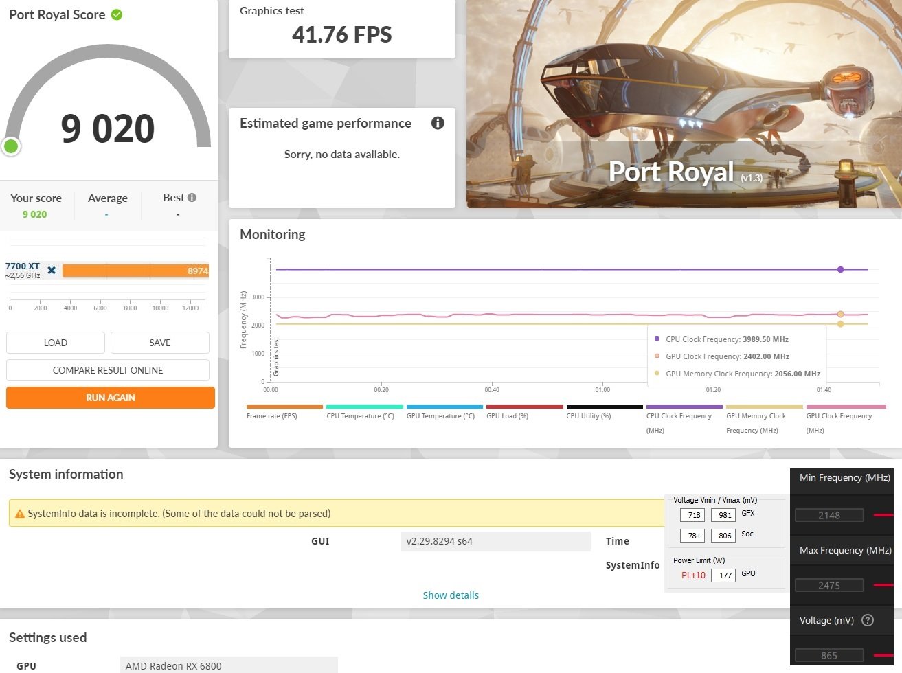

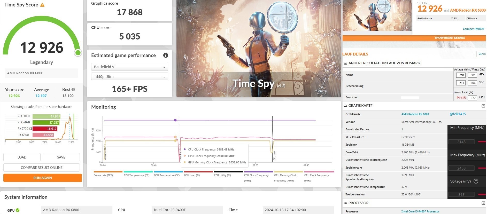

I use 975mV / 1000MHz SoC with 1900MHz FCLK because I find very little measurable gains with higher FCLK. And this way Soc is 19W, while for others it is 30-40W. Try it out for yourself and report back, would be interesting!
