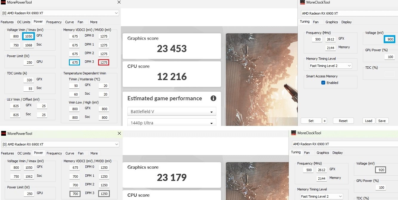

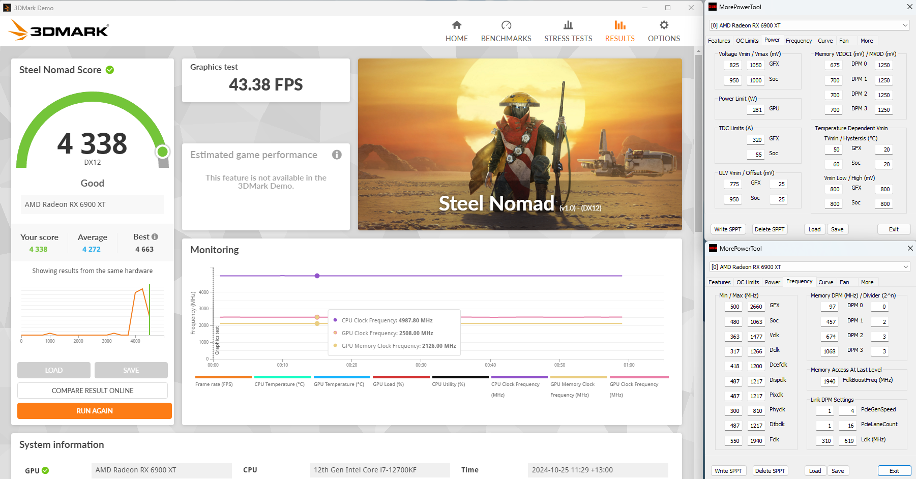

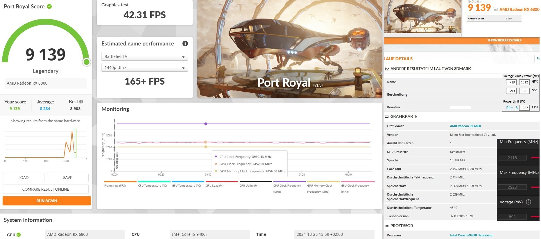

Quick test, previous settings had a score of 4276; if I recall correctly. (Wasn't Stable)
New Setting.
Update: I killed my card; the vram died :mad:

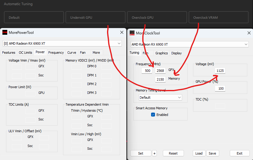

@GerryB For some reason, at "default," I can play Black Ops 6 without crashes. How would I go about changing things in MPT to see what was the problem initially?
I'm literally just using the numbers spit out from the Automatic Tuning generator without any MPT SPPT, and my problems went away.
Ehm - of course, because you did not undervolt your VRAM with MPT, which likely is the root cause of pixel errors?

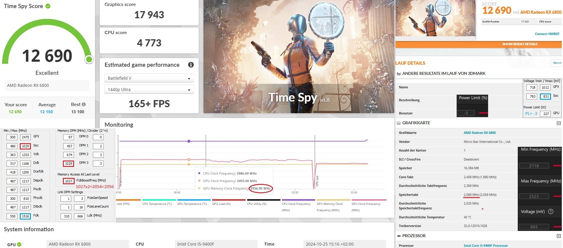

btw.
Eigentlich nutze ich gar nicht so einen hohen SOC-Takt, aber um mal zu schauen, ob die SOC-Volt davon abhängen, bin ich auch mal >1000MHz gegangen, ... SOCx2>eff.Vramtakt.
Dabei bleibt meine erf.SOC-Spannung weiterhin primär vom niedrigen fclk der 6800 abhängig.
(fclk 1516 ist gar nicht soooviel niedriger als default 1550, aber es geht schon deutlich weniger Volt, ...
gamestable war dann immer fclk1512 mit den 831mV)

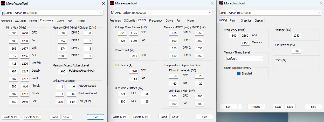

These are my current settings. If I touch the SOC or the VRAM at all, the game crashes nonstop; right now it's fine just like this; I don't know what else I can do. It's only Black Ops 6 with this issue; I haven't had problems with any other games with my previous settings.
If BO6 is so crappy for your card, then it is so.

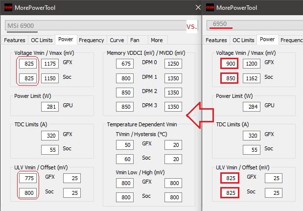

may be
the problem is not related to vram only
but also to some min volts if the clock changes to fast in the game
(sometimes a crash is not at high clocks but during clockchange to low clocks)
try the higher min gfx + soc and ulv volts like 6950
Reaktionen: cra3khead
Yeah, even the settings with only the GFX Vmax being the only variable changed crashed last night. I will try with the higher min volts and see if that could stabilize the most previous setting I was using, but it doesn't make sense how I can change all the Wattman settings and the game will behave fine; but, as soon as I involve MPT, the game starts crashing like crazy.
