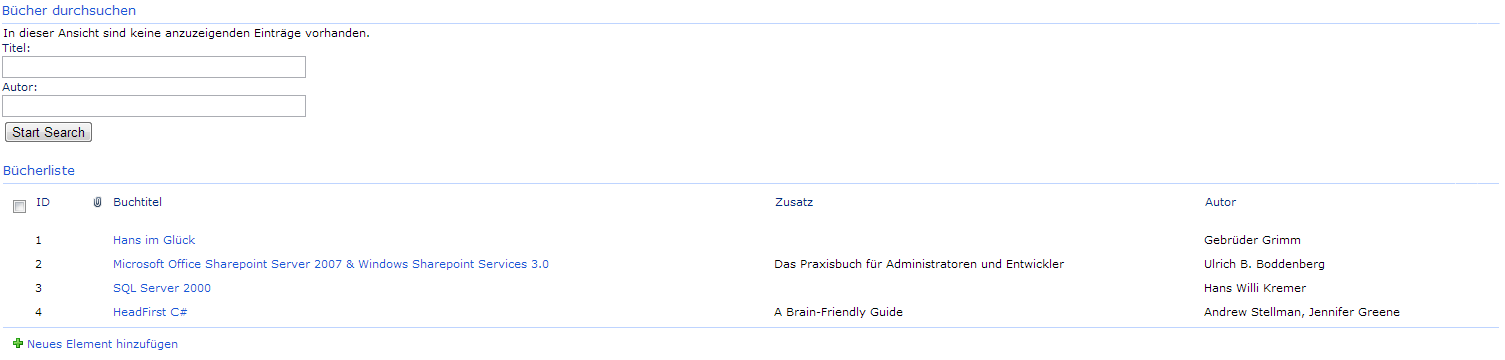

Würde um das Thema Webpart und CAML geschrieben in C# gehen, dazu solche Sachen wie z.B. RenderContent() und SPGridview.
Habt ihr da etwas Ahnung oder soll ichs gleich lassen?^^ Oder soll ichs einfach mal probieren und euch meinen Code samt Problem in nen Post klatschen? :D
LG
Hui so eine schnelle Antwort^^
Also erstmal der Code des Webparts:
Code:
using System;
using System.Data;
using System.ComponentModel;
using System.Web;
using System.Web.UI;
using System.Web.UI.WebControls;
using System.Web.UI.WebControls.WebParts;
using Microsoft.SharePoint;
using Microsoft.SharePoint.WebControls;
namespace BookSearchProject.SearchWebPart
    [ToolboxItemAttribute(false)]
    public class SearchWebPart : WebPart
        protected TextBox textTitle;
        protected TextBox textAuthor;
        protected Button startSearch;
        string Eingabe = "";
        protected SPDataSource datasource;
        //Boolean für Prüfen der Eingabe im Textfeld
        bool isText;
        protected SPGridView spGrid;
        string url="http://vm-cse-bizagi/";
        protected override void CreateChildControls()
            base.CreateChildControls();
            this.textTitle = new TextBox();
            this.textTitle.Columns = 100;
            this.textTitle.MaxLength = 255;
            this.textTitle.Width = 300;
            //this.Controls.Add(new LiteralControl("<div>Titel: "));
            this.Controls.Add(this.textTitle);
            //this.Controls.Add(new LiteralControl("</div>"));
            this.textAuthor = new TextBox();
            this.textAuthor.Columns = 100;
            this.textAuthor.MaxLength = 255;
            this.textAuthor.Width = 300;
            //this.Controls.Add(new LiteralControl("<div>Autor: "));
            this.Controls.Add(textAuthor);
            this.startSearch = new Button();
            this.startSearch.Text = "Start Search";
            this.Controls.Add(startSearch);
            this.spGrid = new SPGridView();
            this.spGrid.AutoGenerateColumns = false;
            this.spGrid.AllowPaging = true;
            this.spGrid.PageSize = 10;
            BoundField boundField = new BoundField();
            boundField.HeaderText = "ID";
            boundField.DataField = "ID";
            this.spGrid.Columns.Add(boundField);
            boundField.HeaderText = "Buchtitel";
            boundField.DataField = "Title";
            boundField.HeaderText = "Untertitel";
            boundField.DataField = "Zusatz";
            boundField.HeaderText = "Autor";
            boundField.DataField = "Autor";
            //Ausrichtung des Textes (Spaltenüberschriften) nach links
            this.spGrid.HeaderStyle.HorizontalAlign = HorizontalAlign.Left;
            this.Controls.Add(this.spGrid);
            this.datasource = new SPDataSource();
            this.Controls.Add(this.datasource);
        protected override void  RenderContents(HtmlTextWriter writer)
            SPSite site = new SPSite(url);
            SPWeb web = site.OpenWeb();
            SPList list = web.Lists["Bücherliste"];
            this.datasource.DataSourceMode = SPDataSourceMode.List;
            this.datasource.SelectCommand =
                        "<View>" +
                            "<ViewFields>" +
                                "<FieldRef Name=\"ID\"/>" +
                                "<FieldRef Name=\"Title\"/>" +
                                "<FieldRef Name=\"Zusatz\"/>" +
                                "<FieldRef Name=\"Autor\"/>" +
                            "</ViewFields>" +
                            "<Query>" +
                                "<OrderBy>" +
                                    "<FieldRef Name=\"ID\" Ascendung=\"True\"/>" +
                                "</OrderBy>" +
                                "<Where>" +
                                    "<Eq>" +
                                        "<Value Type=\"Text\">" + Eingabe + "</Value>" +
                                    "</Eq>" +
                                "</Where>" +
                            "</Query>" +
                        "</View>";
            this.spGrid.AllowSorting = true;
            this.spGrid.CssClass = "ms-listviewtable";
            this.spGrid.AlternatingRowStyle.CssClass = "ms-alternating";
            this.spGrid.Width = new Unit(50, UnitType.Percentage);
            this.spGrid.GridLines = GridLines.None;
            this.spGrid.HeaderStyle.Font.Bold = true;
            this.spGrid.DataSource = this.datasource;
            this.spGrid.DataBind();
            this.spGrid.RenderControl(writer);
            //Label um Darstellung etwas zu modifizieren (Umbrüche)

Ich hoffe mal du kannst was damit anfangen^^ (Probiere immer mal was aus, sollte dir was auffallen kann es sein ich habs vergessen weg zu machen, aber trotzdem bitte drauf hinweisen :D)
Mein Problem is folgendes:
Ich möchte über Textfelder eine Liste Filtern. Webpart und Quellliste findest du unten im Anhang. Ich bekomme alles hin mittlerweile mit ein paar Webquellen, sprich wenn ich die CAML-Query im Code festlege dann wirds auch super angezeigt.
Nun möchte ich aber mit der Eingabe im Textfeld diese Query dynamisch gestalten, was aber partout nicht klappen will, das Webpart reagiert sozusagen auf den Button überhaupt nicht.
Wenn du also weißt wie ich das variabel umsetzen kann wär ich hocherfreut ^^
LG
