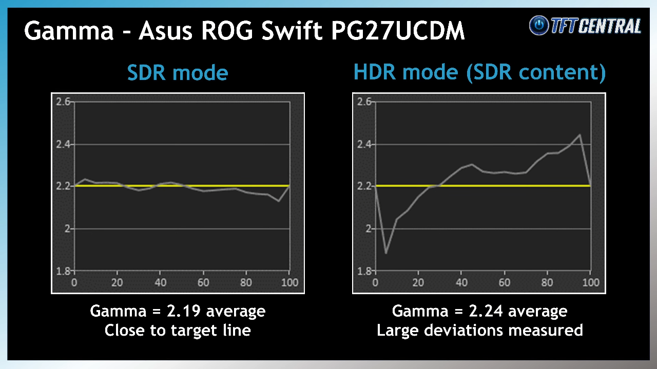

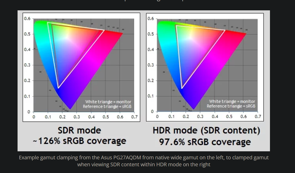

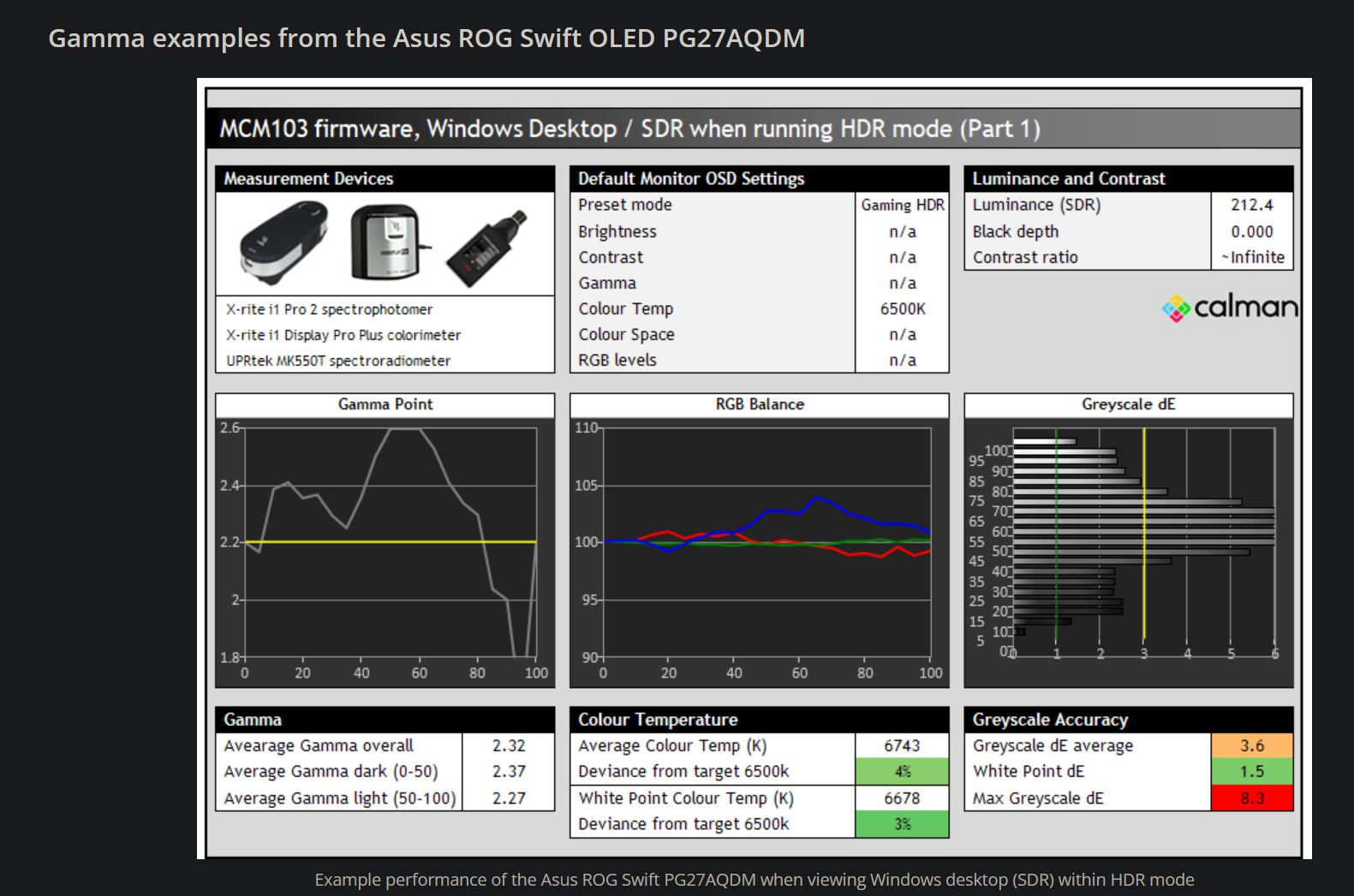

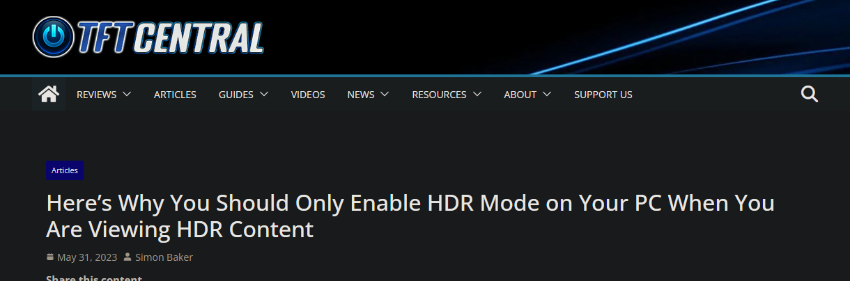

The problem that arises is that actually the content you’re viewing when you first turn this on in Windows is SDR content, normally from your desktop and designed to operate with an SDR gamma, commonly sRGB (or very close to the common 2.2 gamma). The content you are viewing is trying to operate in SDR mode, while the display device is running in its HDR mode. This is what causes the common washed out appearance people complain about. HDR isn’t washed out though – using HDR mode for SDR content is washed out! This doesn’t mean your screen is broken or rubbish, it just means you’ve got a mis-match between content and display.
"Many screens look bad in HDR mode when viewing Windows Desktop and SDR content
We’ve seen some displays handle Windows desktop within HDR mode pretty well, and some can look quite decent. Normally you can tell straight away if it’s going to look alright, or just plain terrible as soon as you enable HDR mode. There are other challenges though as discussed below to be aware of and we still wouldn’t suggest leaving this turned on all the time, even if Windows does look ok in HDR mode initially. Most screens we’ve seen look sub-optimal or sometimes just terrible in Windows when you first enable HDR. This doesn’t seem to be any better between Windows 10 or 11 by the way, most monitors still look “off” when running HDR for desktop mode and SDR content. They will normally look better when you then view HDR content for which the mode is designed, but it’s very common for HDR modes to look bad initially for Windows desktop and non-HDR content you might be using.
Power consumption will be unnecessarily high, also impacting heat output and lifespan​
Use HDR mode only for HDR content! – Plus a handy shortcut​
Hopefully you can see all the reasons why using HDR mode all the time is really a bad idea. So our recommendation after all this is to only enable HDR mode and run the screen in HDR mode when you’re viewing actual HDR content. Don’t leave it active all the time, and just enable it when you need it. If you’ve got a game, media player or external device that can trigger HDR mode for you automatically that’s even better. Just leave them to do their thing. If you need to enable HDR in Windows sometimes, just use it when needed and disable it at other times.
A handy shortcut for Windows HDR on/off = Win + Alt + B
Ich empfehle euch ein weiteres mal euch diesen Artikel durchzulesen damit ihr versteht wo das Problem liegt
Hier ein weiteres mal der Link zum Artikel
https://tftcentral.co.uk/articles/h...e-on-your-pc-when-you-are-viewing-hdr-content

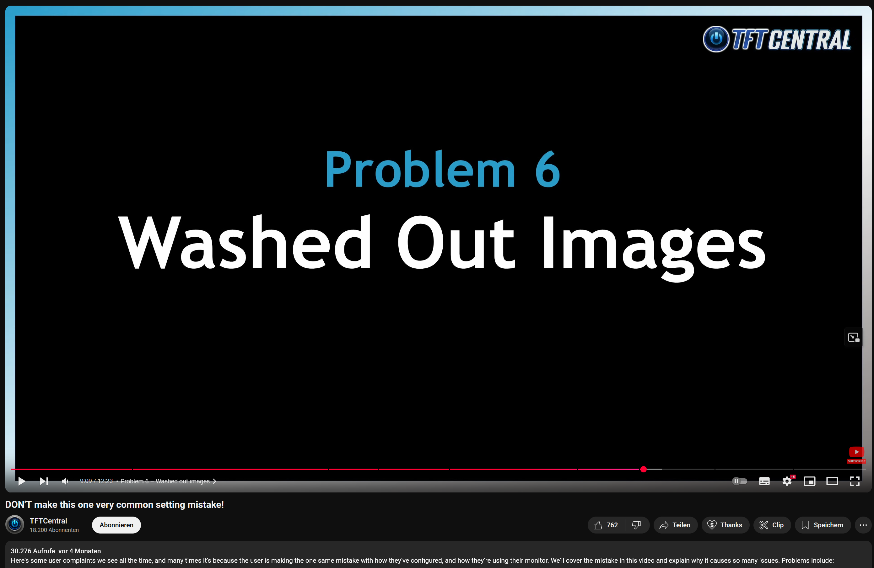

Und für die Lese faulen der Artikel in Video Form :

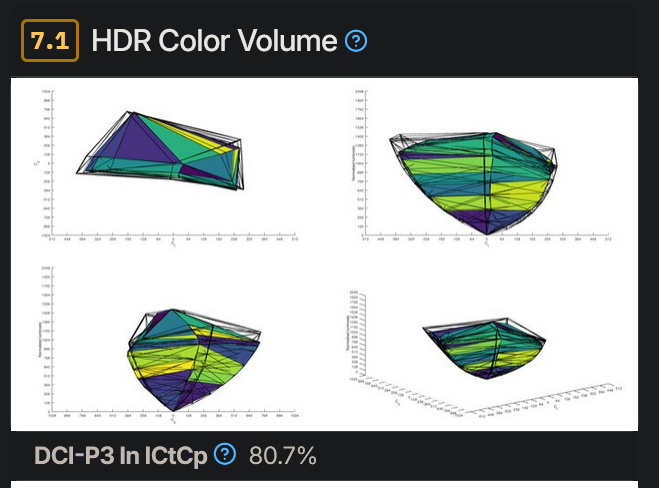

Ich kann das mit HDR = ausgewaschen nicht nachvollziehen. Bei mir sehen Farben usw. im HDR-Modus genauso wie im SDR-Modus aus (Monitor mit "GSync Aultimate", HDR1000, Werks-Kalibrierung, usw.). Den einzigen Unterschied nehme ich bei Videos wahr, weil dort dunkle Bereiche im HDR-Modus noch dunkler dargestellt werden.
Was ich mich eher frage: Nutzt ihr bei SDR wirklich den echten SDR-Modus, also sRGB? Im unendlich großen Post über mir von "Stagefire" wird es schon in einem Bild angezeigt: ~126 % sRGB Coverage im SDR-Modus. Das nennt man auch Wide-Garmut.
Windows konnte bis vor 6-9 Monaten (vor der Einführung von "Auto Color Management" [ACM]) nicht mit Wide-Garmut umgehen (im Gegensatz zu z.B. MacOS) und hatte alle Farben immer übersättigt dargestellt.
Im HDR-Modus sind es im Bild vom Post von "Stagefire" nur noch 97,6 % sRGB Coverage. Man ist damit viel näher am sRGB-Ideal dran und Farben sehen nahezu so aus, wie sie aussehen sollten. Aber das bedeutet auch keine übersättigte Farben mehr.
Ist es das, was mit ausgewaschenen Farben gemeint ist? Die Betroffenen haben sich einfach nur an die übersättigten Farben gewöhnt?
Mich würde da interessieren, wie die Betroffenen die Farben mit aktiviertem "Auto Color Management" empfinden? (Windows-Einstellungen -> System -> Bildschirm -> Farbprofil -> "Farbe für Apps automatisch verwalten")
Oder wie sind die Farben, wenn im Monitor-OSD der Modus "sRGB" eingestellt wird?
Oder wie sind die Farben im Falle einer Nvidia-Grafikkarte, wenn das Tool "novideo_srgb" verwendet wird? (Beim angezeigten Monitor das "Clamped"-Häkchen setzen.)
Sind die Farben dann auch im SDR-Modus "ausgewaschen"?

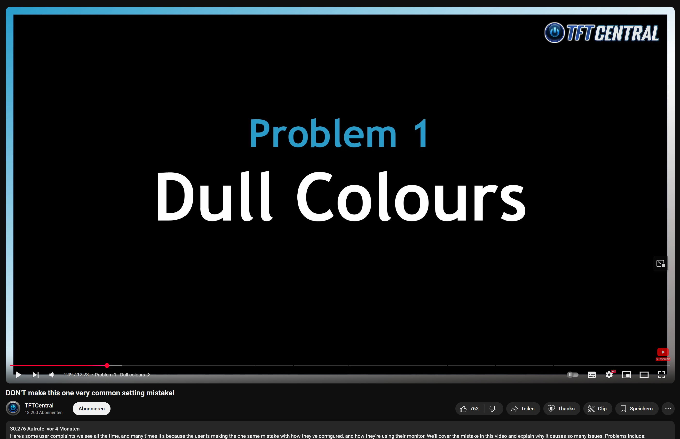

Dann hast den Artikel leider nich gelesen den ich verlinkte und auszüge von postete
denn hättest du es getahn könntest du es nun nachvollziehen
Und ein weiteres mal :

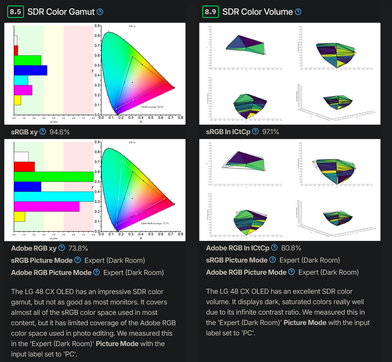

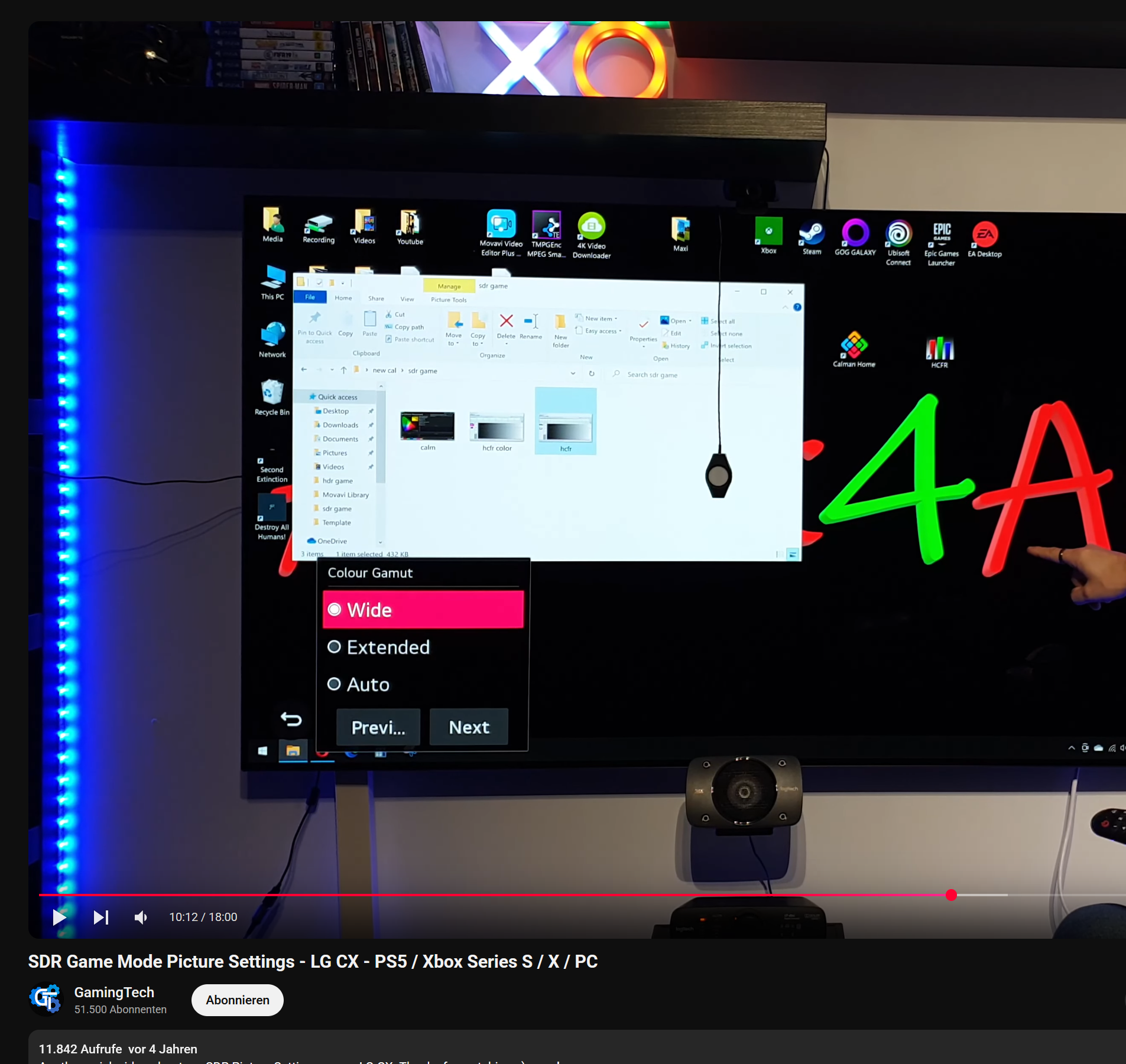

Ja

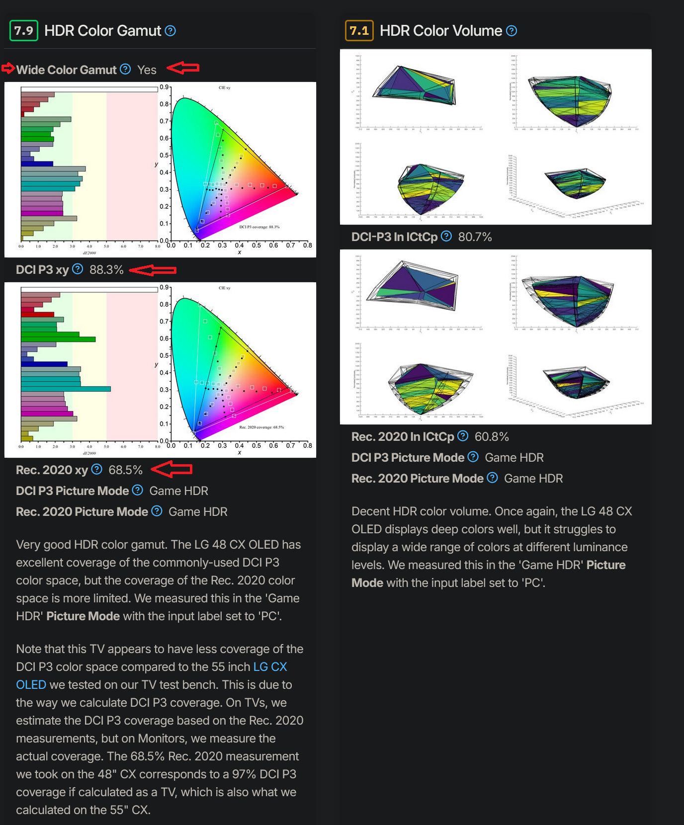

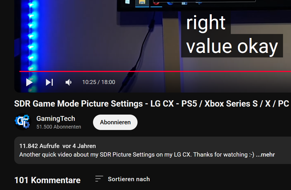

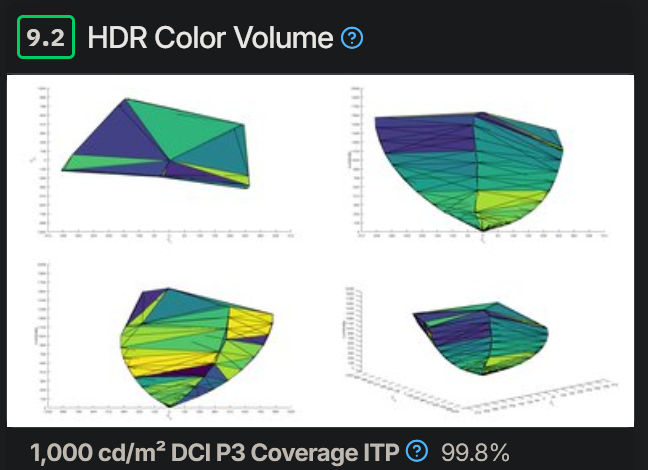

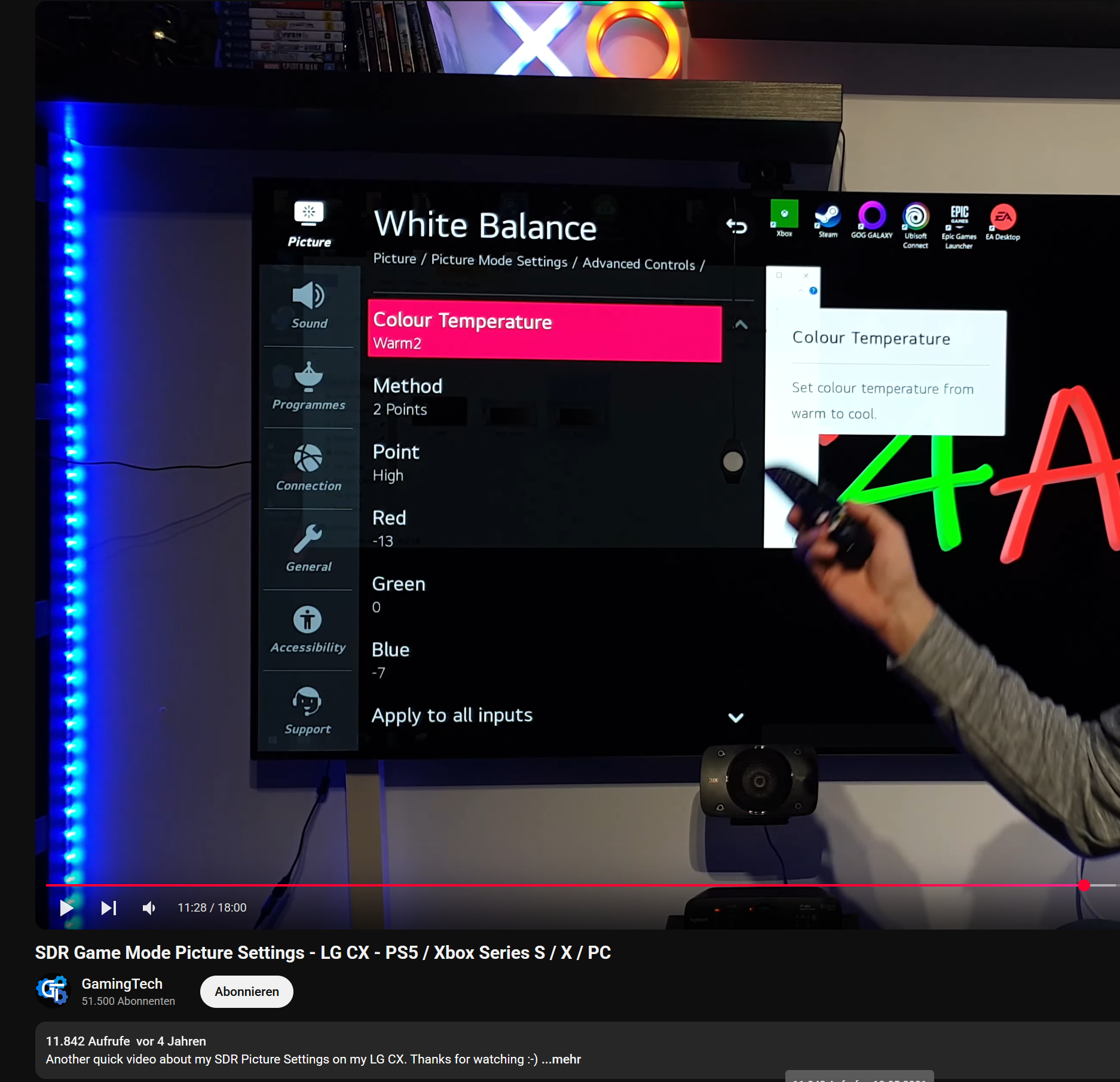

Mein 2020er LG 48" CX OLED TV den ich seit Juni 2020 als PC Monitor nutze :
https://www.rtings.com/monitor/reviews/lg/48-cx-oled

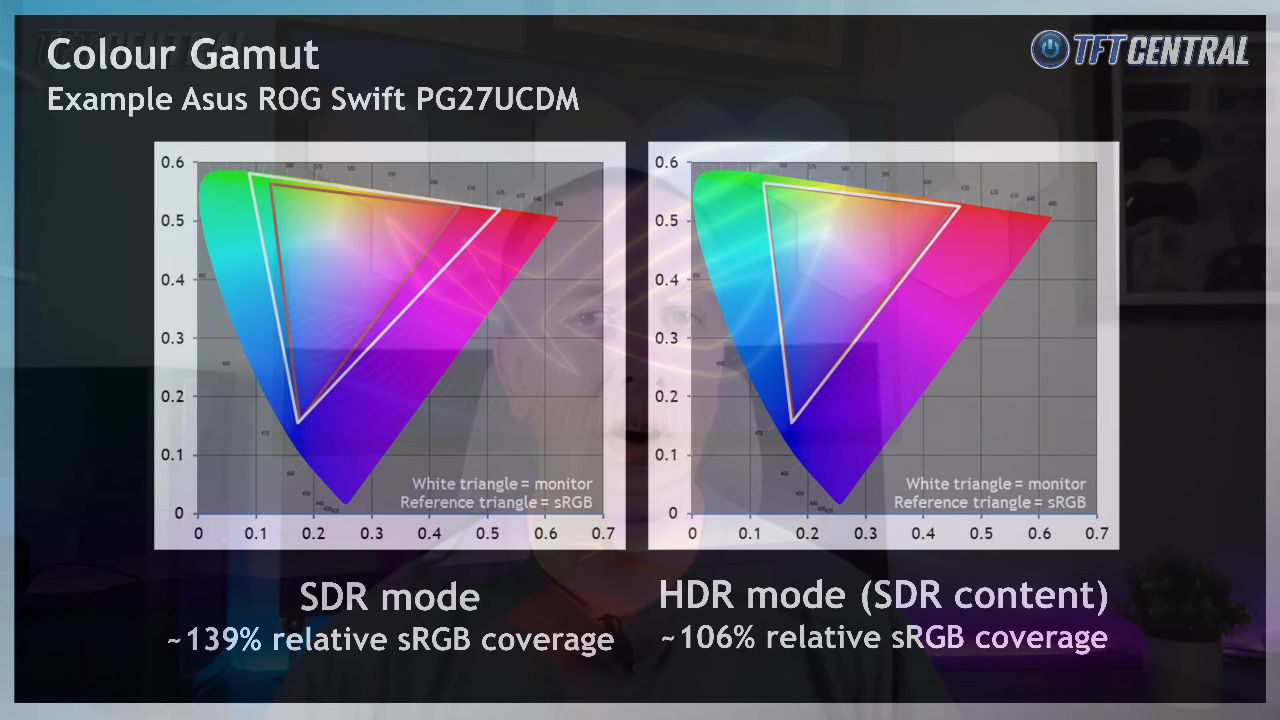

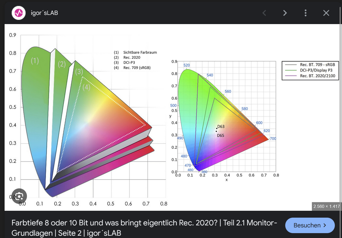

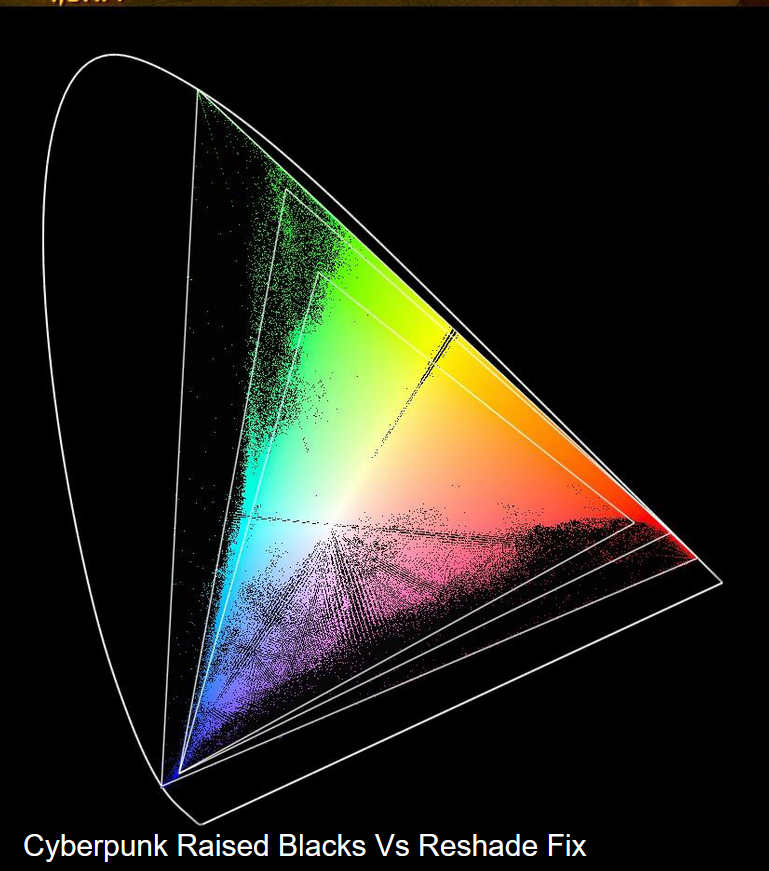

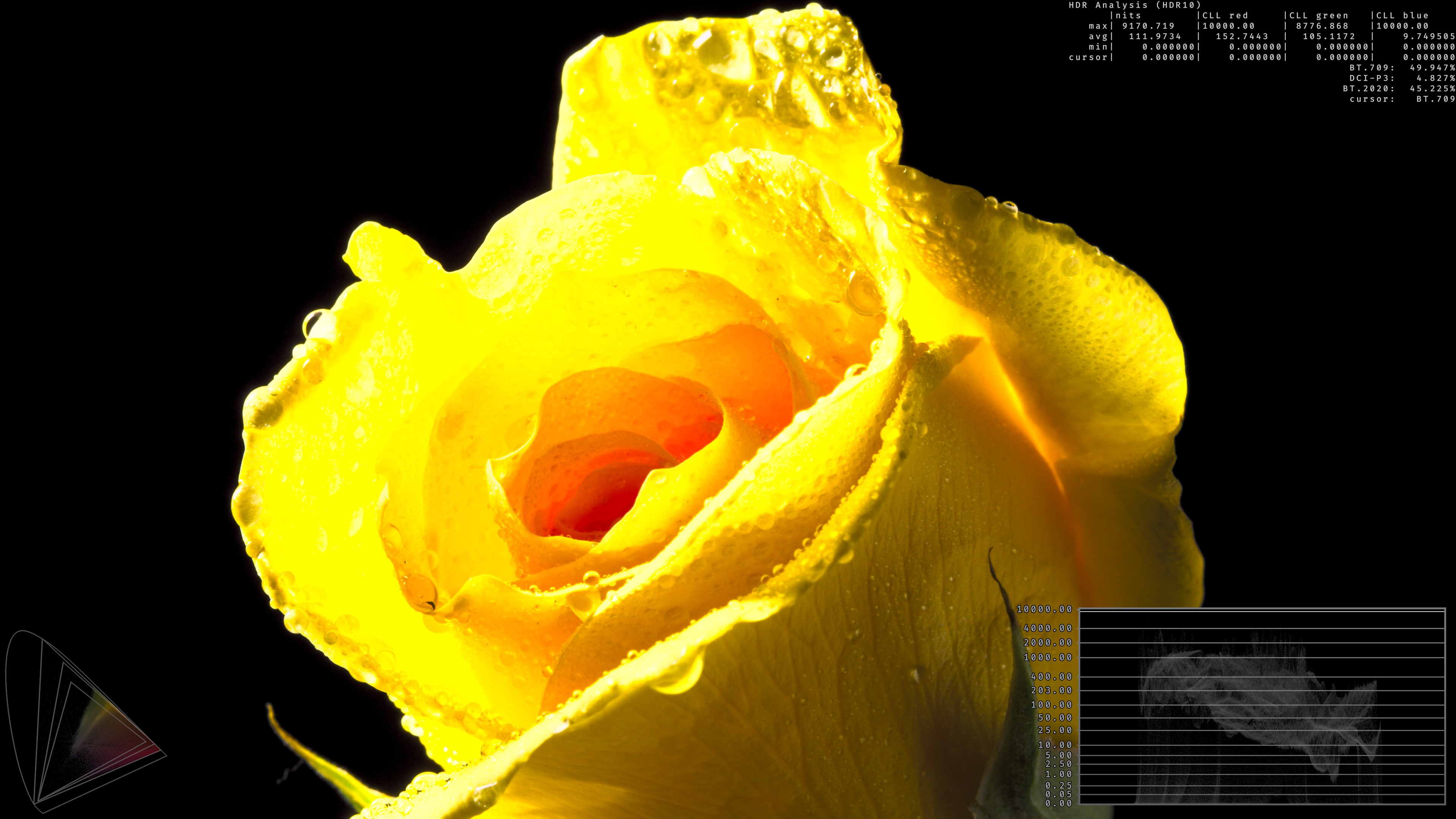

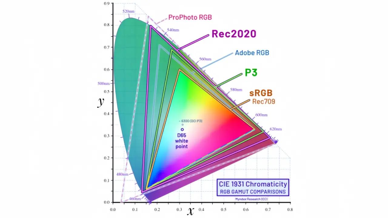

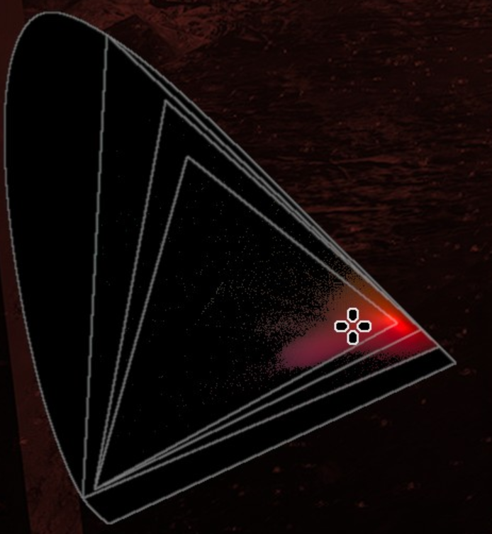

Wide Gamut is zb der 10 Bit HDR DCI-P3 und 10 Bit HDR BT / REC 2020 Farbraum und eben nich mehr der 8 Bit SDR sRGB Farbraum ... also die 26 % von den 126 % reichen dann schon in den nächst höheren Farbraum rein und überschreitet eben den sRGB Farbraum.

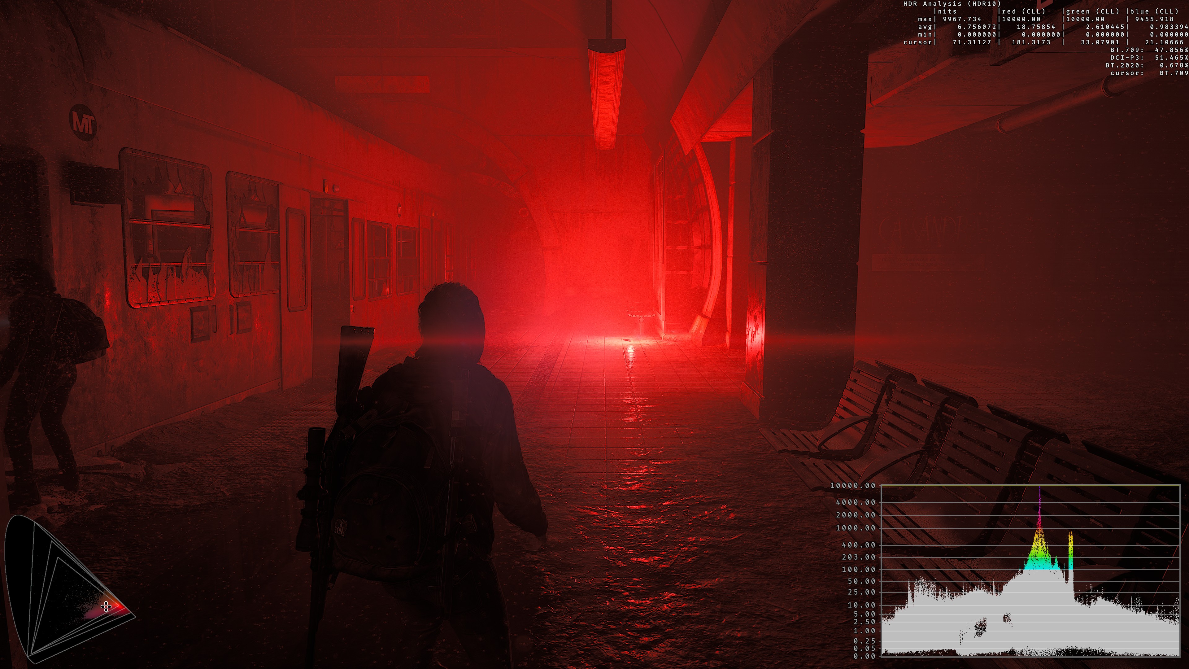

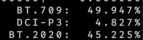

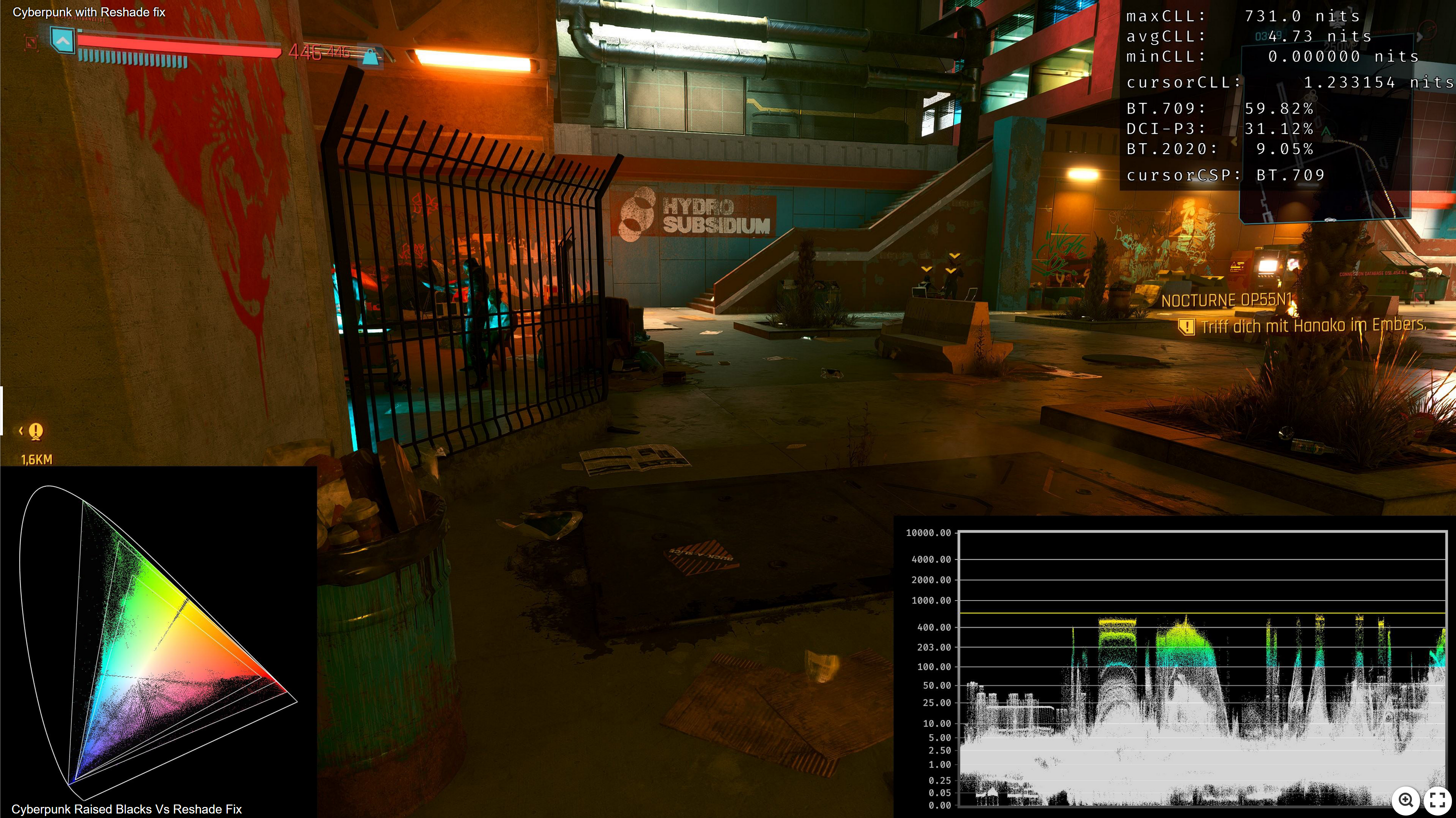

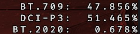

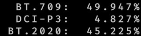

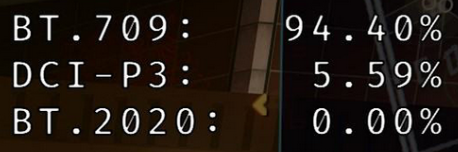

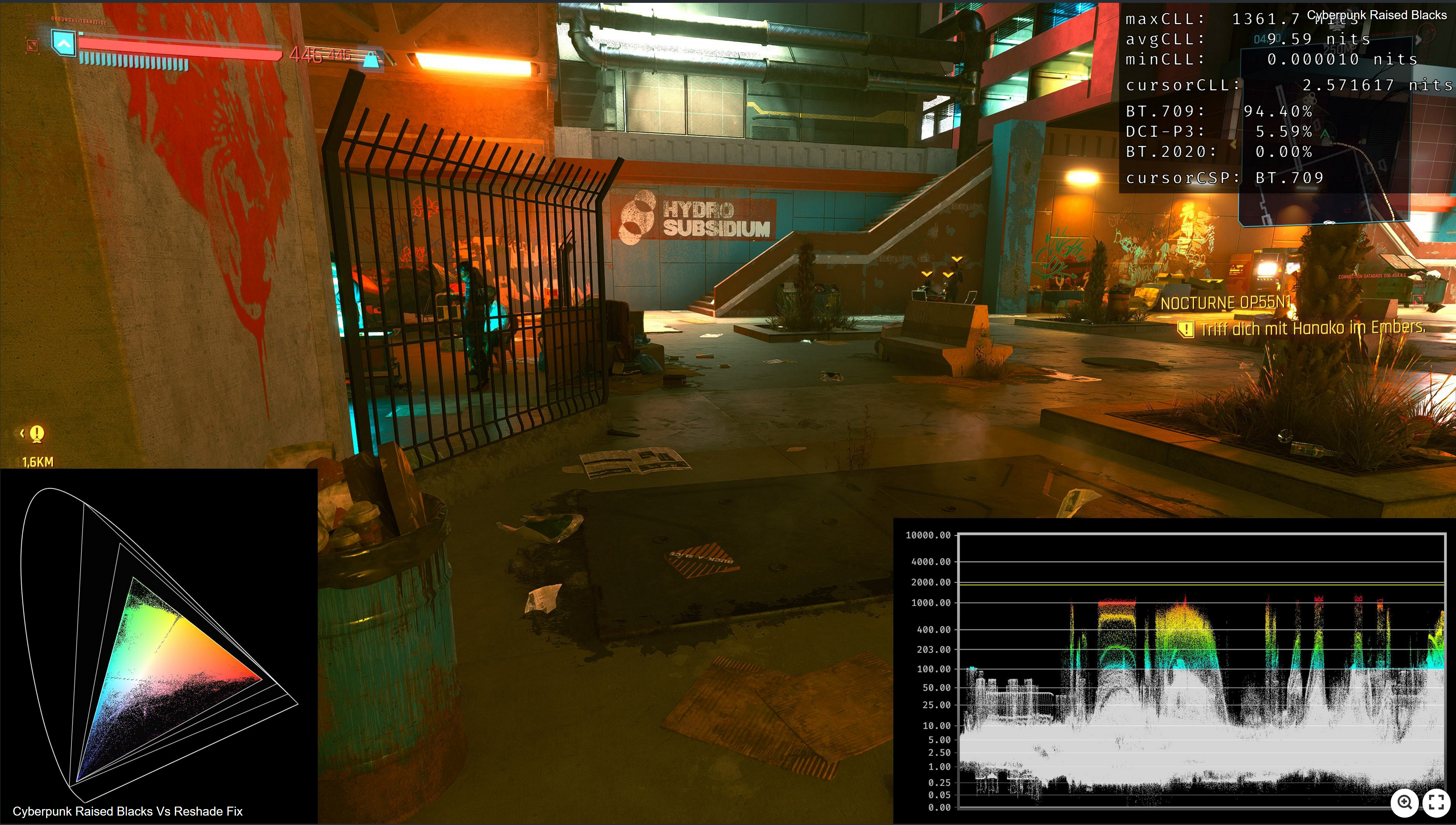

Is auch bei HDR Games der Fall .. es gibt in HDR auch nich nur 0 % und 100 % sondern
ein HDR Game Kann halt zb zu 70 % im 8 Bit SDR sRGB / REC 709 Farbraum sein und zu
25 % im 10 Bit DCI-P3 HDR Farbraum und zu 5 % im 10 Bit BT / REC 2020 je nach dem halt
was grade auf dem Bild angezeigt wird und wie gut die HDR Implimentierung in dem Game is

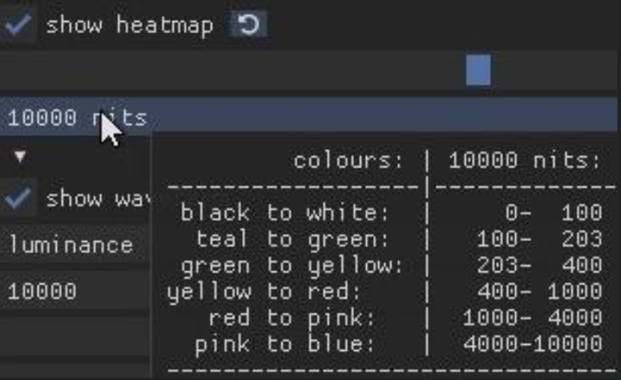

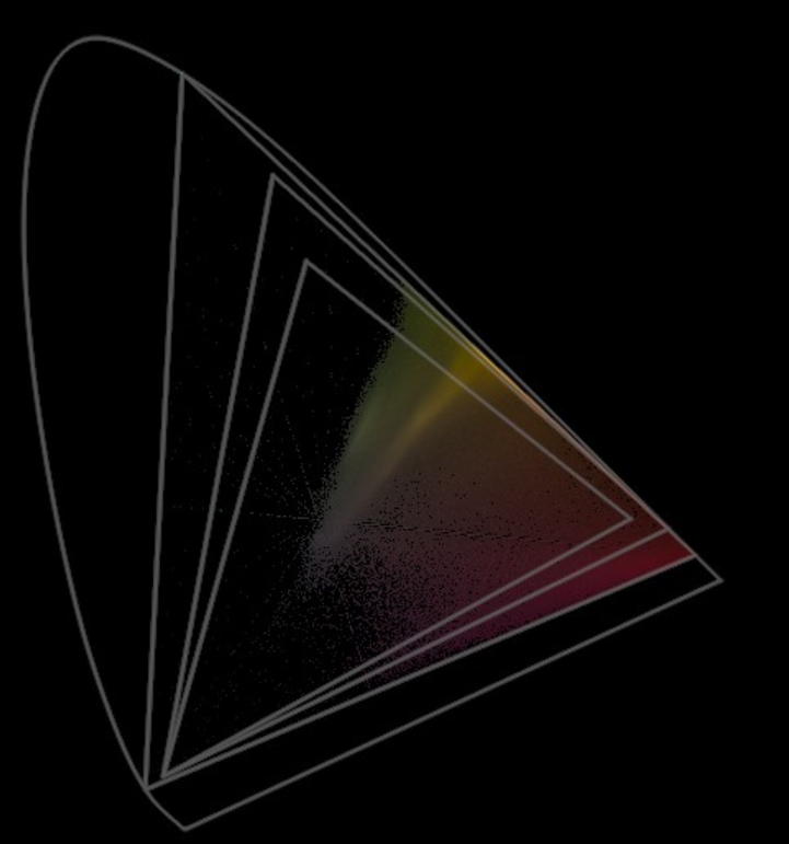

Beispiel :

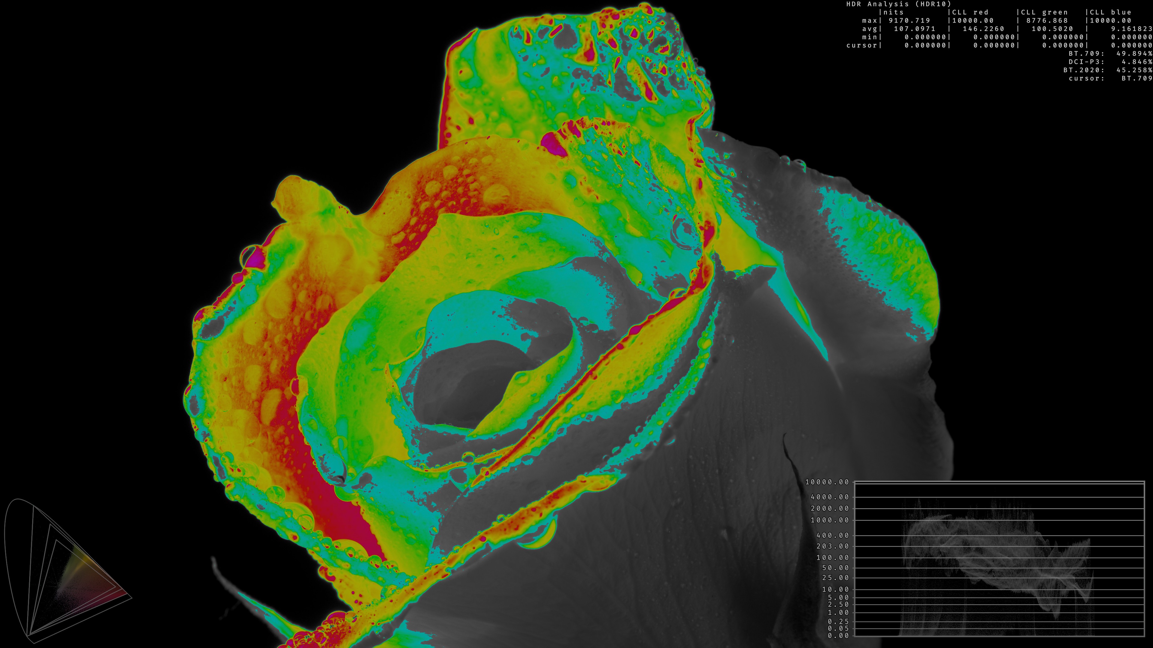

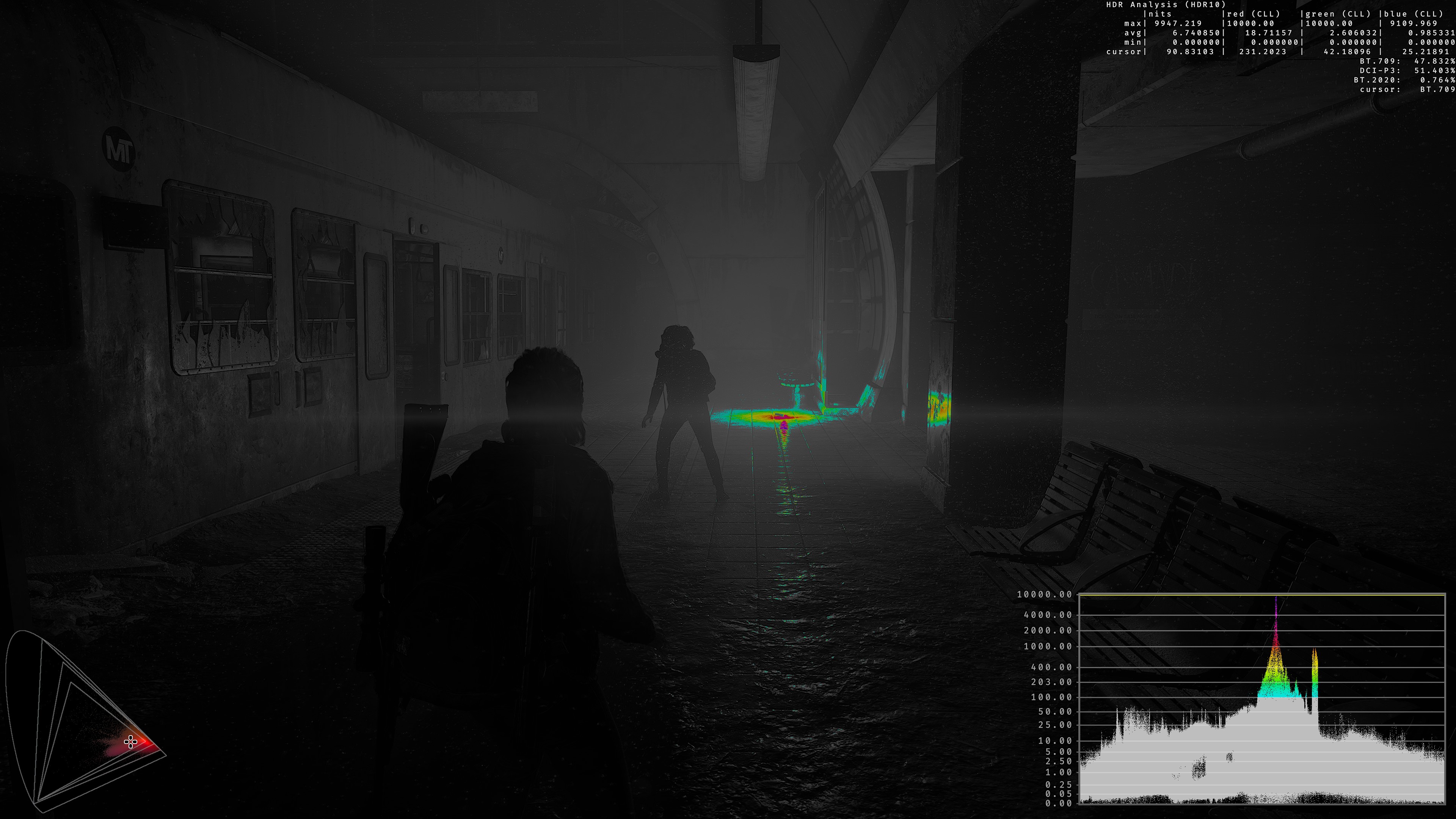

Als Bonus die Heatmap :
Bonus die Heatmap :
Das eine ist was das Gerät kann und das andere was der Content eigentlich vom Gerät fordert
und das variiert halt je nachdem was grade auf dem Bild zu sehen ist und was eben der Content
dafür fordert

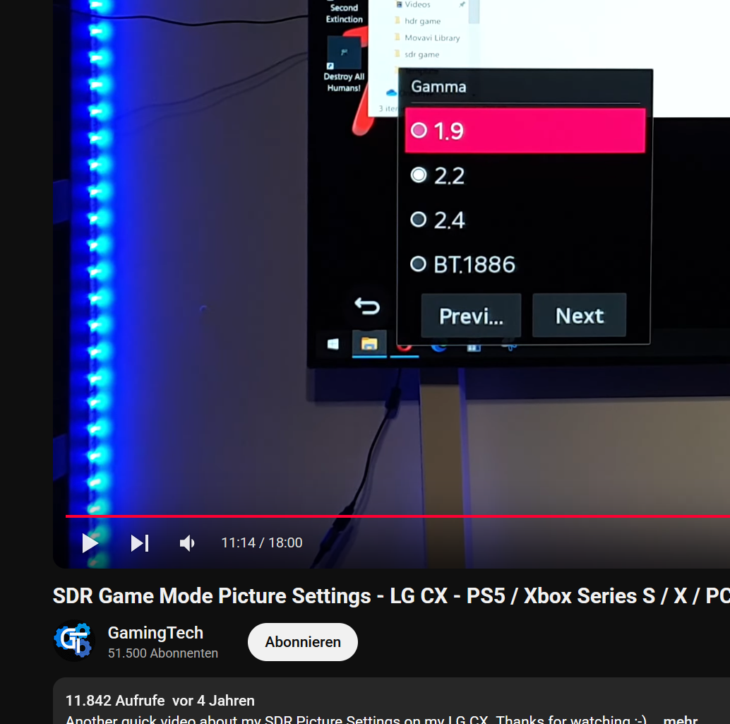

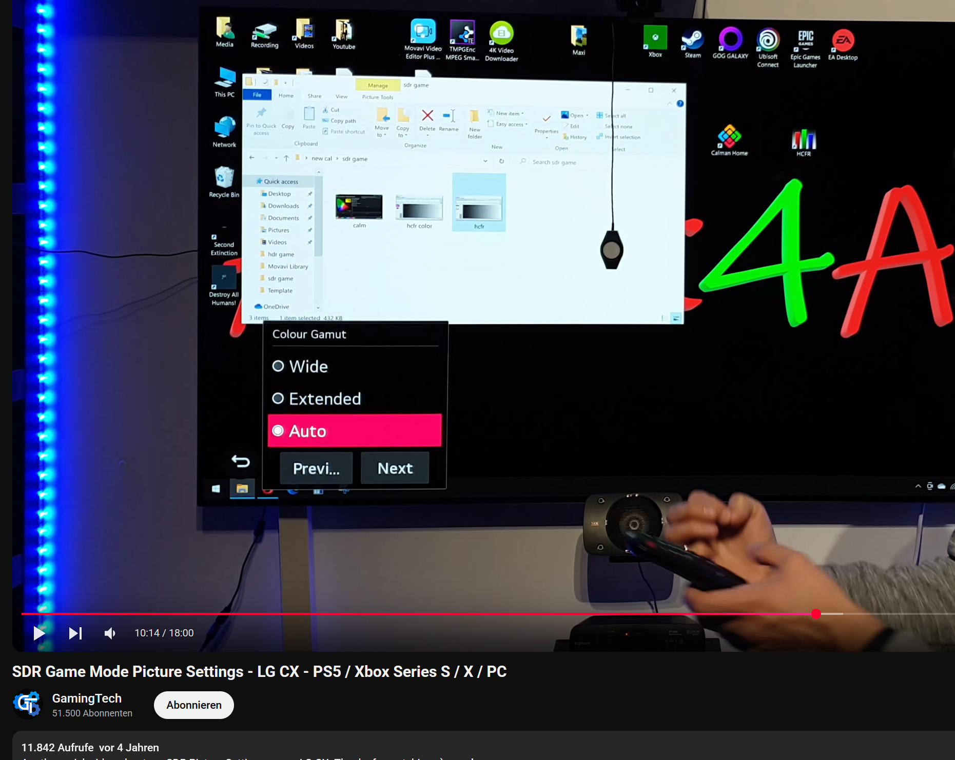

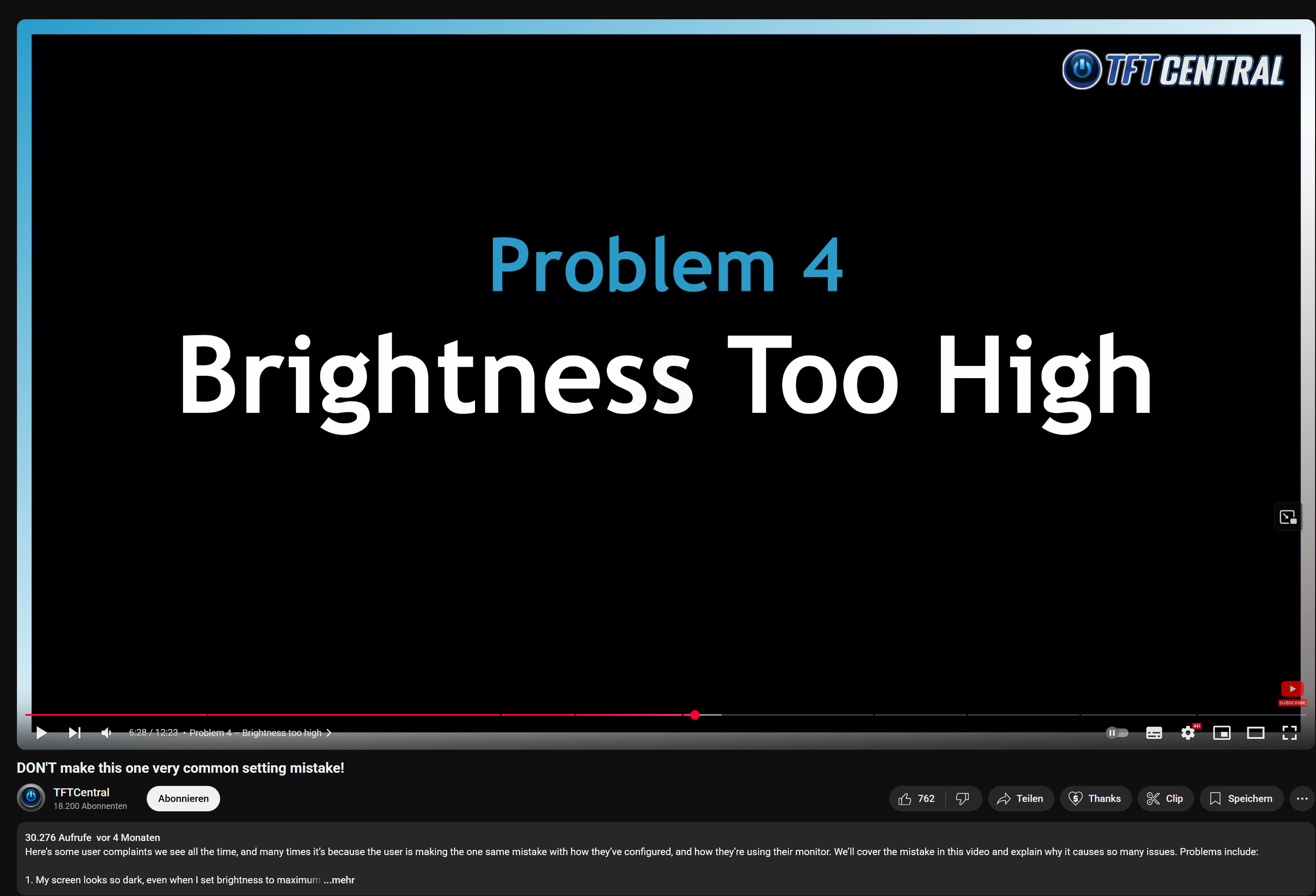

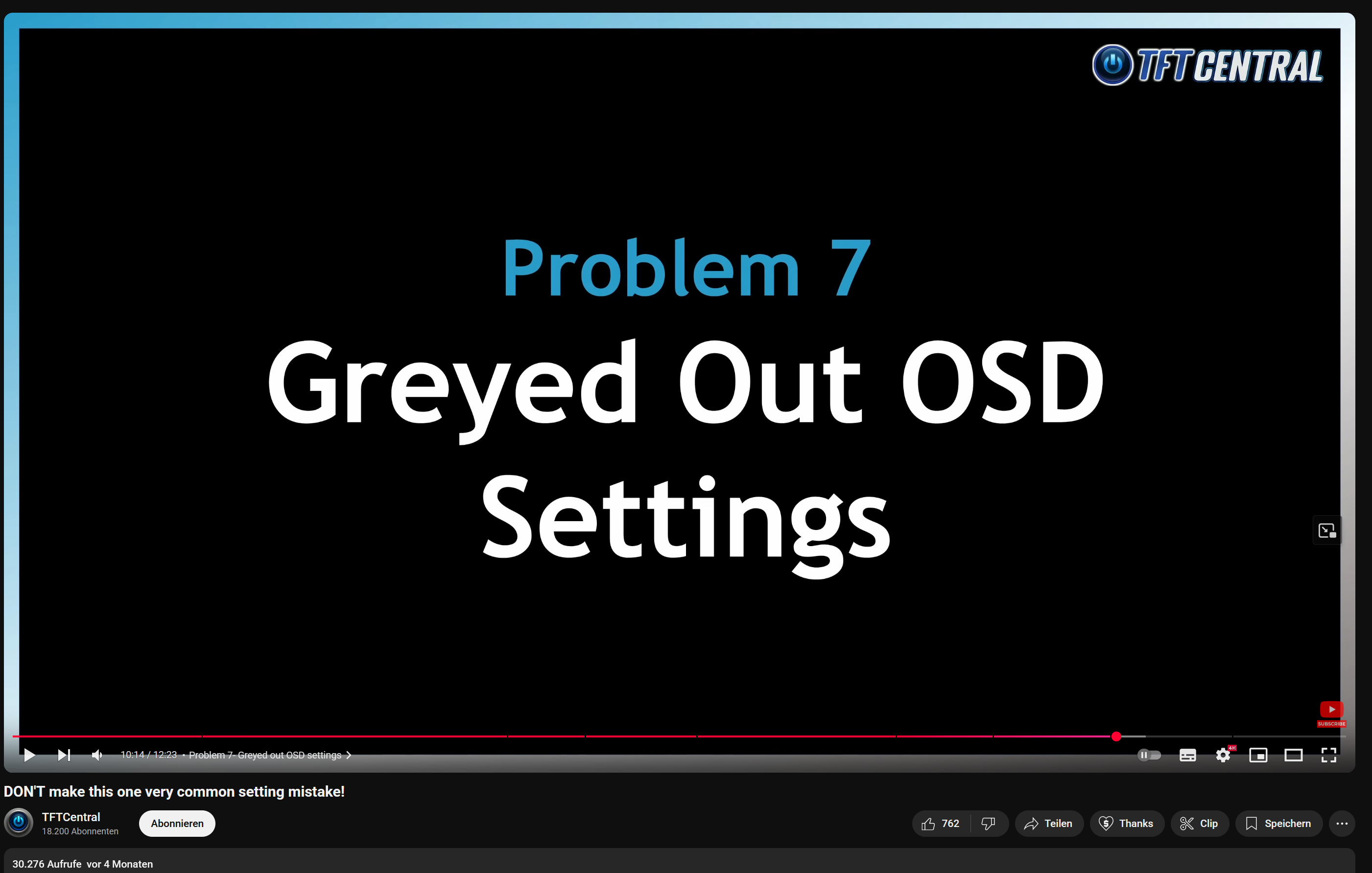

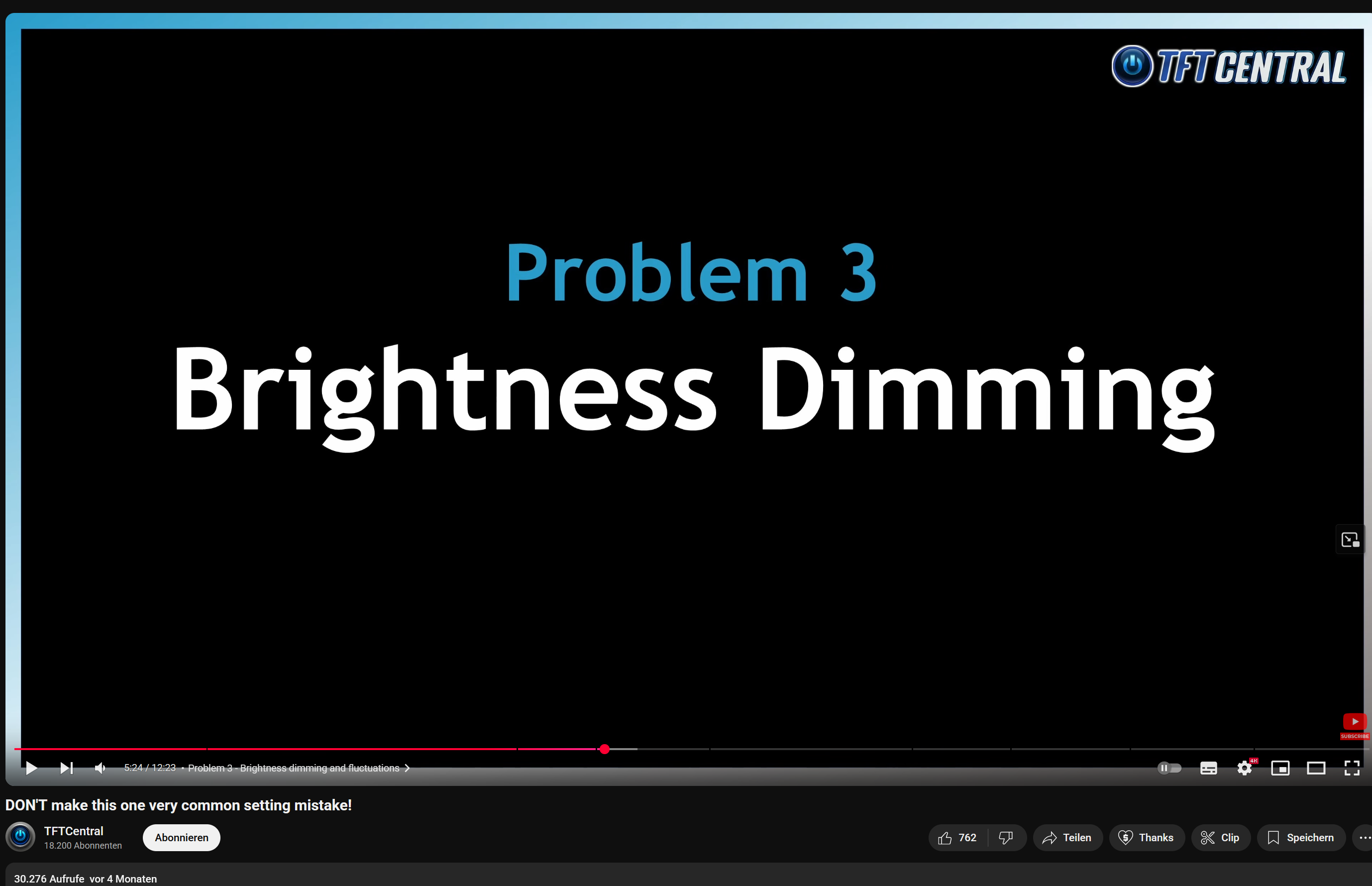

Je nachdem wie dein Anzeigegerät mit SDR im HDR Mode umgeht is das Problem ein anderes
daher listet eben zb TFTCentral im Video ( das ich ja auch verlinkt hatte )
weitere Probs auf die dann entstehen können :
---------------------------------------------------------- das Prob hat mein LG OLED TV zb
Je nachdem wie eben dein Monitor mit SDR Content im HDR Mode umgeht hat man eben entweder
das eine Prob oder das andere oder mehrere zusammen

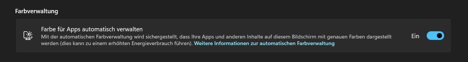

Das musste ich ausmachen da ich sonst mit der Kombo
das HDR nich mehr aktivieren konnte

Danke für die Info .. bei mir klappt die Kombi zum glück sofern ich eben das aushab :
Is das aber an geht die Kombi halt nich .. aber da ich dieses Auto Farbe Gedöns da nich brauch schalte ich das aus damit ich halt die Kombi
wieder nutzen kann

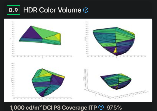

Hallo
Das geht mir genauso, mein Desktop sieht bei meinem DisplayHDR 1000 Monitor unter HDR genau so aus wie unter SDR.
Natürlich mache ich das nicht, solange ich kein HDR Material sehe bleibe ich bei SDR, ich habe es aber ausführlich getestet.
Ich habe nur die Windows HDR Kalibrierung gemacht und die SDR Helligkeit in den Windows HDR Einstellungen angepasst.
Mit meinem vorherigen 200€ Monitor mit Placebo HDR hatte ich auch HDR Probleme, Finger weg von HDR 400 Monitoren.
Mit meinem aktuellen DisplayHDR 1000 MiniLED habe ich auch bei Dolby Vision Videos keinerlei Probleme mit den Farben.
Ich mußte bei Dolby Vision aber einiges testen bis ich es hinbekommen habe (MPC-BE + MPCVideoRenderer + LAVFilters).
Für Dolby Vision (Profile 5) mußte ich beim MPC-BE den MPCVideoRenderer und für richtige Farben den LAVFilters nehmen.
Das ist eben falsch bzw. nicht ganz korrekt. Ja, der erweiterte Farbraum wird für DCI-P3 benötigt, aber er wird auch bei SDR verwendet. Windows bzw. der Grafiktreiber sagt einfach nur: Zeige mit das stärkste Rot an, also Stufe 255. Der Monitor, der standardmäßig im Wide-Garmut-Modus läuft, wird dann nicht das 255er Rot vom sRGB-Farbraum anzeigen, sondern das maximale Rot vom DCI-P3-Farbraum. Und daraus entsteht dann ein übersättigtes Rot.
Ich habe mir auch mal das von dir verlinkte Video angeschaut:
Schon beim ersten Problem bestätigt er meine Aussage.
Hier die übersetzte Transkription vom gesamten Abschnitt "Problem 1: Dull Colors":
Wenn Windows versucht, eine SDR-Anwendung oder Ihren Windows-Desktop im HDR-Modus anzuzeigen, ändert es tatsächlich die Art und Weise, wie Farben dargestellt werden. Windows begrenzt den Farbraum des Panels auf das sRGB-Farbspektrum, da dies der Ziel-Farbraum für SDR-Inhalte ist. Deshalb sieht der Windows-Desktop plötzlich weniger farbenfroh und weniger gesättigt aus als zuvor, was ein häufiger Grund ist, warum Menschen von stumpfen oder ausgewaschenen Farben berichten. Wenn Sie den Bildschirm zuvor ohne aktiviertes HDR verwendet haben oder ihn vielleicht mit einem anderen Wide-Gamut-Display verglichen haben, werden Sie fast sicher einen großen Rückgang der Farbintensität und -sättigung bemerken, wenn Sie den HDR-Modus in Windows aktivieren.
Zum Beispiel hier der Farbraum eines Bildschirms, den wir kürzlich überprüft haben, den Asus ROG Swift PG27UCDM.
Auf der linken Seite ist der Windows HDR-Modus deaktiviert und das volle native Farbspektrum des Panels ist aktiv. Wir haben eine relative Abdeckung von etwa 139 % des sRGB-Farbspektrums gemessen, was eine große Überdeckung in roten und grünen Farbtönen zeigt und zu einem lebendigeren, gesättigten und farbenfrohen Bild führt.
Auf demselben Bildschirm mit aktiviertem Windows HDR-Modus sehen Sie auf der rechten Seite, dass das Farbspektrum zurückgefahren wurde, um viel näher am sRGB zu liegen, was zu einer viel niedrigeren Abdeckung und weniger gesättigten Farben führt. Vielleicht möchten Sie diesen reduzierten Farbraum für diese Anwendungen, aber das ist der Grund, warum Farben stumpfer und ausgewaschener erscheinen.
Die sRGB-Coverage hatte ich auch in meinem 1. Post erwähnt.
Es gibt jedoch viele andere Gründe, warum die ständige Verwendung des HDR-Modus keine gute Idee ist, auf die wir gleich eingehen werden.
Obwohl diese Farbbegrenzung auftritt, wenn SDR-Anwendungen und -Inhalte im HDR-Modus angezeigt werden, wird beim Anzeigen von tatsächlichen HDR-Inhalten wieder der breitere, für diese Inhalte vorgesehenen Farbraum verwendet. Sie müssen sich also in diesen Situationen keine Sorgen um die Farben machen; sie werden farbenfroher und lebendiger aussehen, wenn das der Inhalt erfordert.
Nur wenn Sie normale SDR-Inhalte und -Anwendungen anzeigen, erhalten Sie diesen restriktiven und begrenzten Farbraum. Dies gilt auch für Nicht-HDR-Spiele, bei denen Benutzer möglicherweise die gesättigteren und lebendigeren Farben bevorzugen. Wenn Sie HDR in Windows aktivieren und dieses SDR-Spiel spielen, wird der Farbraum auf die gleiche Weise begrenzt und eingeschränkt, wie es bei SDR-Anwendungen und dem Windows-Desktop der Fall ist. Wenn Sie HDR deaktivieren, wird das volle native Farbspektrum des Panels verwendet, vorausgesetzt, das Panel hat überhaupt einen breiten Farbraum (Wide Garmut) und Sie schränken es nicht auf andere Weise von der Monitorseite aus ein, indem Sie einen der Emulationsmodi verwenden.
Vielleicht ist es dann kontraintuitiv, dass beim Spielen eines Nicht-HDR-Spiels der HDR-Modus in Windows zu stumpferen, eingeschränkten Farben führt, während der SDR-Modus in Windows in diesem Szenario gesättigtere und lebendigere Farben erzeugt. Der SDR-Modus wird nicht unbedingt wirklich genau sein, wenn das Spiel in SDR gemastert wurde und ein kleinerer Farbraum erforderlich ist, aber oft bevorzugen die Menschen das farbenfrohere Bild für diese Art von Anwendungen.
(Ende des Abschnitts "Problem 1: Dull Colors")
Damit hat er im Video genau das gesagt, was ich vermutet hatte. "Ihr" habt eure Augen & Gehirn einfach nur verdorben, weil ihr euch an die überdrehten Farben gewöhnt habt.
Das soll jetzt aber kein Vorwurf sein, weil wenn man sich bisher noch nie mit der Farbdarstellung in Windows beschäftigt hat, dann ist man sich des Problems nicht bewusst.
Ein weitere Faktor für ausgewaschene Farben ist der Abschnitt "Problem 6: Washed out images".
Da geht es um das Gamma und zeigt das, was ich auch erwähnt hatte, dass mir die Unterschiede
SDR-Modus <-> HDR-Modus nur in Videos besonders stark auffielen, weil dunkle Bereiche noch dunkler wurden und es zum sogenannten Black-Crush kam.
Das ist tatsächlich auch für mich der Grund, warum ich dauerhaft den SDR-Modus nutze. Aber mit aktiviertem ACM, weil so sRGB-Farben im SDR-Modus verwendet werden und nicht die Wide-Garmut-Farben.
Ich könnte die Farben auch per Monitor-OSD begrenzen, aber vielleicht bringt das ACM ja auch Vorteile....keine Ahnung.
Auf die anderen Probleme im Video (die es sicherlich auch gibt) gehe ich jetzt nicht ein, weil es hier im Thread um blasse / ausgewaschene Farben geht.
Sofern das Gerät eben das Maximale Rot vom DCI Farbraum darstellen kann da es dann natürlich darauf ankommt wie die Abdeckung des DCI Farbraums des Gerätes ist .... aber es kommt auch darauf an ob der
Content dann eben wirklich verlangt ob er dieses Rot dann haben will oder nich ein etwas dunkleres Rot usw.
Dat is nun kein SDR Material sondern HDR Material aber es geht mir da grad darum zu zeigen
das der Content fordert und es eben nich nur 0 und 100 gibt
Ein paar alte HDR Raised Blacks Fix Bilder von mir noch mit der alten HDR Analyse Version
Je nach Content bzw was eben grad zu sehen ist ändert sich halt die Anfrage bzgl Farben da gibts wie schonmal gesagt nicht nur 0 und 100 bzw 0 und 255 ... sondern eben auch 50 oder 99 usw je nach dem was der Content halt vorgibt... das bringt aber halt auch nur was wenn dann das Gerät dann auch im Stande ist
diesen Bereich in geforderten Maße abzudecken
Mein alter 2020er LG CX OLED TV Hobel deckt den DCI Bereich zb nur zu 80 - 88 % ab die neueren OLEDs
schaffen da natürlich schon mehr richtung 100 % abdeckung
2020er LG CX OLED TV : --------------------------------------- 2025er LG G5 OLED TV
2025er Samsung S95F QD-OLED TV :
Bei mir stehts auf Auto in SDR aber auch in HDR
damit der TV selbst entscheiden kann wann er welchen Farbraum nutzt
Da sieht man den unterschied relativ gut auch zb bei den Icons aber eben bei der 4 und dem A worauf er zeigt

Bei Gamma nutzt ich bei SDR aber BT 1886 ( Bei HDR dann Gama 2.2 mit Warm 1 und manchmal auch Warm 2 )
