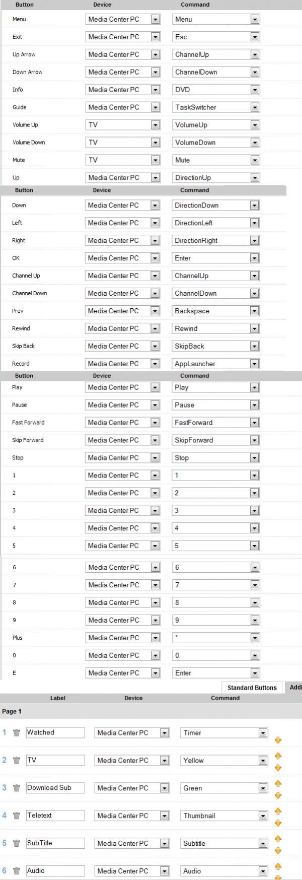

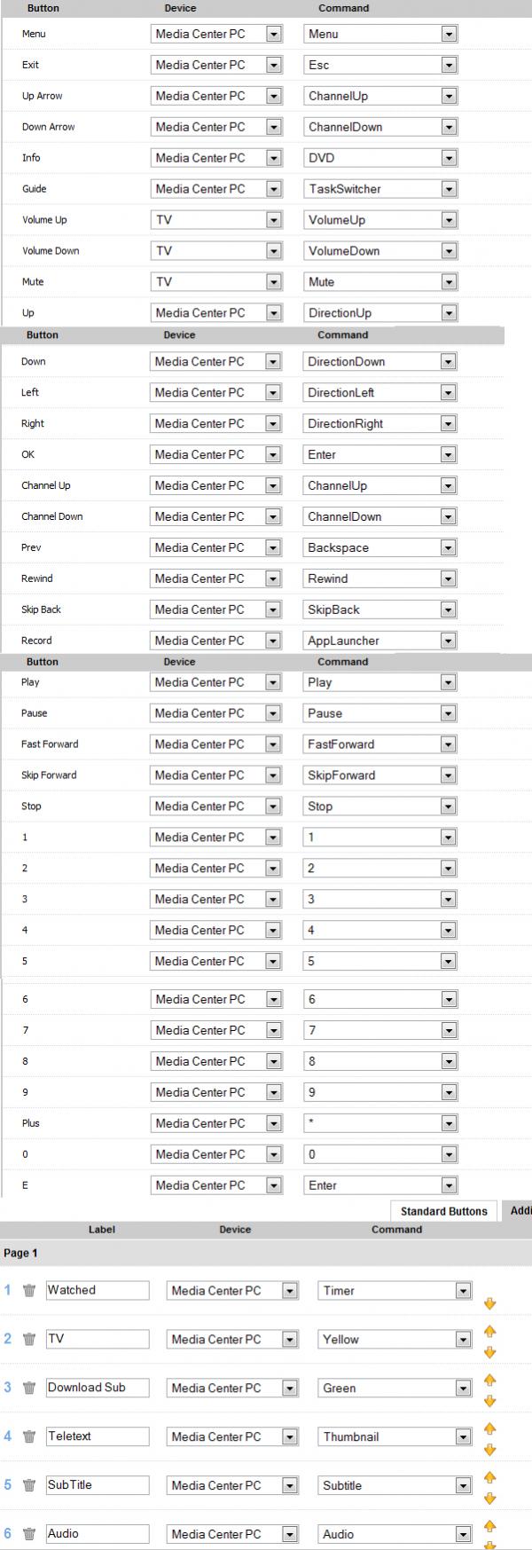

so, also hier erstmal die Files:
Lircmap.xml
Code:
<!-- This file contains the mapping of LIRC keys to XBMC keys used in Keymap.xml -->
<!-- How to add remotes -->
<!-- <remote device="name_Lirc_calls_the_remote"> -->
<!-- For the commands the layout following layout is used -->
<!-- <XBMC_COMMAND>LircButtonName</XBMC_COMMAND> -->
<!-- For a list of XBMC_COMMAND's check out the <remote> sections of keymap.xml -->
<lircmap>
<remote device="linux-input-layer">
<altname>cx23885_remote</altname>
<altname>devinput</altname>
<left>KEY_LEFT</left>
<right>KEY_RIGHT</right>
<up>KEY_UP</up>
<down>KEY_DOWN</down>
<select>KEY_ENTER</select>
<start>KEY_SELECT</start>
<back>KEY_ESC</back>
<green>KEY_EXIT</green>
<back>KEY_BACKSPACE</back>
<back>KEY_CLOSE</back>
<record>KEY_RECORD</record>
<play>KEY_PLAY</play>
<play>KEY_PLAYPAUSE</play>
<pause>KEY_PAUSE</pause>
<stop>KEY_STOP</stop>
<forward>KEY_FASTFORWARD</forward>
<reverse>KEY_REWIND</reverse>
<volumeplus>KEY_VOLUMEUP</volumeplus>
<volumeminus>KEY_VOLUMEDOWN</volumeminus>
<channelplus>KEY_CHANNELUP</channelplus>
<channelminus>KEY_CHANNELDOWN</channelminus>
<skipplus>KEY_NEXT</skipplus>
<skipminus>KEY_PREVIOUS</skipminus>
<title>KEY_TEXT</title>
<subtitle>KEY_SUBTITLE</subtitle>
<language>KEY_LANGUAGE</language>
<power>KEY_POWER</power>
<myvideo>KEY_VIDEO</myvideo>
<green>KEY_AUDIO</green>
<mypictures>KEY_MHP</mypictures>
<mytv>KEY_TV</mytv>
<one>KEY_NUMERIC_1</one>
<two>KEY_NUMERIC_2</two>
<three>KEY_NUMERIC_3</three>
<four>KEY_NUMERIC_4</four>
<five>KEY_NUMERIC_5</five>
<six>KEY_NUMERIC_6</six>
<seven>KEY_NUMERIC_7</seven>
<eight>KEY_NUMERIC_8</eight>
<nine>KEY_NUMERIC_9</nine>
<zero>KEY_NUMERIC_0</zero>
<yellow>KEY_YELLOW</yellow>
<blue>KEY_BLUE</blue>
<menu>KEY_MENU</menu>
<info>KEY_DVD</info>
<start>KEY_HOME</start>
<display>KEY_ANGLE</display>
<teletext>KEY_CAMERA</teletext>
<red>KEY_TIME</red>
<epgsearch>KEY_CYCLEWINDOWS</epgsearch>
</remote>
</lircmap>

und hier die zugeordneten Buttons:

Abgesehen davon brauche ich wohl auch bald mal wieder Hilfe. Das Problem mit der TV-Karte die nach einem Standby nicht mehr erkannt wird habe ich inzwischen aufgegeben - dafür gibts jetzt Probleme mit meiner neuen Logitech Harmony, dem iMon IR-Empfänger, lirc und dem Mapping in XBMC...
Ich hatte die IR-Codes schon manuell eingelesen und eine config für lirc gemacht, allerdings scheint XBMC die Befehle nicht richtig zuzuweisen...
Ich probiere das ganze noch einmal mit einem neu aufgesetzten System sobald XBMC 12.0 final fertig released wurde. Das Problem ist, dass die Keyboard.xml / Lircmap.xml wohl überhaupt keinen Effekt haben.
Sollte ich es nicht selbst schaffen, poste ich noch die Dateien + Logs, bis dahin: Irgend welche "üblichen verdächtigen"?
