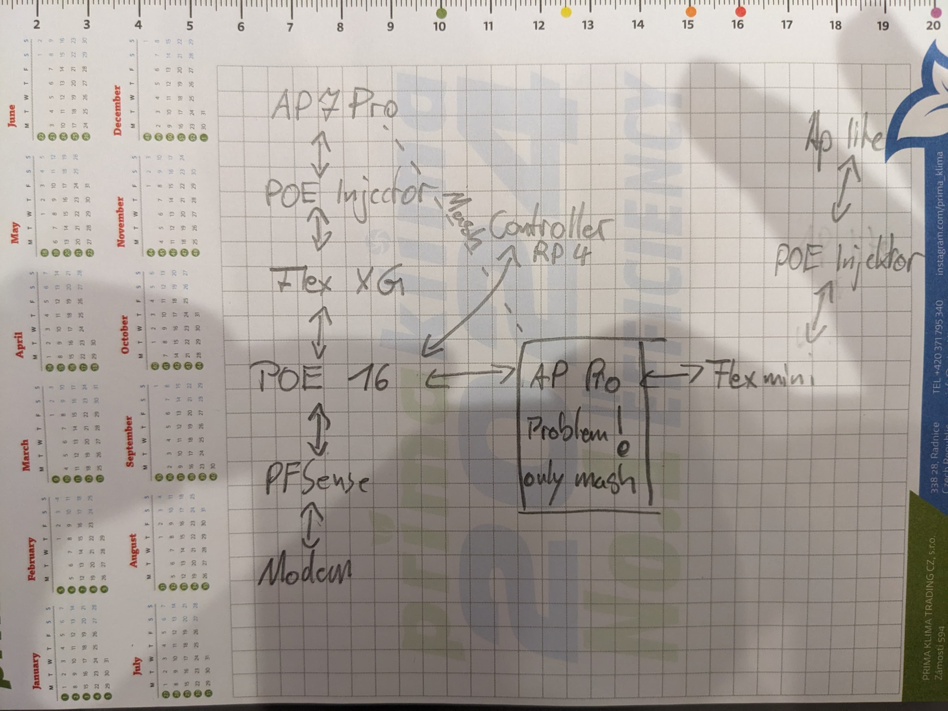

  1. I got rid of my USG and replace it with a m720Q PfSense build. No problems so far.
  2. I moved alle Unify devices to a different managment VLAN. Unnecessary nerve-racking process but did it after some trial and error. Everything can talk to everything for now rule wise, so no vlan roadblocks. Which is tested and works.
So far, not so good. I can manage to adpot all my devices and everything works but one AP refuses to use the wired instead of a Mash connection. All of the rest is working perfectly fine.
Here is a map of the relevant part of the network:
So the AP Pro in the middle is the one who causes trouble as it only connects via Mash. But it's a POE device with a perfectly fine cable so no way there is a hardware failure as it worked perfectly before. (-> as I am writing this, I will check another cable just to be safe).
Disabling Mash was not possible as long as a device using it was connected. Stupid! Let me decide even if I lock myself out. So I had to remove (reset) the AP Pro. After that I could disable Mash on every AP (as I generally do not need it). No luck, still adopts as Mash afterwards.
Then I did it all again. Now additionally disabling Mash globally. Adpotion process fails. No connection at all. But it is visible in the controller.
Now I did reset all APs. With the result of none of them showing up to readopt anymore. I guess due to the controller being on a different Vlan. Which was no issue before but who knows its unifi witchcraft.
So before I move all relevant devices and the controller (the stuff shown above) back to the default network just to start the process again. Which is needed as its really sensible parenthood wise. But now I want to know what I did wrong and how to fix it. Keeping the one AP in Mash would not be a problem in general but there is another switch and another AP behind it which is unconvinient.
Any help would be much appreciated!
