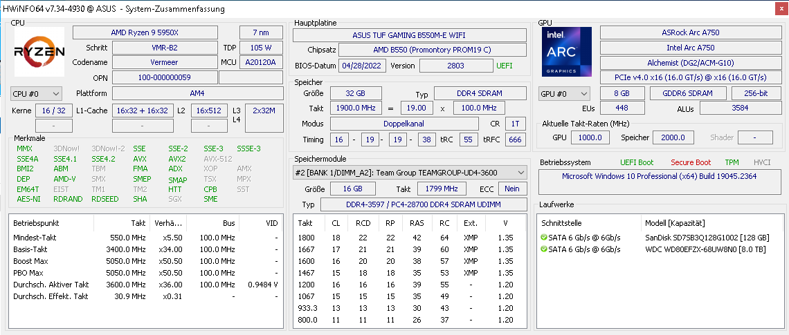

CPU: AMD Ryzen 9 5950X
Board: ASUS TUF GAMING B550M-E WIFI
Ram: 2* 16 GB PC4-28700 DDR4 SDRAM Team Group TEAMGROUP-UD4-3600
SSD: SanDisk SD7SB3Q128G1002 (SATA)
HDD: WDC WD80EFZX-68UW8N0 (SATA)
GFX: Asrock Arc A750
