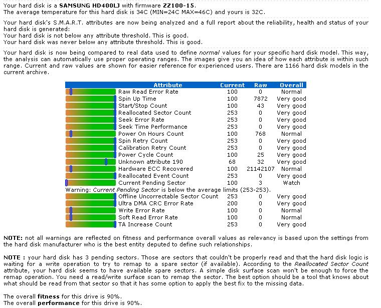

Hi, meine relativ neue (1-2 Monate alt) Samsung 400GB Festplatte klackert wenn man auf einen Ordner mit Files zugreifen will und der Explorer stürzt dann ab.
Bin jetzt nicht ganz sicher ob ich sie einschicken soll, nachher sagen sie es wäre nix und ich bleib noch auf den Kosten sitzen.
Die SMART Festplattenanalyse von SpeedFan sagt was von 3 pending sectors:
Current Pending Sector 100 3 Watch
Warning: Current Pending Sector is below the average limits (253-253).
NOTE : your hard disk has 3 pending sectors. Those are sectors that couldn't be properly read and that the hard disk logic is waiting for a write operation to try to remap to a spare sector (if available). According to the Reallocated Sector Count attribute, your hard disk seems to have available spare sectors. A simple disk surface scan won't be enough to force the remap operation. You need a read/write surface scan to remap the sector. The best option should be a tool that knows about what should be read from that sector so that it has some option to apply the best fix to the missing data.
Hier der Bericht von SpeedFan. Hab das nicht ganz verstanden wie man die sektoren wieder remappen kann. Ein Normales Checkdiks hat nix gebracht. Was meint Ihr dazu ?

Ausserdem sind die sektoren nicht unreparapel ausgeglieder:
"Offline uncerctable sector cont " ist 0"
und "NOTE : your hard disk has 3 pending sectors. Those are sectors that couldn't be properly read and that the hard disk logic is waiting for a write operation to try to remap to a spare sector (if available). According to the Reallocated Sector Count attribute, your hard disk seems to have available spare sectors. A simple disk surface scan won't be enough to force the remap operation. You need a read/write surface scan to remap the sector. The best option should be a tool that knows about what should be read from that sector so that it has some option to apply the best fix to the missing data. "

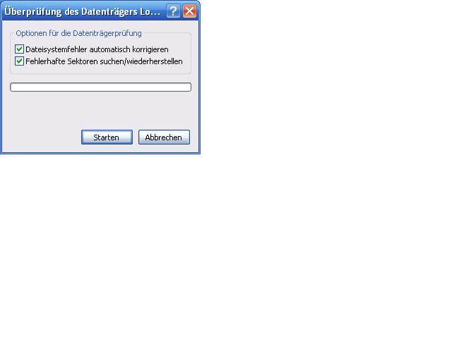

Datenträgeroberflächenanalyse heist das Zauberwort.
Arbeitsplatz->Laufwerk->Rechte mausstaste->Extras->Datenträgerüberprüfung
Häcken wie im anhang.
