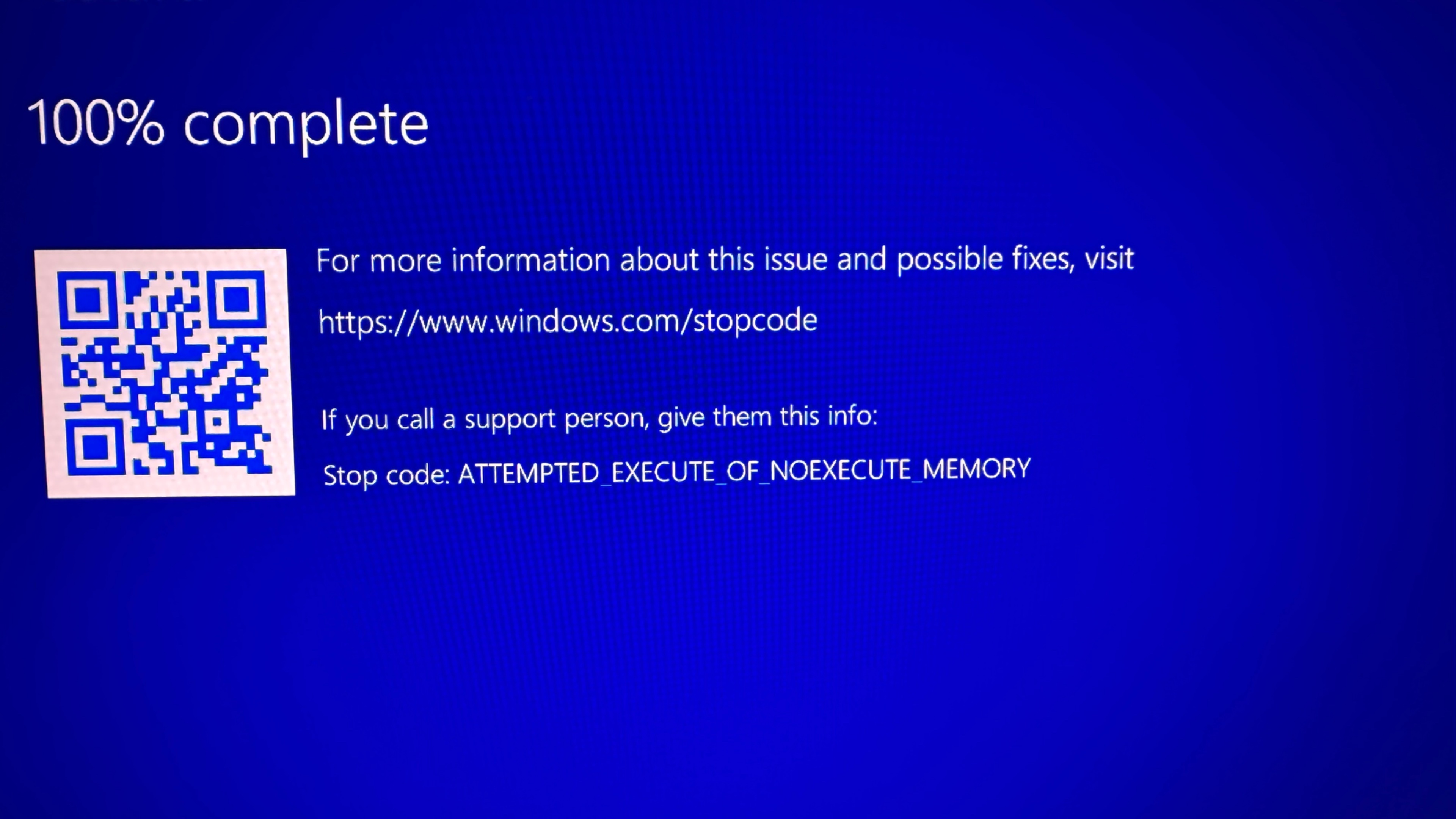

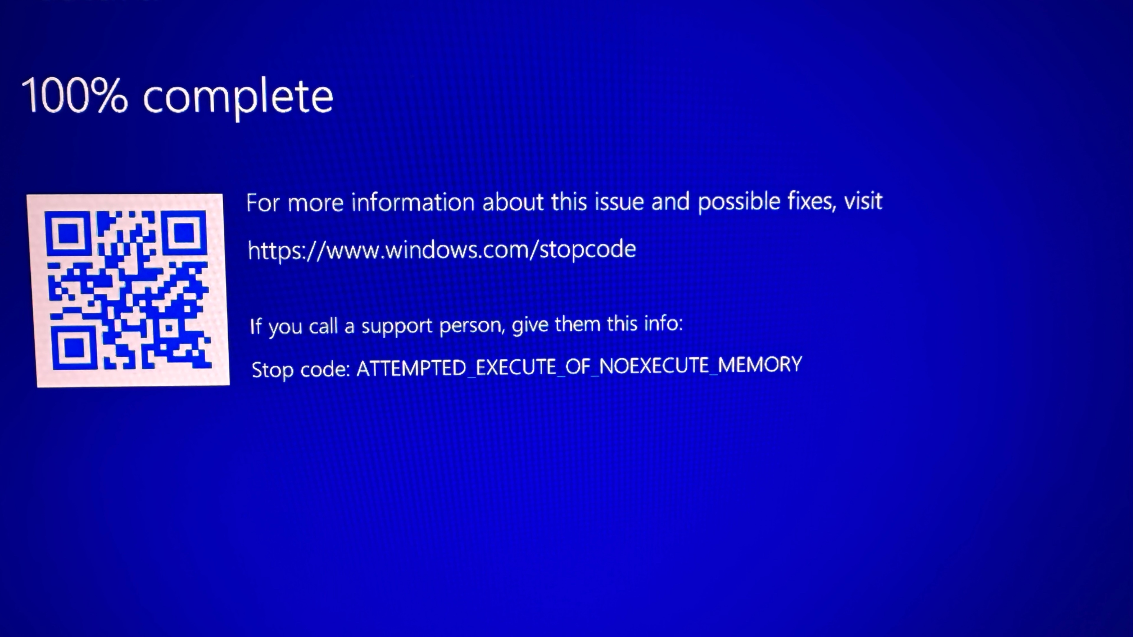

Hi, ich wollte gerade ne Runde AC shadows spielen, als sich mein pc mit folgendem bluescreen verabschiedete (siehe Bild)
Ich habe den Rechner dann manuell ausgemacht und wieder an gemacht. Dann gingst er wieder aus und nun lĂ€sst er sich gar nicht mehr einschalten 😳 System ist das aus meiner Signatur. Noch kein halbes Jahr alt. Jemand ne Idee was ich versuchen könnte ?

This is a Windows Blue Screen of Death (BSOD) error with the stop code: ATTEMPTED_EXECUTE_OF_NOEXECUTE_MEMORY.
Possible Causes:​
  1. Faulty Drivers – A recently installed or outdated driver might be causing conflicts.
  2. Corrupt System Files – Windows files may be damaged.
  3. Defective RAM – Memory corruption or failing RAM can trigger this error.
  4. Malware or Viruses – Malicious software could be interfering with memory execution.
  5. Overclocking Issues – If the system is overclocked, it might cause instability.
  6. Hardware Failure – A defective component (RAM, CPU, or motherboard) could be responsible.
How to Fix:​
1. Boot into Safe Mode
  • Restart your PC and repeatedly press F8 or Shift + F8 (for older Windows versions).
  • Select Safe Mode and uninstall any recently installed drivers or software.
2. Update Drivers
  • Go to Device Manager (Win + X > Device Manager).
  • Update drivers for graphics, network, and chipset.
3. Run Windows Memory Diagnostic
  • Type mdsched.exe in the Windows search bar and run it.
  • Restart your PC and let the tool scan for RAM issues.
4. Check for Corrupt System Files
  • Open Command Prompt (Admin) and run:
    Code:
    sfc /scannow
    • Also, try:
    Code:
    DISM /Online /Cleanup-Image /RestoreHealth
5. Disable Overclocking (if enabled)
  • Reset BIOS settings to default.
6. Perform a System Restore
  • If the issue started recently, restore Windows to a previous working state.
7. Check for Malware
  • Run a full scan using Windows Defender or a trusted antivirus.
If the issue persists, you may need to reinstall Windows or test your RAM and hardware with diagnostic tools.
