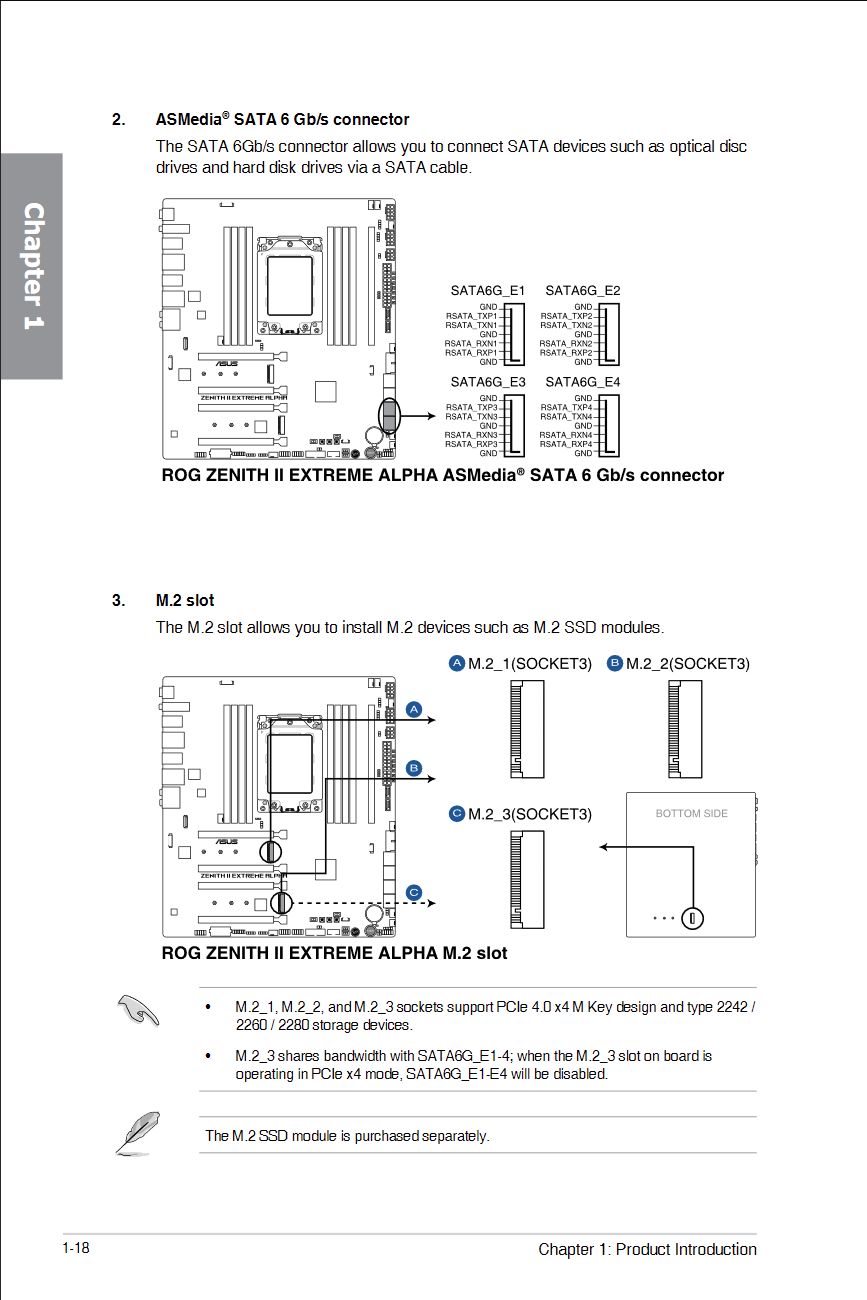

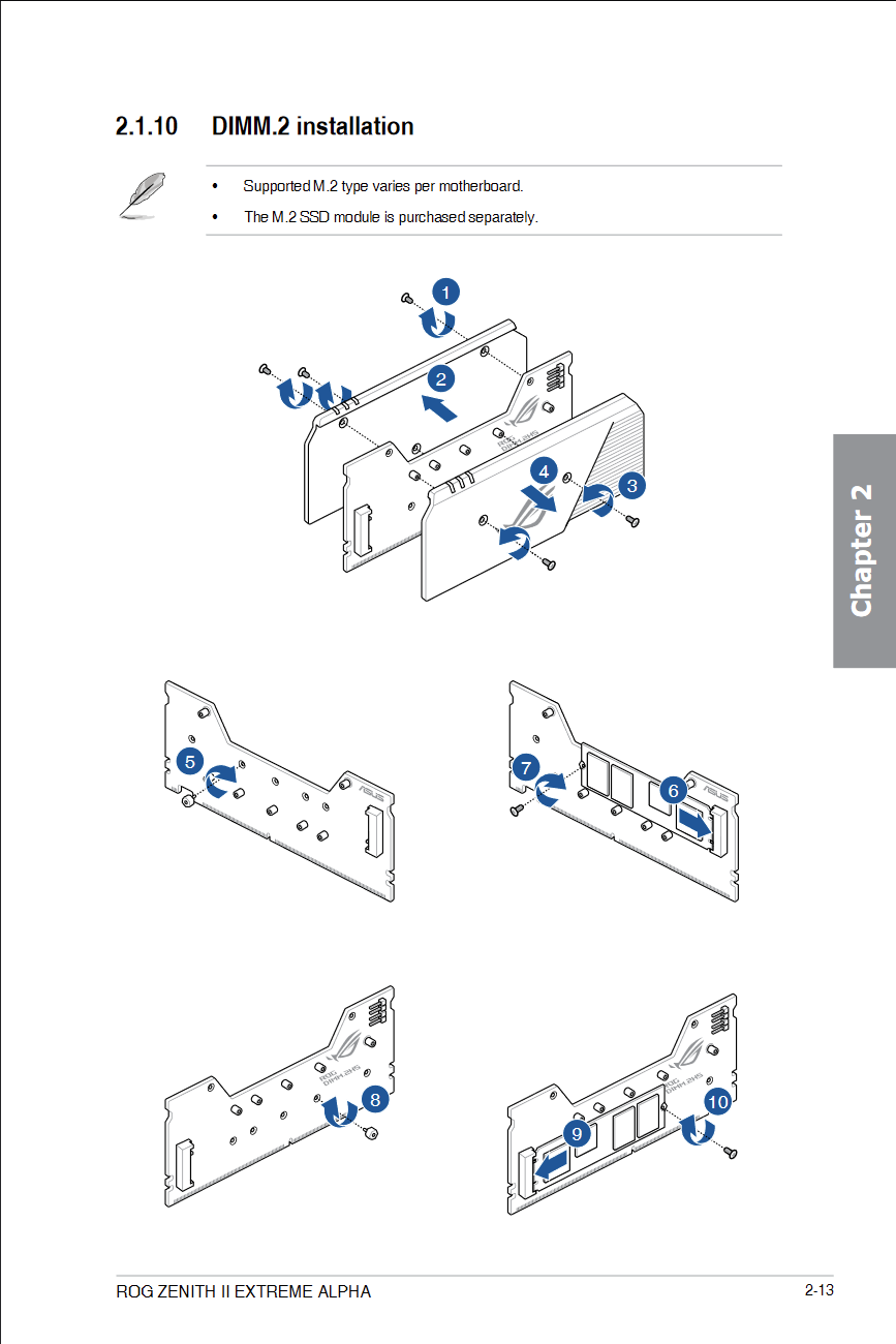

ASUS ROG Zenith II Extreme Alpha
3rd Gen AMD Ryzen™ Threadripper™ Series Desktop processors :
1 x ROG DIMM.2 Module supports 2 M.2 Socket 3 , with M key, type 2242/2260/2280/22110 storage devices support(SATA & PCIe 4.0 x4 mode)
2 x M.2 Socket 3, with M Key, type 2242/2260/2280 (PCIe 4.0 x4 mode)*1
1 x M.2 Socket 3, with M Key, type 2242/2260/2280 (PCIe 4.0 x4/x2 mode)*2
AMD TRX40 chipset :
4 x SATA 6Gb/s port(s), ASMedia® SATA 6Gb/s Controller : Support Raid 0, 1, 10
Manual
