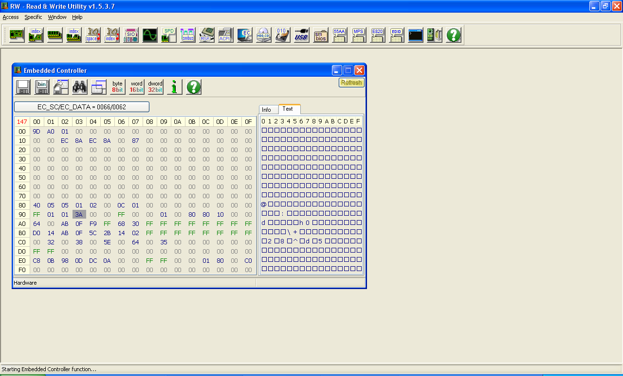

Hello everybody,
I'm trying to get this working on a Sony Vaio VGN-S4 laptop. I'm using RWeverything to discover the registers I need to change. I'm also comparing with the provided config files for other Vaio laptops.
I think the write-register is number 147, because I can input a value and I hear the fan adjusting its speed for a short while. But then the Bios kicks in (in less than a second) and restores the previous value.
At this point I'm stuck. I haven't been able to find the automatic/manual register (and not either the read-register), to switch off Bios control over the fan.
I've tried the registers next to 147:
1) number 148 can be set either to "00" or to "80" and it seems related to the DVD writer, because I hear the DVD writer initializing when I set 148 to "00".
2) number 146 can be either "00" or "01" or "02" or "03" but I don't know what it does. It's also influenced by other registers (131, if I remember correctly).
3) number 145 can be either "00" or "01", but I can't understand what it does.
I'm now looking at the DSDT, but I don't know how to interpret this:

What does "FAN0, 8," mean? Could you please give me some hint? I attach the DSDT, in case it's useful, and RWeverything's screenshots with the fan on and off.
Thanks.
