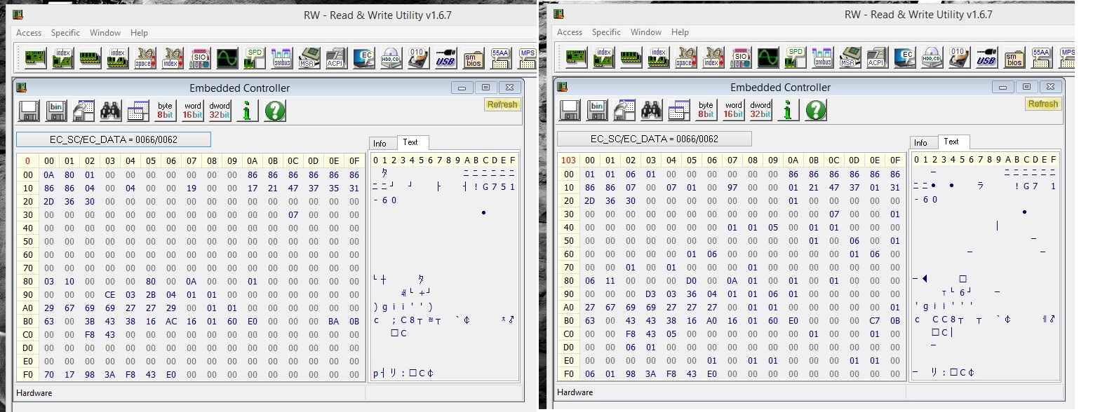

Thank you very much for the response and advice. I did make a profile from scratch just yesterday but I used both fan cofigurations as it was in Zenbook UX32LN. I will make one from scratch with only one fan just now. I don't actually need to control the GPU fan since the GPU fan is workin quite good. The speed of the fan goes to like 70-80% when the temps reaches 75C so it is good. If I push it to 100% the temp of the GPU stays on 70C but the fan is too damn loud and I don't want to push it that hard. These being said I will start a profile with only the CPU fan since that one is poorly optimized and only goes to 80% when it reaches 90C -_- (what we're those guys thinking !?! ).
The fact is that in these last 3 days, since I read your Noteebook Fan Guide I kept my eyes on the EC Table with RWEverything all the time. What I have found is that the weird behavior might come from the fact that there are random values that are written in the EC Table (See the pics below). I don't know why those values are getting written because in my config I only used the 151 and 152 registers. I will upload that profile here so you can see what I'm talking about.
So, here is the pic with the EC Controller. This is a comparison between Normal EC Values after I uninstalled NBFC and reseted the EC by holding the power button of the laptop for 10secs (On the left, with the fewer values), and the EC Values from when I had the NBFC enabled for like 1 day of use (the config which I uploaded here). Those random values got written by something and I don't really know what. And the values do not dissapear until I reset the laptop with the 10secs like I said. After that I kept RWEverything running all the time and I checked the values every once in a while. BY now I already learnt what values are normal and what values should not be there ... That example was the worst I've ever had until now (that I actually saw with the RW Everything) and I think it was due to the fact that I changed the profiles a couple of times.
Here is the link to the config "G751JY (6Steps)", and there you have some other screenshots with the EC Table with NBFC and Normal EC After reset https://onedrive.live.com/redir?resid=F29DB39AE83CBE6D!712&authkey=!AFhpZeEM2ZEH4fI&ithint=folder,rw
Thank you very much! I'm sorry for bugging all the time with my profile but I really want to make one that is stable so I can share it with other RoG Owners. I'm doing my best at the moment considering that I do not have any specialization in IT or Informatics... Lucky for me that I'm studying engineering and I'm a patient guy :)).

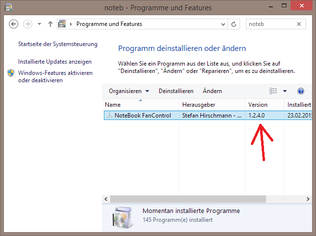

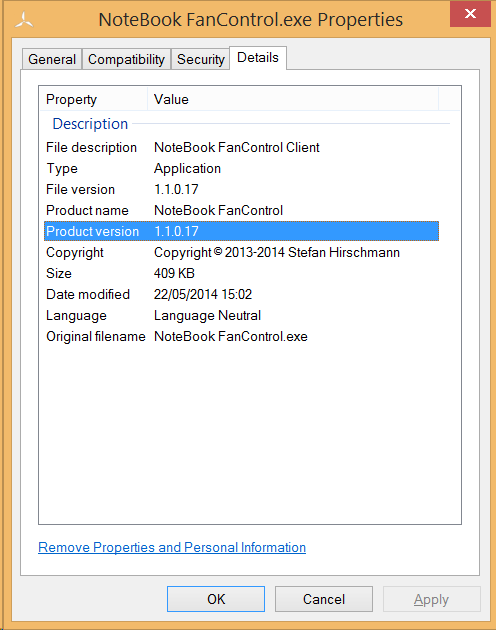

I tried completely uninstalling 1.1.0.17 and then installing from the download link in the original post but the .exe version is still showing up as .17... am I doing something wrong?! Thanks for your help.
Try uninstalling and a registry cleaner like the one from TuneUp Utilities or any other reliable one.
@NitroXRoG
Your screenshot looks like something is interferring with NBFC's read/write operations - maybe RWEverything itself. I do not recommend running NBFC and RWEveryhting in parallel more than some minutes, especially if you set the poll intervall to a value < 1000ms.
In general you should disable all applications which could interfere with NBFC (e.g. hardware monitoring tools) if you encounter any problems.
@XRD_
Doesn't look wrong to me. I haven't updated the client version because the client was'nt affected by the update.
Check Windows programs and features if the latest version is installed:

Edit: just to confirm in programs it is definitely displaying as 1.1.1.19
