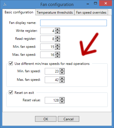

Ich habe jetzt die Möglichkeit implementiert min/max speed für read und write register getrennt festlegen zu können:
fancfg-png.519933
Falls jemand das Feature testen will, kann er sich bei mir melden, dann baue ich ihm ne aktuelle Version (aus meinem development branch).
Ich glaube z.B. bei den Sony Vaio Multiflip wäre das ganz nützlich(?)

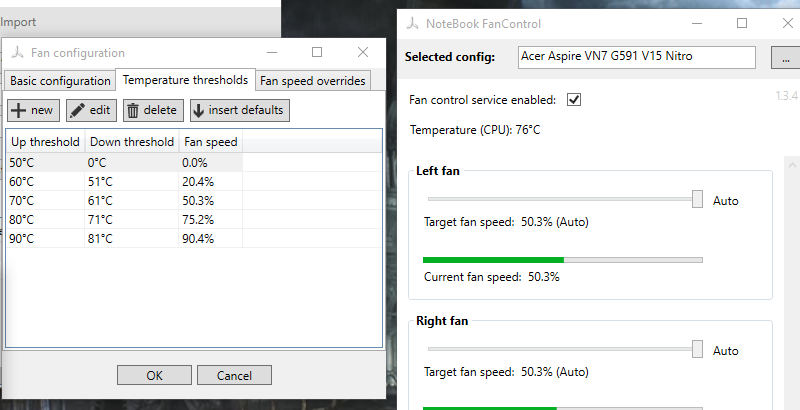

Hi, awesome program, thank you!
I seem to have the same problem with my Acer Aspire Nitro as others have sad.
The temperature is shown correctly on the main screen, but the fan % does not match the profile I have created as you can see on the screenshot.
The profile is set to 75%, but the fan percentage is still stuck at the previous setting. It's as if they are lagging behind by one profile? I'm on Windows 10 and I have tried simple edits like the polling interval.
Thanks in advance!
I'm glad you like my work :)
According to you screenshot, NBFC works as expected.
The current temp. is 76C, the next threshold is at 80C, so NBFC selects the 70C threshold and sets the fan speed to 50%.

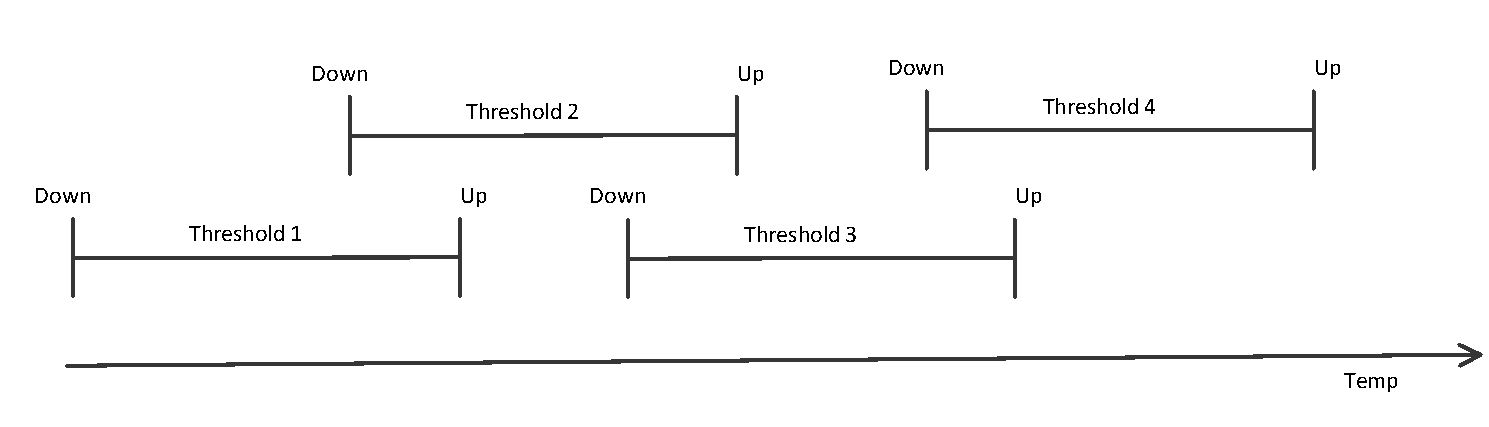

Btw. for best results, define your thresholds like this:

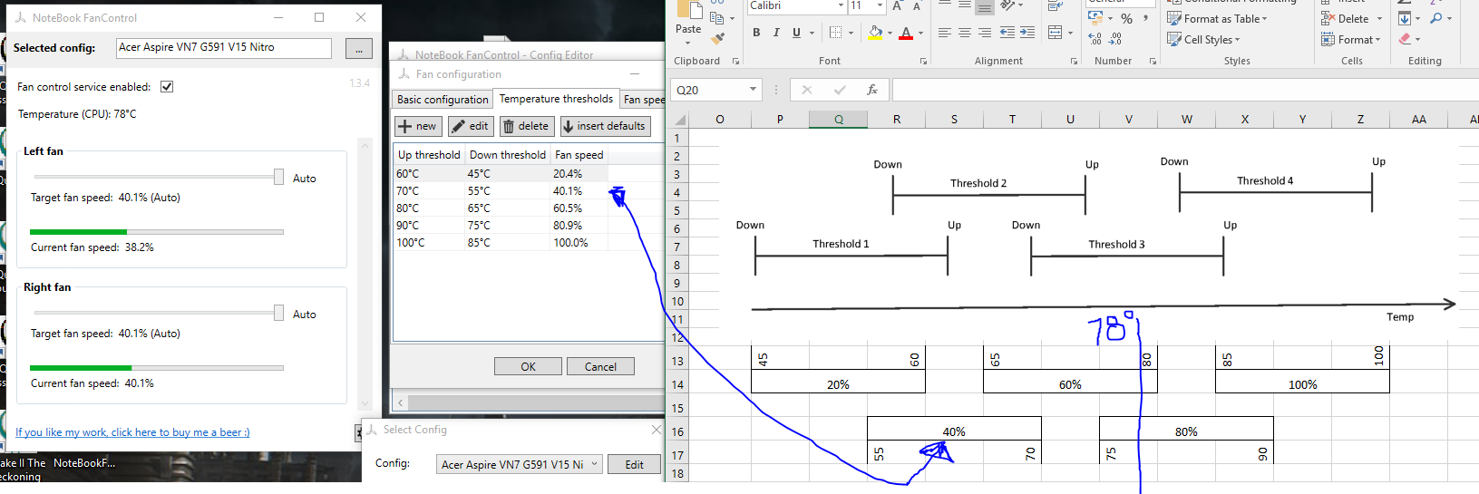

Thank you for replying so quickly!
I have tried your definition and left a stress test running (which usually is stable at 78 degrees). At 78 degrees, it should be using either 60% fan or 80%, but it is still using 40%.
Am I doing something wrong?
