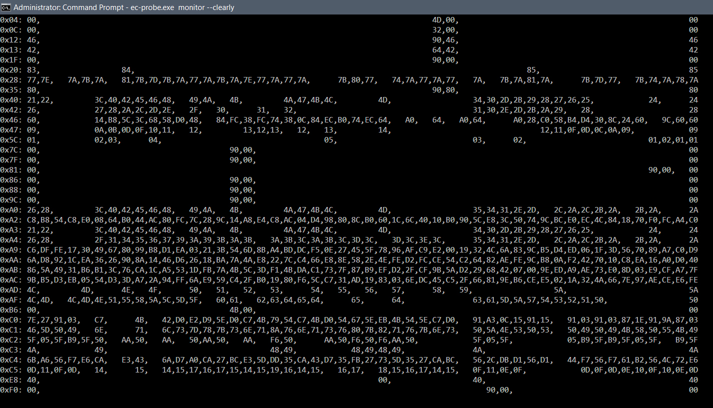

Hello I am sorry I don't speak German but am hoping someone can help me out as I am struggling to develop a config for my Sony Vaio VPCEB4C5E.
I have tried existing Sony Notebook Fan Control configs but none seem to work. I tried a config for an SVF14N1C5E which led me to discover when 'Register write configuration' has the following settings, the fan revs up to a high speed and eventually settles down:
Write occasion: OnWriteFanSpeed or OnInitialization
Write mode: Set
Register: 94
Value: 32
When Read Register is set to 92 [0x5C] with a Min Speed of 0 and Max speed of 7 it does seem to respond with the fan speed change however a Write Register of 94 [0x5E] doesn't control the fan. Also, enabling the config with the above 'Register write configuration' settings can sometimes make the keyboard stop working.
I have run the EC Probe tool with Prime95 and I've attached my results below with a low - high - low fan speed. Register 175 [0xAF] seemed very responsive to the fan changes but I can't get it to control the fan either.
I have uploaded the DSDT here if it would help: https://pastebin.com/U91YW53B
If anyone can give me some help I would very much appreciate it. Thank you!
I manually stopped the fan and the registers that went to zero were 70 [0x46] and 71 [0x47] so I assume these are the fan control registers. Unfortunately NBFC does not seem to work with these registers even with the poll interval reduced so I guess the Embedded Controller needs to be put into manual mode. Can anyone give any advice as to how to find the correct register that puts the EC into manual mode?

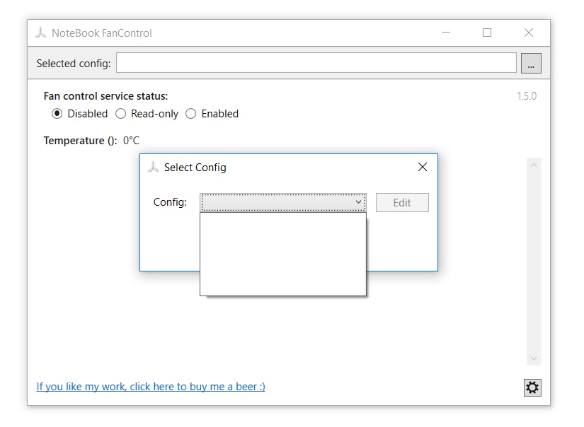

Hat jemand Erfahrungen mit der Einstellung von NFC bei einem Asus Zenbook UX3410UQ-GV077T 14“?
leider kann ich weder die FanControl aktivieren, diese ist immer auf "Disabled" und ich kann auch kein Profil auswählen, siehe Bild. Das DropDowm für die Config ist leer, obwohl ich zuvor im ConfigManager meine noch leere Config gespeichert habe.
Der Config Manager erkennt aber mein Laptop "Acer Aspire E5-553G".
könnte mir da vielleicht jemand helfen?
ausgeführt und installiert als Administrator, keine Veränderung der Problems.

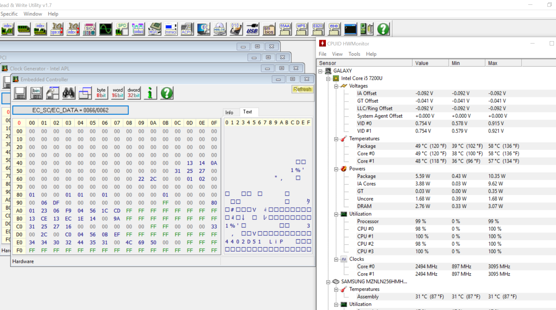

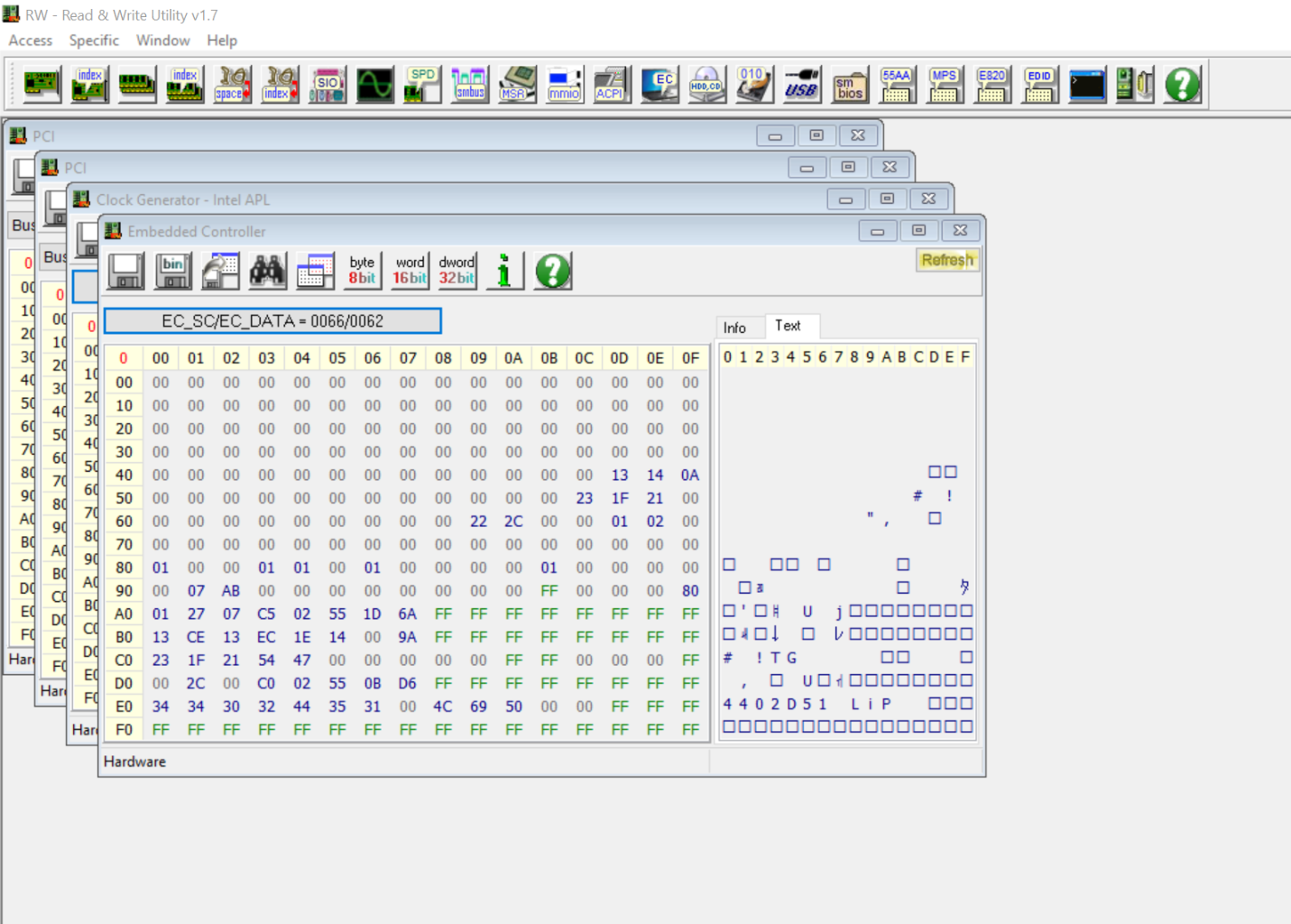

Hallo Freunde
helfen, NoteBookFanControl für Samsung galaxy book 12 zu schärfen Ich kann nicht Read & Write EC
Ich befestige Screenshots des Programms RWEverything
Es gibt eine Sequenz mit verschiedenen Lüftergeschwindigkeiten, einschließlich wenn sie gestoppt wird
EmbeddedControl address
APCI Tables --> DSDT
Code:
    Scope(_SB.PCI0.LPCB.H_EC)
        OperationRegion(ECR, EmbeddedControl, Zero, 0xFF)
        Field(ECR, ByteAcc, Lock, Preserve)
            Offset(0x18),    //Offset(24),
            SPTR, 8,
            SSTS, 8,
            SADR, 8,
            SCMD, 8,
            SBFR, 256,
            SCNT, 8,
            Offset(0x50),    //Offset(80),
            CMDR, 8,
            PPSL, 8,
            PPSH, 8,
            PINV, 8,
            PENV, 8,
            PSTP, 8,
            CPUP, 16,
            Offset(0x5C),    //Offset(92),
            TSR0, 8,
            TSR1, 8,
            TSR2, 8,
            TSR3, 8,
            TSR6, 8,
            TSR7, 8,
            TSD0, 8,
            TSD1, 8,
            TSD2, 8,
            TSD3, 8,
            CFSP, 16,
            CHGR, 8,
            TSI, 4,
            HYST, 4,
            TSHT, 8,
            TSLT, 8,
            TSSR, 8,
            DPPF, 4,
            Offset(0x71),    //Offset(113),
            ELG0, 8,
            ELG1, 8,
            ELG2, 8,
            ELG3, 8,
            ELG4, 8,
            ELG5, 8,
            ELG6, 8,
            ELG7, 8,
            ELG8, 8,
            ELG9, 8,
            , 8,
            ECCS, 8,
            , 8,
            MDSW, 8,
            BTEN, 8,
            B1EX, 1,
            , 1,
            ACEX, 1,
            , 5,
            SWBE, 1,
            DCBE, 1,
            , 6,
            WLST, 1,
            OPST, 1,
            , 6,
            LSTE, 1,
            CNVM, 1,
            , 6,
            B1ST, 8,
            , 8,
            EDPO, 8,
            Offset(0x89),    //Offset(137),
            EMEN, 8,
            , 8,
            AGWC, 8,
            Offset(0x8E),    //Offset(142),
            SLFL, 2,
            Offset(0x90),    //Offset(144),
            SWST, 8,
            BTPC, 16,
            CLED, 2,
            Offset(0x95),    //Offset(149),
            SCCW, 8,
            CBTP, 8,
            Offset(0x9A),    //Offset(154),
            VRMF, 8,
            , 8,
            SCAI, 8,
            CSMF, 8,
            CSST, 8,
            EPTS, 8,
            B1RR, 32,
            B1PV, 32,
            B2RR, 32,
            B2PV, 32,
            B1AF, 32,
            B1VL, 32,
            B2AF, 32,
            B2VL, 32,
            CTMP, 8,
            , 8,
            CET1, 8,
            CET2, 8,
            Offset(0xC7),    //Offset(199),
            TIST, 8,
            Offset(0xD0),    //Offset(208),
            CYLC, 16,
        Method(_Q40, 0, NotSerialized)
            ADBG("Volume Up")
            If(LAnd(LGreaterEqual(OSYS, 0x07DF), ^^^^HIDD.BTLD))
                ADBG("Notify _HID 0xC4")
                Notify(HIDD, 0xC4)
            Else
                If(And(PB1E, 0x20))
                    ^VGBI.UPBT(0x02, One)
                    ADBG("Notify 0xC4")
                    Notify(VGBI, 0xC4)
ich hatte das gleiche Problem mit der Version 1.5.0, die Version 1.5.3-Beta läuft ohne Probleme...
