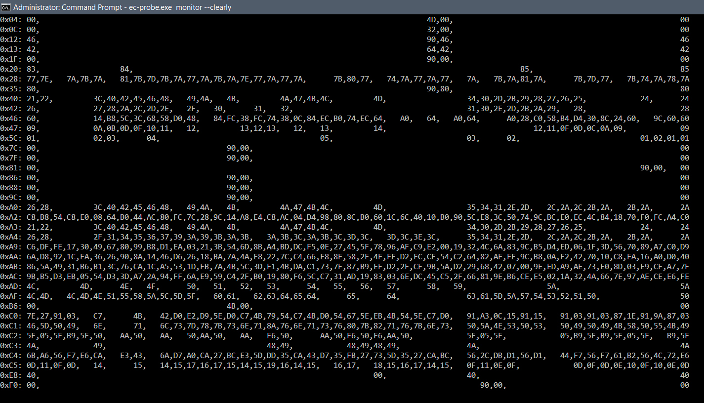

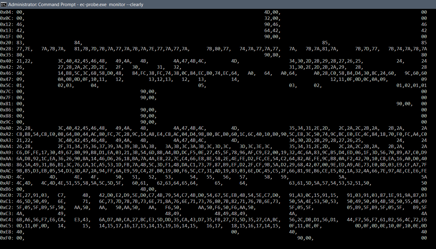

Hello I am sorry I don't speak German but am hoping someone can help me out as I am struggling to develop a config for my Sony Vaio VPCEB4C5E.
I have tried existing Sony Notebook Fan Control configs but none seem to work. I tried a config for an SVF14N1C5E which led me to discover when 'Register write configuration' has the following settings, the fan revs up to a high speed and eventually settles down:
Write occasion: OnWriteFanSpeed or OnInitialization
Write mode: Set
Register: 94
Value: 32
When Read Register is set to 92 [0x5C] with a Min Speed of 0 and Max speed of 7 it does seem to respond with the fan speed change however a Write Register of 94 [0x5E] doesn't control the fan. Also, enabling the config with the above 'Register write configuration' settings can sometimes make the keyboard stop working.
I have run the EC Probe tool with Prime95 and I've attached my results below with a low - high - low fan speed. Register 175 [0xAF] seemed very responsive to the fan changes but I can't get it to control the fan either.
I have uploaded the DSDT here if it would help: https://pastebin.com/U91YW53B
If anyone can give me some help I would very much appreciate it. Thank you!

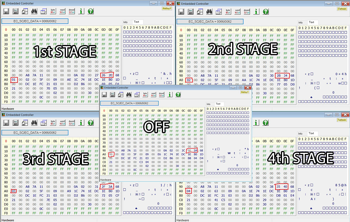

Hello
I hope you dont mind if I write in english, my german is not so great. So I recently bought a Xiaomi Notebook Pro (i5 version) and Im not really satisfied with the fan curve. My initial testing revealed that this notebook has 4 RPM setting (5 if you count the OFF state). I think I found the values that represents the fans as well. In the attached screenshot you can see the 00, 01, 02, 03, 04 states which directly corresponds with the values on the right side of each window.
00 (OFF) --> 00 2A
01 (1st level) --> 26 2E
02 (2nd level) --> 2B 34
03 (3rd level) --> 2F 3A
04 (4th level) --> 35 40
These values change with each other every time. My problem is that it seems the the two fans on my notebook can work independent from each other, but cant figure out for the life of me what value in the EC table changes the fan speed of the right fan.
Lets say I directly write in the EC table when the fans are working on level 1, in the EC table the values are 01 (1st level) --> 26 2E. I change the 01 value to 00, I can hear the fan on the left side shutting down, but the "26 2E" values dont change in the table and I can hear the fan on the right side is still working on level 1. But if I try to manually change the "26 2E" values to its OFF state ("00 2A"), nothing happens.
I hope I could explain it well enough, if any of you guys have any insight on this issue, please let me know, help would be much appreciated!
Cheers,
Ferdinand

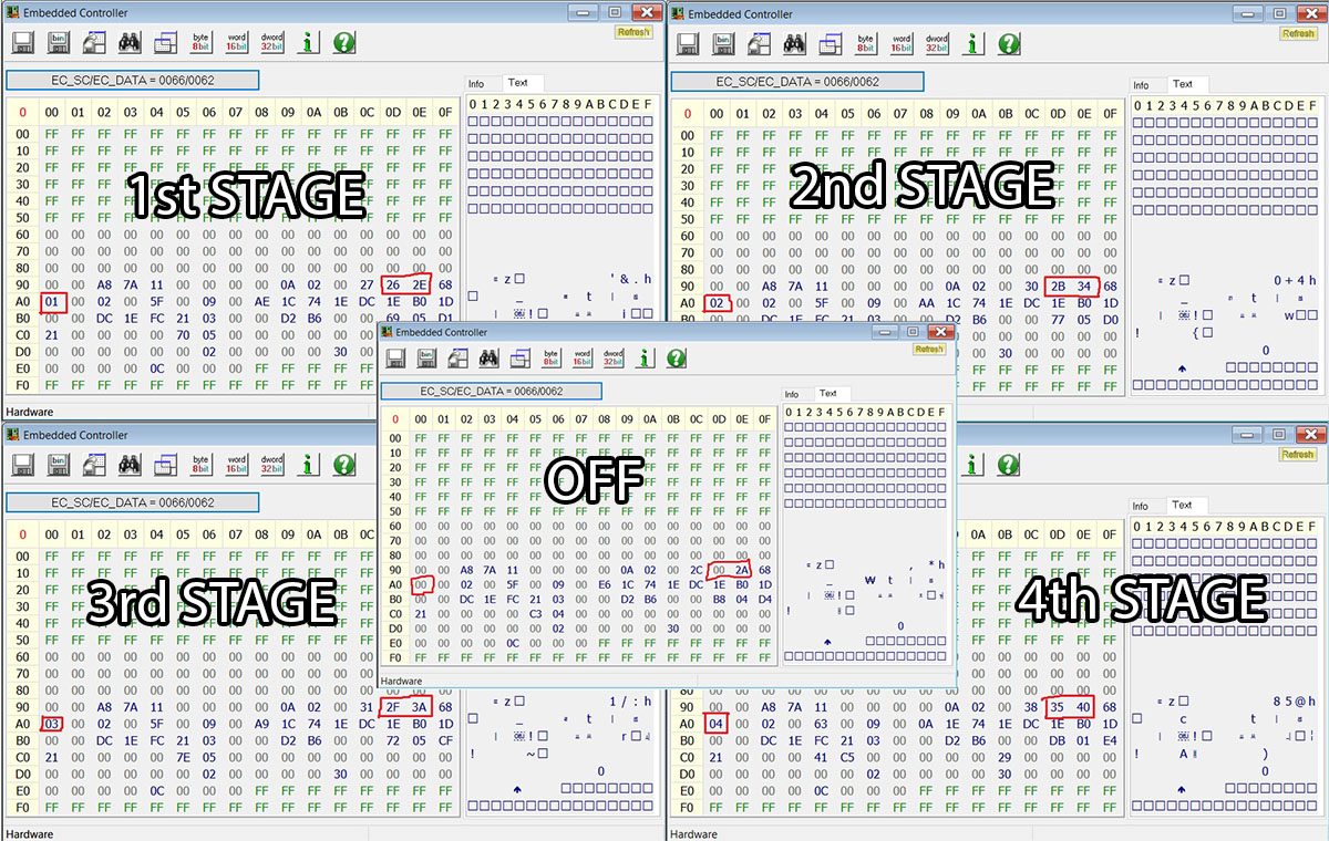

00 (OFF) --> 00 2A
Cheers,
Ferdinand
