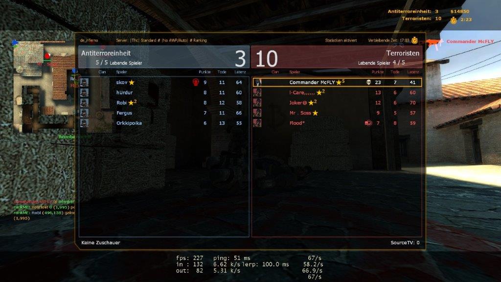

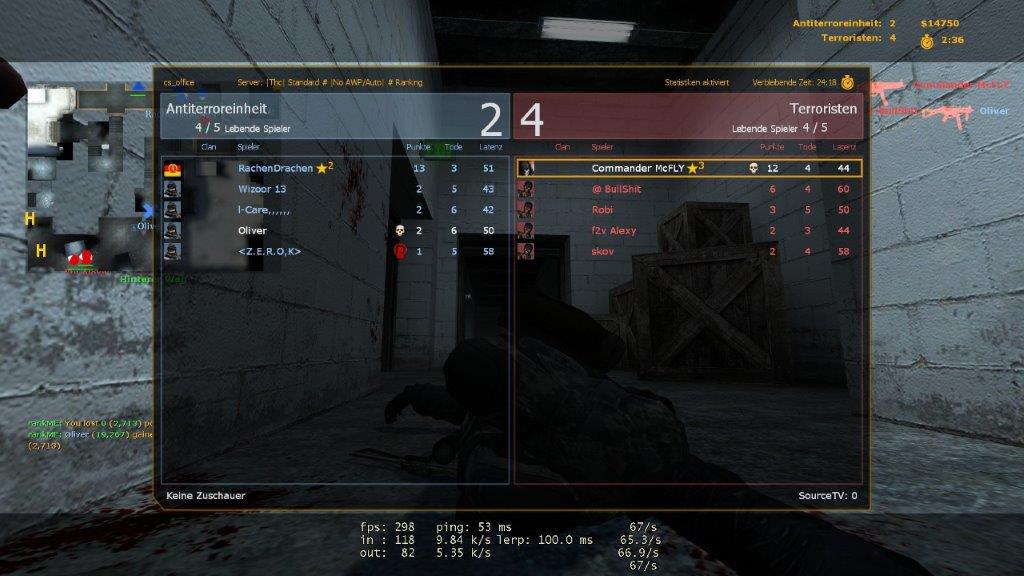

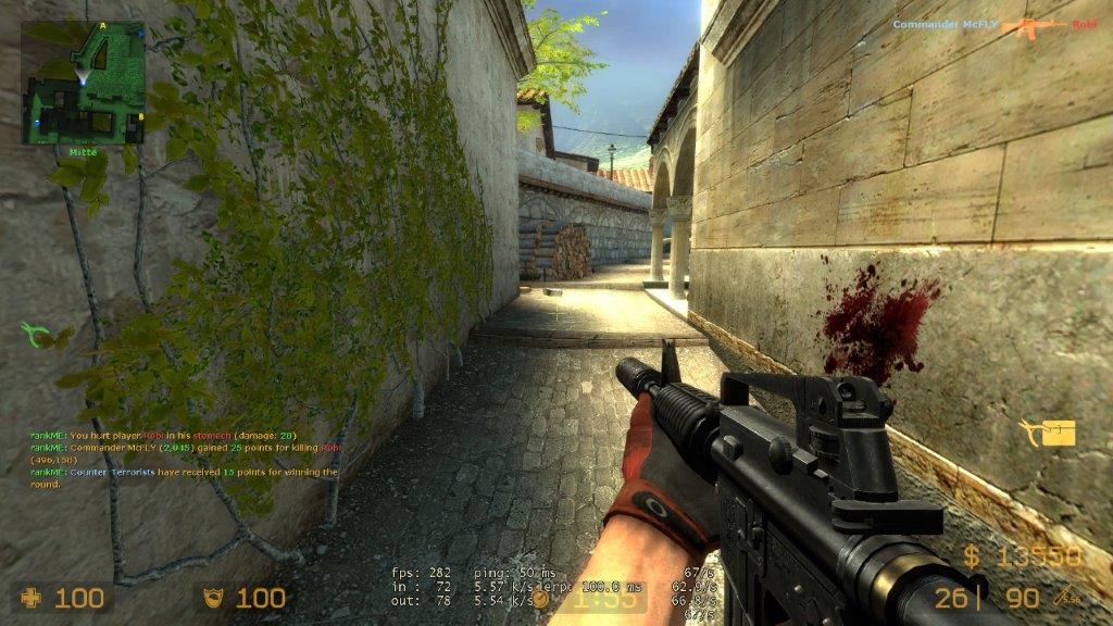

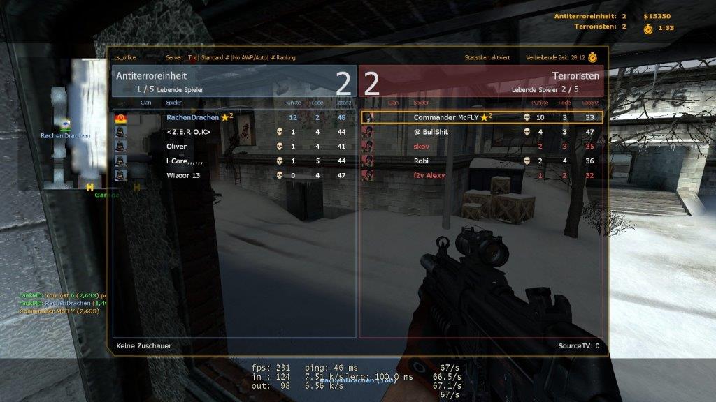

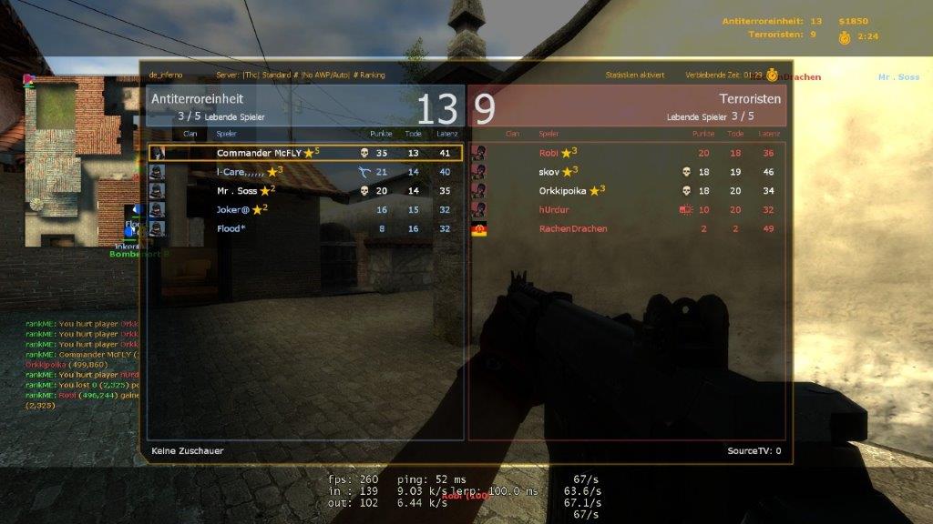

Ein Problem hab ich aktuell leider "neu" dazu bekommen...
Ich sehe nach wie vor meine Player-Skins und auch die Waffen; allerdings die Waffen-Skins nur noch in "meinen Händen"...?!
Bei Gegnern & Team leider nicht; da nur irgendwelche Standard-Skins an Waffen..
WO ist der "Haken"; was hab ich falsch..??? Also die Skins sind allesamt da; aber halt nicht bei den anderen Spielern zu sehen..; muss ja "iwo nen "Eintragsproblem" sein ja? ..also iwo ne "0" statt "1" oder so???
...das war das letzte nach den "Änderungen", was die Console so zum besten gab..; kann damit nicht soo viel anfangen..; ist da eventuell was an "Problemen" erkennbar?
Steam config directory: G:\STEAM\steamapps\common\Counter-Strike Source\platform\config
CClientSteamContext logged on = 1
Parent cvar in server.dll not allowed (steamworks_sessionid_client)
Hud element 'CHudVote' doesn't have an entry 'CHudVote' in scripts/HudLayout.res
Unknown command "cl_thirdperson"
Can't use cheat cvar cam_snapto in multiplayer, unless the server has sv_cheats set to 1.
Can't use cheat cvar cam_ideallag in multiplayer, unless the server has sv_cheats set to 1.
Can't use cheat cvar cam_idealdelta in multiplayer, unless the server has sv_cheats set to 1.
Can't use cheat cvar cam_idealyaw in multiplayer, unless the server has sv_cheats set to 1.
Can't use cheat cvar cam_idealpitch in multiplayer, unless the server has sv_cheats set to 1.
Can't use cheat cvar cam_idealdist in multiplayer, unless the server has sv_cheats set to 1.
Can't use cheat cvar cam_idealdistright in multiplayer, unless the server has sv_cheats set to 1.
Can't use cheat cvar cam_idealdistup in multiplayer, unless the server has sv_cheats set to 1.
Can't use cheat cvar cam_collision in multiplayer, unless the server has sv_cheats set to 1.
Can't use cheat cvar c_maxpitch in multiplayer, unless the server has sv_cheats set to 1.
Can't use cheat cvar c_minpitch in multiplayer, unless the server has sv_cheats set to 1.
Can't use cheat cvar c_maxyaw in multiplayer, unless the server has sv_cheats set to 1.
Can't use cheat cvar c_minyaw in multiplayer, unless the server has sv_cheats set to 1.
Can't use cheat cvar c_maxdistance in multiplayer, unless the server has sv_cheats set to 1.
Can't use cheat cvar c_mindistance in multiplayer, unless the server has sv_cheats set to 1.
Can't use cheat cvar c_orthowidth in multiplayer, unless the server has sv_cheats set to 1.
Can't use cheat cvar c_orthoheight in multiplayer, unless the server has sv_cheats set to 1.
Can't use cheat cvar cl_upspeed in multiplayer, unless the server has sv_cheats set to 1.
Can't use cheat cvar cl_forwardspeed in multiplayer, unless the server has sv_cheats set to 1.
Can't use cheat cvar cl_backspeed in multiplayer, unless the server has sv_cheats set to 1.
Unknown command "weapon_accuracy_logging"
Unknown command "weapon_accuracy_model"
Unknown command "mat_spewalloc"
Host_WriteConfiguration: Wrote cfg/config.cfg
Can't use cheat cvar fog_start in multiplayer, unless the server has sv_cheats set to 1.
Can't use cheat cvar fog_end in multiplayer, unless the server has sv_cheats set to 1.
Can't use cheat cvar fog_startskybox in multiplayer, unless the server has sv_cheats set to 1.
Can't use cheat cvar fog_endskybox in multiplayer, unless the server has sv_cheats set to 1.
Can't use cheat cvar r_farz in multiplayer, unless the server has sv_cheats set to 1.

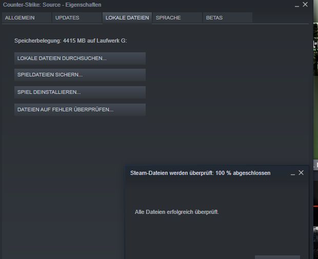

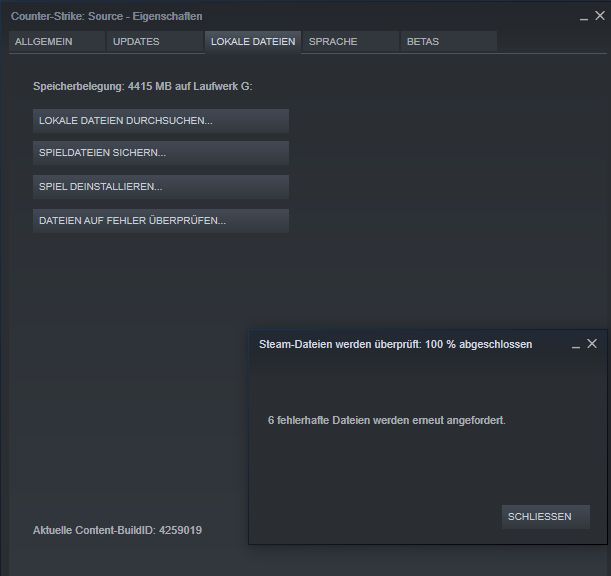

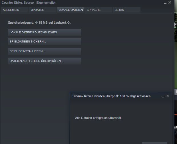

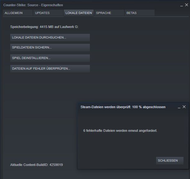

Hab dann nochmal aus meiner vorher gesicherten CSS-Geschichte, den „cfg“-Ordner zurückkopiert; brachte nix.
Okay, kann dann heute maximal noch mal den gesamten gesicherten „Counter Strike Source“-Ordner zurückkopieren…; ob es dann eventuell ist wie vorher…?! Bräuchte dann nur die Binds der Radio-Commands wieder abändern (gehen ja nun aktuell). Okay, "Spray-Thema" wär nach wie vor unklar; aber lieber spiele ich ohne; dafür aber mit der gewünschten Optik in Sachen Models, so dass ich auch die ersetzen Waffen-Skins bei der Gegnerschaft sehen kann..; ja, das "Auge spielt
