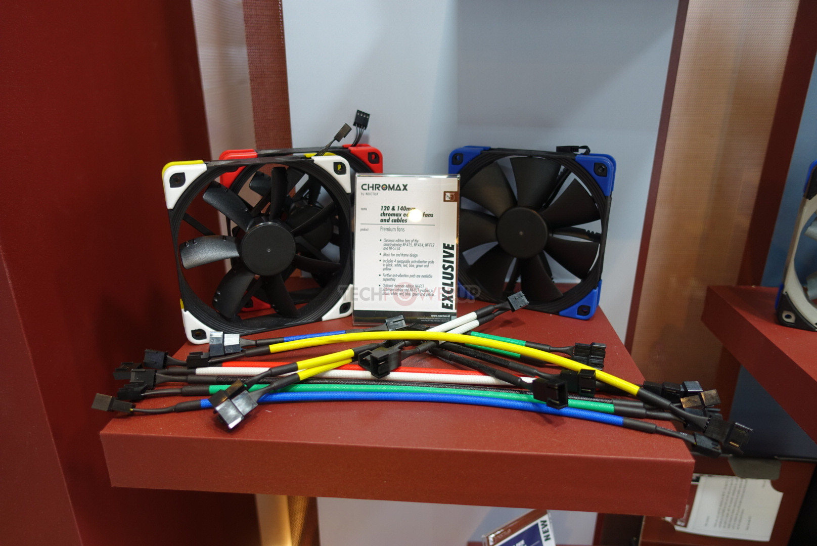

Die Noctua gibts demnächst auch in schwarz:
Der Noctua Support sagte mir etwas von Ende September.
• chromax edition fans of the award-winning NF-A15, NF-A14, NFF12
and NF-S12A
• Black fan and frame design
• Includes 4 swappable anti-vibration pads in black, white, red, blue,
green and yellow
• Further anti-vibration pads are available seperately
• Optional chromax edition NA-EC1 extension cables and NA-YC1 ycables
in black, white, red, blue, green and yellow
