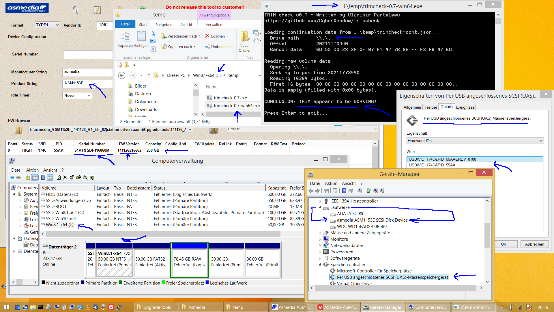

Firmware "140509_A1_82_40.bin" for Asmedia 1153E even supports SSD-TRIM (via SCSI->ATA-Translation (SCSI-Unmap => ATA-TRIM conversion)!
(All other versions tested, not.)

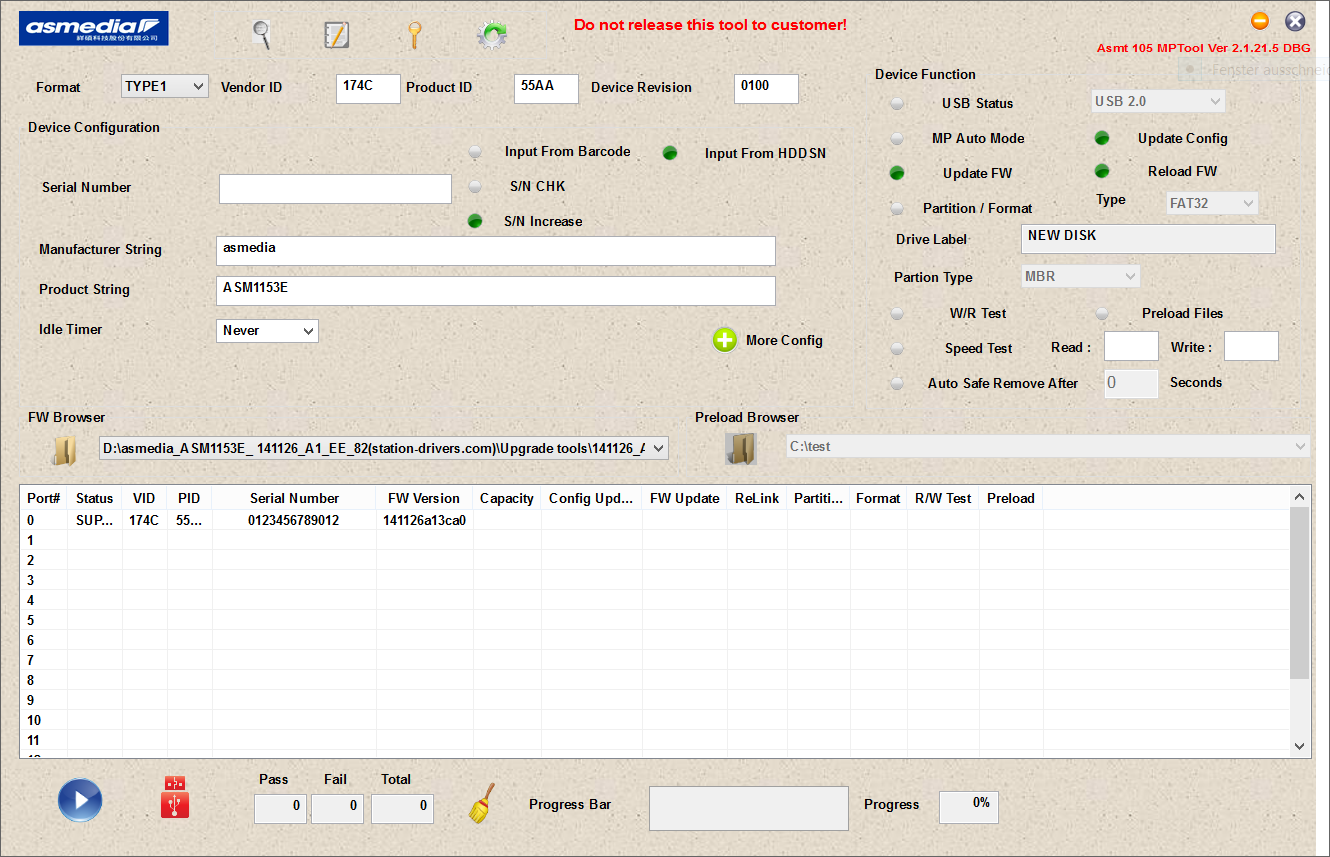

Principially many different MPTool versions also work for ASM1153E. 2.1.20 which afaik Fantec uses also works flashing this firmware
However I had difficulties to restore all exact config-settings from original Fantec firmware "130926_A1_00_00.bin" !! (some firmware.config-settings were activated with an O symbol, some deactivated with X. However flashing back using original Fantec_DB-Alu3e-6G_Firmware_v1.1.zip didn't restore all original config-settings-afaik. All config-settings show an X now, afaik very few activated, but still an X
Afaik I remember correctlyx, with some firmware +MPTool-version combination, once it was possible to restore original X, O -settings from Fatec,
or maybe those own wehich I edited in "as_mp_Tool v0.5.ini". But mostly when tested flashing firmwares, always my special enabled in as_mp_Tool v0.5.ini settings were shown falsely "off" X in MPTool-firmware config-setting-information window about flashing attermpt. E.g I had disabled HDD-standby in in setting, but after flashing with such config, HDD still going standby (after few minutes) (even though HDD's own Adavanced Power Management: disabled in HDD-firmware)
Nethertheless USB Bridge working fine.

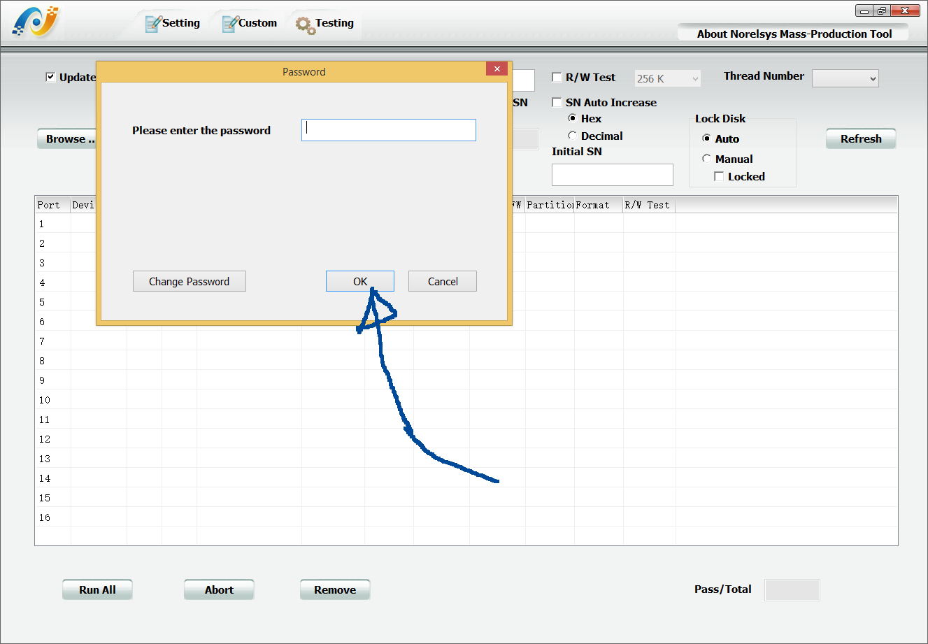

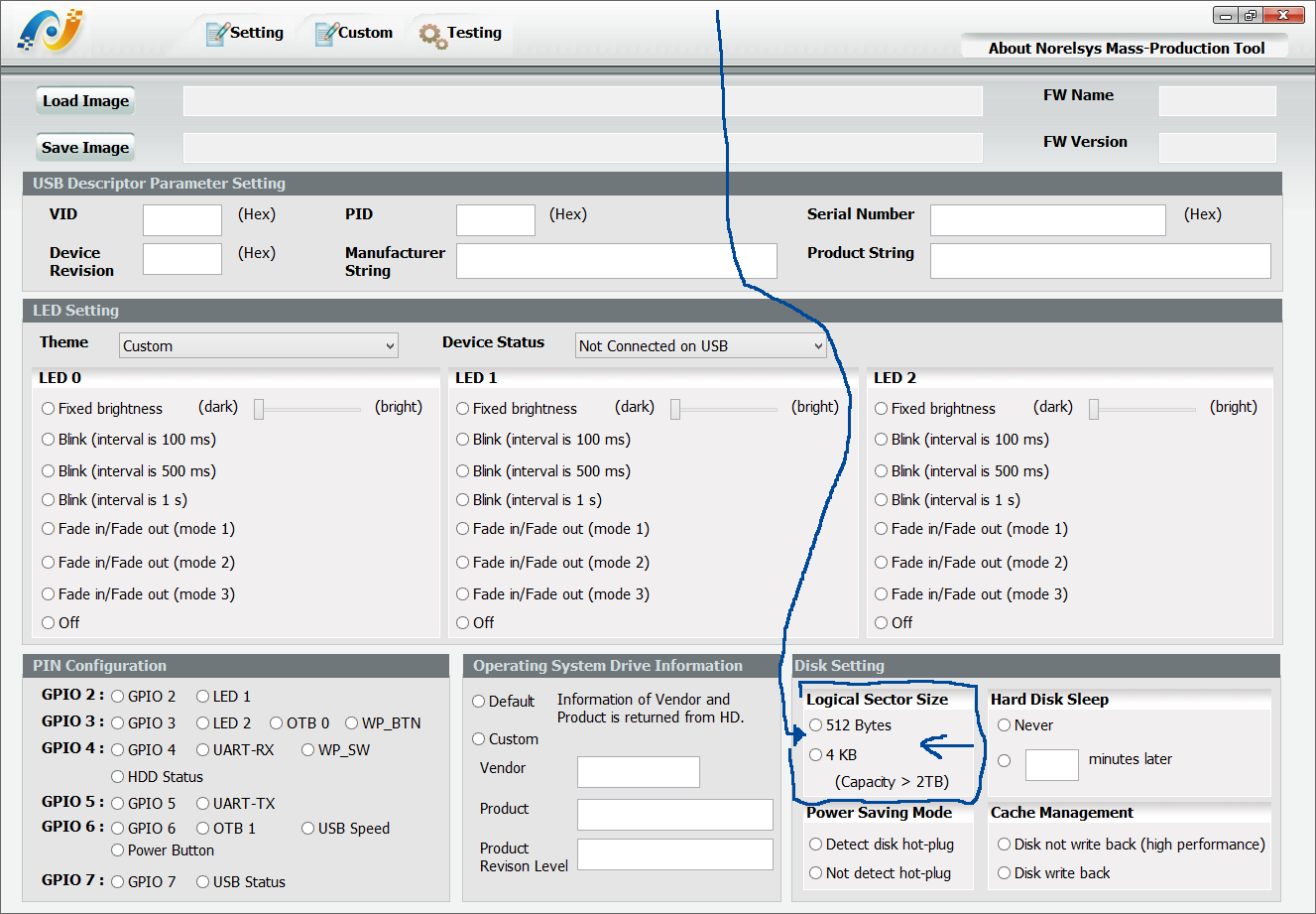

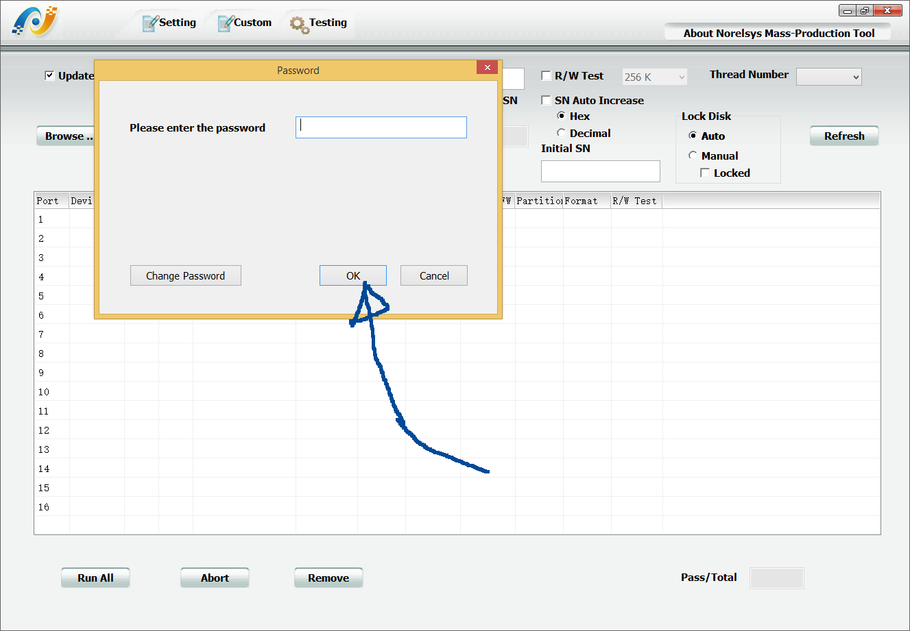

MPTool-password is needed to unlock all MPTool features,
like which firmware file to flash,
and edit/save/load fw-config-settings, like HDD-standby etc
from "as_mp_Tool v0.5.ini" for flashing firmware:
MPTool-password: asmedia:

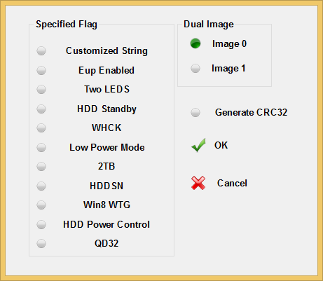

Dann habe ich mit MPTools versucht, nur die Seriennummer zu ändern und den unseligen 10 Minuten Standby Timer abzuschalten.
Die entsprechende ini "as_mp_Tool v0.4.-.1.hdd.standby.Aus.nur.änderung_SN" geladen.
MPTools meckert aber, der Flash startet nicht, ein Popup meldet "Error" und daß 4 Positionen zu checken sind, wobei die Einstellung von <more config> nicht zu finden ist.
Scheinbar muß immer auch die Firmware geflasht werden, nur um die Seriennummer und den Timer zu ändern.
Mit zusätzlichem Häckchen bei FW update geht die Änderung mit PASS durch.

Bestätigt, TRIM geht jetzt mit Firmware "140509_A1_82_40" (siehe Absätze+Beleg-Screenshots etw. weiter darunter)

Kann die Seriennummer und der Timer geändert werden, ohne die FW neu zu flashen?
Soweit ich weiß und probiert habe, ohne zu flashen, nein.

@Haiku
Öffne mal die "as_mp_Tool v0.4.ini" mit Editor/notepad. Relativ weit oben, glaub fast die letzte Zeile im ersten Passage/Absatz.
Setz mal bei Zeile Scan_HDDSN=0 den Wert auf 1! :)
=>Scan_HDDSN=1
Du musst aber die Firmware meines Wissens nochmal flashen, damit diese Konfiguration in der Firmware aktiv wird.
Alternativ kannst du das auch stattdessen direkt vor dem Flashen mit dem MPTool mit deiner Firmware auch im MPTool machen (Runde Checkbox im Asmedia-MPTool "Input From HDDSN") aktiveren, das entspricht der Zeile "Scan_HDDSN=1" in der "as_mp_Tool v0.4.ini".
Scan_HDDSN=1 (=Input From HDDSN): Schleift die SSD/HDD-Seriennumer durch, sodass sichtbar im Gerätemanager. Jede SSD und HDD hat ja eine eigene eindeutige Seriennumer.
Der Flash erfolgt OHNE HDD (NCIHT gedockt).
Wird nach einem erfolreichem FLash nur der Adapter angeschlossen, dann steht im MPTool-Statusfenster:
Serial Number 000000000000 angezeigt.
Wurd eine HDD gedockt, nachdem der Adapter neu erlannt wurde, wird im MPTool-Statusfenster: auch eine HDD-Sereinnumer angezeigt wie im Gerätemanager. Details etc. und die HDD-Kapazität.
Dann gibt's noch eine andere Einstellung, die auch helfen müsste. Du kannst jeder USB-ASMEDIA-Bridge deine eigene beliebige Seriennumer (hexadecimale Ziffern von 0 bis 9 und A bis max F) vergeben (z.B. 12-stellig wenn.SN_Numbers=12)
Es sollte nicht die gleiche sein für jede Bridge, grad wenn mherer Bridgs gleichzeitig, wie du ja bemerktest.
product_string=ASM1153E
serial_number=0123456789AB
serial_number_increase=1
SN_Numbers=12
oder serial_number=014590A7CBED
Wenn du einmal geflasht hattes, und die nächste Adapter-Bridge flasht, dann zählt das MPTool in den Zähler (hintere Stelle) automatisch um eins hoch, sodass für einen nächsten Flash die nächste Bridge eine näöchst-höhere Nummer bekommt.
Sodass nicht mehrere Bridges gleichzeitg, die selbe Nummer haben.
Mit Scan_HDDSN=1 (=Input From HDDSN) werden zumindest die Settings...
serial_number=XXXXXXXXXXXX
...meines Wissens außer Kraft gesetzt.
Noch etwas, wenn bei mir beide Zeilen folgende Zeilen gleichzeitig aktiv waren, gab es bei mir einen Failed Flash.
Check_USBStatus_enable=1
Check_USBStatus=1
Achte noch darauf, dass er nach einem Flash-Versuch die Bridge NICHT neu ins MPTool reinlädt.
rescan_after_relink=0

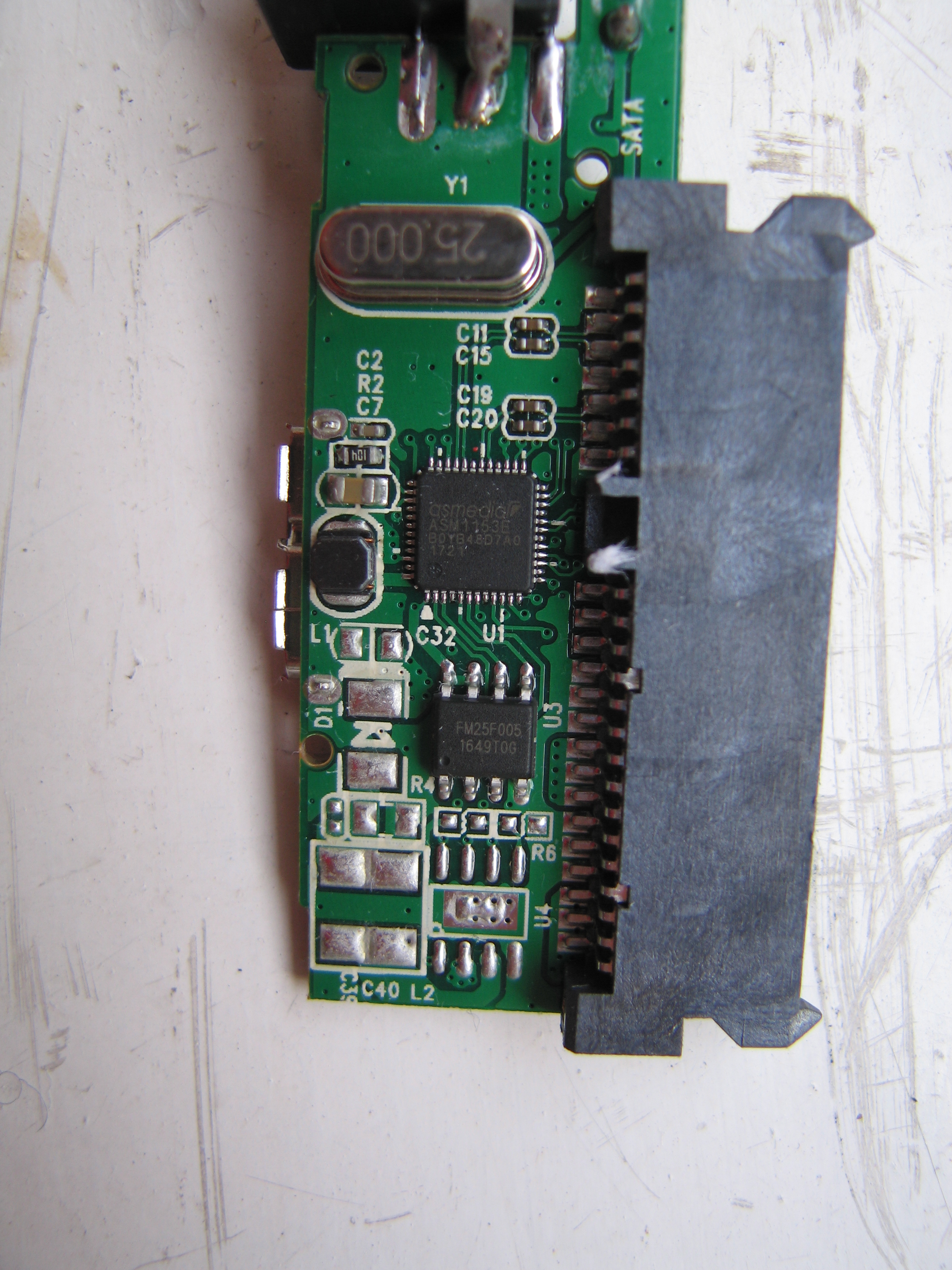

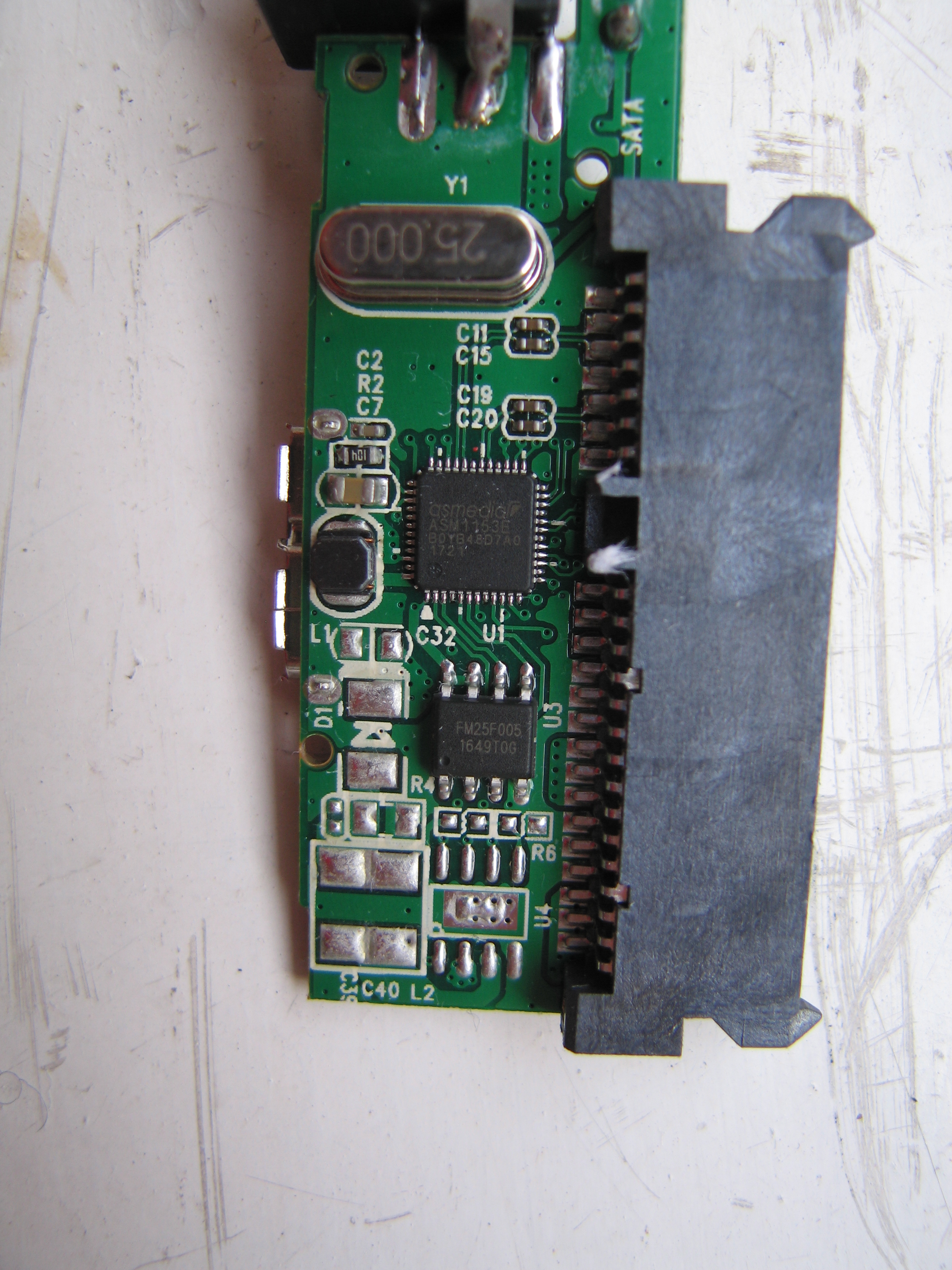

Vielleicht hast du zufällig unter den mehreren Gehäusen, die du gekauft hast, ein Gehäuse mit Norelys-Chipsatz gekauft, ansonsten hätte ich Orico 6518US3 Adapterplatinen, die ich vom Orico 6518US3 ausgebaut habe, und durch Fantec-PCB erstzt hatte, und nicht mehr zwingend bräuchte, eine könnte ich dir schenken und ggf. an eine DHL-Packstationsadresse schicken, damit es möglichst anonym bleibt (ggf. in PM besprechen) (das Gehäuse selber kostet/gabs mal bei ebay für 16€ aus China). Müsste es auch bei amazon geben.
Dort ist ein Norelys NS106X Chip verbaut, und das Norelys-MPTool bietet auch eine 512Byte oder eine 4096-(4K) Byte-Emulationseinstellung (Logisch-Emulation) zum Flashen der Firmware an.
Ich bevorzuge ein anderes Produkt mit z.B. ASM1153E statt der Orico nur wegen SSD-TRIM-Fähigkeit über USB, und für optische Laufwerke (mit USB-BOTP-Fimware), weil es auf der Orico mit NS106X Chipsatz bei SATA-ODDs bei der BD-Wiedergabe regelkmäßißgen Ruckel-Aussetzer gibt (nur bei der Widerhabe von Videos), bei der Fantec mit ASM1153E aber nicht..
Ansonsten funktioniert die Orico 6518USR tadellos, und reicht auch für deine Datenrettung völlig aus. :)
Du musst NICHT genau das gleiche Gehäuse nehmen, es muss nich der gleiche Chip sein, es kann auch ein anderer sein sein, es reicht wenn man auf 512 Byte oder 4096 Byte Blockemulation in der Gehäuse-Firmware umstellen kann. Die Orico 6518US3 z.B. kann laut Norelys-MP-Tool zwischen 512 Byte und 4096 Byte Emulation umgeschalten werden! :)

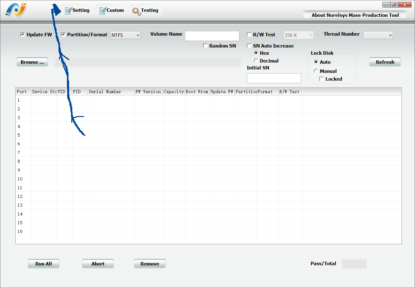

Ein Norelys-MPTool-Passwort ist nicht vorhanden, zum Freischalten aller Optionen (damit 4K- und 512 Byte Emueinstellugne) sichtbar: im Passwortfenster bei Password- nur Return auf OK drücken, (Ohne Password).
Die Firmware muss meines Wissens auch bei Norelys-Chips nochmals geflasht werden, sollte eine FW-Einstellung geändert werden.

Ich hab noch Orico-Platinen rumliegen, kann gerne eins verschenken oder ausleihen und vorher eine 4k- oder 512Byte-Emulationsfirmware flashen.

...da hatte ich gesehen, dass es im Norelys MP-Tool eine Option gäbe für 4096 Byte logische Emulation, und man diese Einstellung in einer Norelys-Firmware editieren und flashen kann.
Das hatte ich am Orico 6518US3 SATA-USB-Dock (Norelys NS106X) Chip mit Firmware 3.8.0.9 nun probiert.
Leider nachdem ich die Firmware mit dieser gesetzten 4K-EInstellung auf der Orico geflasht habe,
und nun eine HDD dockte mit 512 Byte pysikalisch / (´´512 Byte logisch),
trotzdem wird bei der HDD immernoch 512 Byte physisch/logisch angezeigt.
Eigentlich sollte jetzt bei der HDD im Dock 512Byte physisch und/ 4096Byte logisch anzeigen bzw. 4096Byte physisch+logisch.
Das ist leider NICHT der Fall. D.h. klappte der Gedanke mit dem Orico-Gehäuse und der 4K-Einstellung im Norelys-MP-Tool tatsächlich NICHT.

Villeicht klappt da die 4K-MP_Tool-Option im MP-Tool in diesen Firmwares eingestellt zu bekommen, sodass es bei gedockter HDD sich tatsächlich auswirke...

I'm a little confused about the different chipsets, PIDs and firmwares.
According with this website, for vendor 174c (asmedia) there are this PID:
55AA: ASM1051E, ASM1053E, ASM1153, ASM1153E
5136: ASM1053
5106: ASM1051
I have a Sharkook SATA Quick Port XT USB 3.0 with an ASM1051 (i have opened it) with PID: 55AA (firmware 100824009100 updated to 13022081F602), Can the same chipset exist with two different PIDs? on this list there are two ASM1051 with different PID:
VID: 174C, PID: 5106 ASMedia ASM1051
VID: 174C, PID: 55AA ASMedia ASM1051 new firmware (2)
In this same thread I have seen some user who has bricked their device when updating the firmware, supposedly for flashing an ASM1053E (¿PID: 55AA?) firmware in an ASM1053 (¿PID: 5136?) device, but then why in the first post the download link is for both chipsets¿?
"Aktuelle Firmware für Intenso Center :ASMedia.1053/1053E Support 8TB+ HDD."
it really only works for ASM1053E, right?
Thank you very much!!

@Mr.Anon
Many/some/a few of the firmwares MTechlerin provided (might be) outdated.
In case you'd use 4K-Emulation in firmware. E-g- afaik ASM1051/1053 has that on some firmwares, while on ASM1153E it's no longer offered, as not needed and making issues.
This usually makes just problems, when Swapping HDD into another USB case or to SATA and vise versa, for correct interpreting of the data, on different bridges with different emulation-settings.
If someone needed 4K-Emulation, recommended not by firmware (using HDDs own logical-sector size), and if needed to rescue the data, it's better to do it via software, e.g. in Linux via "losetup"-512e-to-4096Byte remapping.
See guide above post. For English speaking people, I hope google translate helps to understand the guide in post #153 better.
That over-2 TiByte just matters older BIOS PC, that BIOS cannot access all block addresses behind 2 TiBytes, which just understand MBR. From a a running operating system, even on older BIOS-PCs, you can still access all data from whole HDD, also behind 2 TiBytes (must use "GPT")
Yes TV-boxer/recorder boxes with outdated software, just knowing MBR-partition-table, might require 4K-Emulation to be able to make use of a full HDD bigger than 2 TibiByte (max up to 16 TiBiBytes) while still having MBR-table type.
PID "5136" might be in fact designated for ASM1053 or vise versa, and or by 3rd-party producer/seller who used for their sepcific product.
PID "5106": might be in fact designated for ASM1051 or vise versa, and/or by 3rd-party producer/seller who used for their sepcific product.
PID "55AA": I'm not 100% sure, if it was done intensionally to use for all them, ASM1051E, ASM1053E, ASM1153, ASM1153E.
All I know for Inateck and Fantec products I bought, which I checked they both having in fact the newer ASM1153(E), they both shows up as VID "174C" (for asmedia), PID "55AA"(ASM1153/ASM1153E)
ASM1153 (=SATA-3G) afaik is a bit older than 1153E (=SATA-6G) but both using same PID, and same firmware.
At least "55AA" is preset on the standardly delivered firmware from my Fantec and Inateck products with ASM1153E-chip, and standardly set in the Asmedia MPTool, on some zip-package where an Asmedia-MPtool is delivered with and the ASM1153/E-firmware.
I've also seen complaint's from Linux-Kernel developers, and/or from smartmontools, about broken UASP support, and UASP blacklisting for some specific older amedia chips (or just by too old firmware), that Asmedia and/or the supplier would use PID "55AA" for ASM1051/ASM1053 and ASM1153/ASM1153E, and Linux having issues what driver-settings to apply for which chips etc.
But as you found in the list, I'd then rather expect PID "5136"/"5106" was for the older generation ASM1053 and ASM1051, and PID "55AA" only for ASM1153/ASM1153E.

Dann noch eine neuere ASM1153/ASM1153E Firmware gefunden (bei statio-drivers.com), und getestet.
141126_A1_EE_82
https://www.station-drivers.com/ind...ory&Itemid=353&func=startdown&id=4053&lang=en
"fg66 2019-12-21 22:00:35 With this firmware, TRIM is working under Windows10 :-) "
HDD-Standby-Issue fixed , setzt HDD-eigene-Firmware-Einstellungen (zwar) außer Kraft, aber erzwingt, dass das APM (de)aktiviert wird. Getestet zeigt bei allen HDDs jetzt, auch bei welchen, die selber eigentlich "128" hätten, nun: APM= 254 (Maximum performance). Muss nochmals testen, aber schaltet auch bei Reboots des PCs die HDD auch nicht ab :)
Was zwar auch mit Firmware 131126_A1_00 auch klappt, welche aber kein SSD-TRIM kann, und (K)eine optischen Laufwerke unterstützt.
SSD-TRIM funktioniert auch damit, getestet. (141126_A1_EE_82)
Und Optische Laufwerke werden damit erkannt (141126_A1_EE_82), +UASP mit HDDs/SSDs,
die Firmware schaltet dabei automatisch in den USB-BOT-Modus um, wenn ein ATAPI-Laufwerk (CD/DVD/Blu-ray) angeschlossen wird.
UASP geht ja zusammen mit ATAPI nicht, (K)eine SATA-USB-Geräte, noch irgendwelche Werbung mir bekannt, die das können sollen.
Die ODD-Seriennummer mit (Scan_HDDSN=1 mit asm_mptool_vx.ini Flasheinstellung) wird hier durchgeschleift, allerdings wird der ODD-Modelname nicht durchgereicht, sondern da steht dann ASM1153/ASM1153E (was bei Product-String im MPool zur Darstellung des Productnamens nachm Flashen als Text eingestellt wurde) als Model drin, das gleiche bei angeschlossener HDD/SSD.
Mitgeliefert wird ein neuere Asmedia-MPtool-Version (EDIT für die Chipreihe ASM105X, ASM11xx, die bei usbdev.ru glaub noch fehlt, welche einen neu gestalteten Config-settings-Dialog erlaubt.

4K-emulation

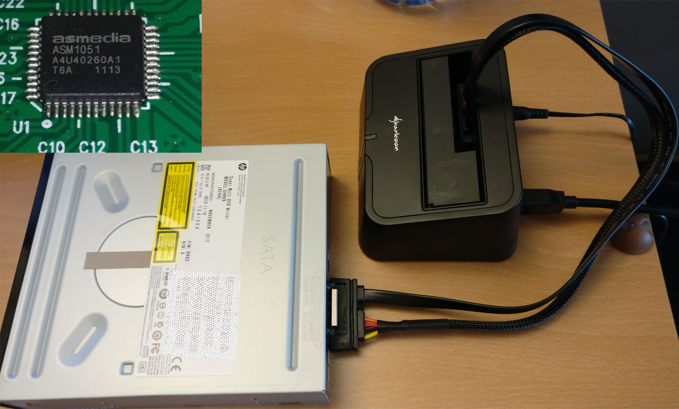

Yes, I am aware of this feature, In fact, i had a firmware with 4k-emulation in an ASM1051 and I changed it to another WITHOUT 4K.
PID
My Sharkoon SATA Quick Port XT USB 3.0 with an ASM1051, both before and after flashing a firmware from the sharkoon support, the PID is 55AA and not 5106.
Later I realized that it was the same firmware as "ASMedia.1051.No.Name.Device.7z" which can be found in the first post of this thread, and also comes with the PID 55AA in the preset file.
So, might be that ASM1153/E can still have same PID as ASM1051.

4K-emulation
Yes, as normally, this is a good/advisable choice! :)

I had bought an Inateck UA1001 myself. It has ASM1153E chip and Fudan FM25F005 EEPROM (64 KibiBytes SPI/EEPROM size).
Inateck UA1001 Standard predelivered-firmware 141126_A1_E(8)_(20)

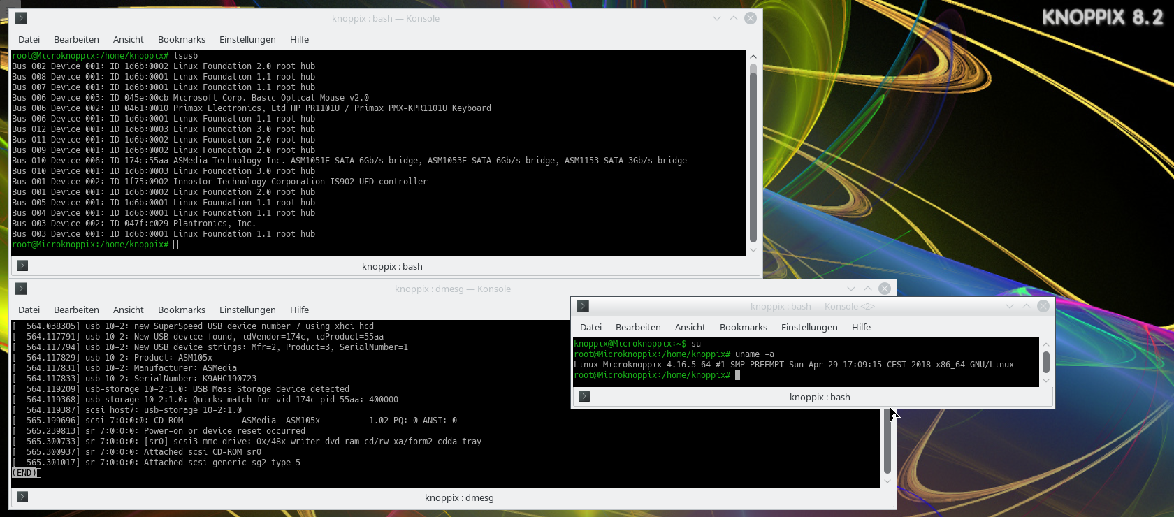

With ODD docked (Linux): Inateck seems to have set "ASM105X" as product setting flashed with the standard-firmware , which is irritating, because the chip at least on my Inateck UA1001 is ASM1153E. (The called product string, you have set in MPTool, and what VID/PID is principailly irrelevant which matters firmware-compatibility tot he hardware-chip, just that the taken firmware for the declared chip is correct), at least my UA1001 needs anASM1153/E firmware (it was just preflashed with a 105X product string name setting, which is just a cosmeticic thing in this case)

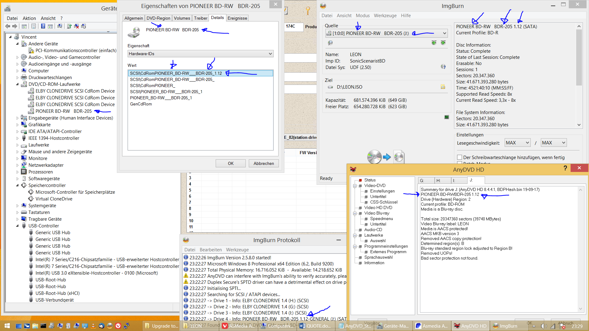

Another example, in „Makemkv“/“AnyDVD“ ripping and ImgBurn/Burning etc software, e.g. if you had several ODDs connected via USB, it might be irritating if you have several Optical disc drives connected at the same time, to find out which drive letter was for which currently connected ODD-models, where which named inserted movie disc it was, and in the AnyDVD.ziplog (if having problems) e.g. ripping DVD/BD with AnyDVD and asking the Redfox-developer staff for help with your bought BD/DVD/movie discs (as personal backup of course), the presented "ASM1153E USB device" will be included into the "AnyDVD.ziplog", instead oft the model-text oft he docked ODD-model, so the RedFox developers can’t see from the AnyDVD-status-bar nor AnyDVD-.ziplog, which ODD-model, you used with the certain DVD/BD/UHD-BD-disc you are giving them reports having issues with.
141126_A1_EE_82_ODD_(CD-DVD-BD)-working_-but_but_NO-model-name-passthorugh_NO-(ODD-SN)-passthr...PNG
141126_A1_EE_82_ODD_(CD-DVD-BD)-working_-AnyDVD-ziplog-NO-model-name-passthorugh_NO-(ODD-SN)-p...PNG
[Edit]
Rechecked. Yes the ODD-model-name is also NOT seen by AnyDVD nor ImgBurn nor MakeMKV in Windows, nor anywhere in Windows-Device manager (as e.g. „ASM1153E“ product-string, if that what you have set)
https://makemkv.com/forum/viewtopic.php?f=16&t=18933&sid=b738b6a328d7de3a894bf303d6040fe1
NEW OPTION: 'UHD Friendly' Firmware Downgrade / Cross-Flash Using Official (Modified) ASUS Flasher for ASUS & LG Drives
https://forum.redfox.bz/threads/downgrade-uhd-drives-to-friendly-the-easy-and-safe-way.76551/
Anyway, even though the ODD model name is not passed through by firmware 141126_A1_E{E}{82} for ASM1153E, the ODD support of firmware "141126_A1_E{E}{82}" also includes usability of the "patched Asus/LG flashers" from Mike (MartyMcNuts) via USB, flashing UHD-friendly and/or LibreDrive-enabled-firmware from Downgrade-enabled-firmware and/or mk-firmware-pack on certain LG/Asus/ (NS50/NS55 compatible UHD-BD-drives) (BH16NS40 (NS50), LG BH16NS55, Asus BW-16D1HT (2015+), LG WH16NS60, etc.),...
(Updating Asus BW-16D1HT (Apr. 2017 =2015+ <=NS55 compatible ) UHD BD-unit 3.01 Original BW-16D1HT-to "Asus BW-16D1HT 3.10 MK"-firmware (edited by Mike MakeMKV) via SATA-USB-adapter (ASM1153E firmware 141126_A1_EE_82) via USB...
...even though the ODD-model-name is not passed through, Asus BW-16D1HT 3.01 unit listed as "ASM1153E" 3.01 (Asus BW-16D1HT FW 3.01) , updating it to "BW-16D1HT 3.10 mk"
but the user has to take attention having connected correct ODD unit, especially here with just "ASM1153E" shown, and not to confuse especially here, when other units attached etc.), and 3.01/3.10 is NOT belonging to the Asmedia chip, but to the Asus BW-16D1HT ODD drive.
ASM1153E_141126_A1_EE_82_Mike-MartyMcNuts_Patched-LG-Asus_Flashers_over_USB-also_working.PNG
ASM1153E_141126_A1_EE_82_Mike-MartyMcNuts_Patched-LG-Asus_Flashers_over_USB-also_working.2.PNG
After updating the Asus BW-16D1HT BD-UHD unit's firmware from 3.01 to "3.10 mk" via USB, it's still working, also in MakeMKV, shown as 3.10, and now with "LibreDrive" Enabled... :)
ASM1153E_141126_A1_EE_82_-after_flashing_via_USB_-Asus_BW16D1HT_to_3.10-mk_-working.PNG

In the MPTool 2.1.21.5 DBG (DBG=debug?), in the (More Config +) button I have noticed besides a „HDDSN“ firmware-flash-setting-checkbox a „WHCK“ and „QD32“ checkbox.
[Edit]
Tried different MPTool-settings and combinations, also WHCK and QD32, but there’s still no ODD/ SSD/HDD model-name passthrough.
WHCK has something to do with Windows Driver signing according to wikipedia.
And „QD32=1“ means Queue Depth, (enabling max up to 32 Commands per Queue) via SCSI/UASP over USB, for e.g. SSD/HDD Native command queing (SATA AHCI Mode: Max. „1“ Queue, and 32 Commands per Queue – while nVME (for PCIe SSDs) supports 65535 Queues and 65536 Commands per Queue)
So QD32=1 setting (=>Queue Depth=“32“ =On) might increase random/IO-performance for the docked SATA device (SSD/HDD), and should have identical Queuing depth like SATA-ACHI (attached directly to SATA)...
...(but not for ODDs, as for ODDs just USB-BOTP possible, and USB-BOTP does not have command queing/channel parallelism) on the SATA-USB-adapter over USBl
(+ It's recommended having Write-cache enabled also for the SSD/Hard disc drive via USB in the Windows-Device manager under "Drives"-Section, if you want .e.g. noticbly 3rd-times higher speed here on USB 3.0, but has more risk if you're forgetting safely-remove, because it might buffer/sort data into into SSD/HDD-cache not attempting to write all always at once.
The inlcuded MPTool together with the „141126_A1_E{E}_{82}“ firmware might have as a preset s.th. like this „Ugreen storage" by standard. I have changed the text to „ASM1153E“ (without quotation marks) in the product string bar, before flashing this firmware, so that it reports as ASM1153E instead of „Ugreen…“ named device.

Dann würde ich noch testen, ob optische Laufwerke (DVD/Blu-Ray) von der Firmwar 140704_A1_A9_02 unterstützt werden. Einfach ODD an SATA ran tun und schauen ob es über USB unter Windows erkannt wird im Gerätemanager bei CD-/DVD-/Laufwerke auftaucht:
->Start ->Alle Apps ->Windows-System
->Systemsteuerung (Control Panel)
Rechts-oben Kategorie-Ansicht (Große Symbole) wechseln
->Geräte-Manager (Device-Manager) (ist mehr so'n durchgängig gräuliches Symbol wo das steht und draufklickst)
->CD-/DVD-Laufwerke: Testen ob ODD erkannt wird: Wird das ODD angezeigt?
Was bringt der Flash auf FW 141126_A1_EE_82?
HDD-Standby-Proboleme gelöst, vor allem für HDDs mit Haggressiven HDD-Firmware-Standby-timern, ganz extrem bei 2.5" Laptop-HDDs (HDD nacch letzer Aktivität schon nach 8 Sekunden in den Standby !!): Ein Beispiel: Western Digital WD Blue 2,5 Zoll WD10JPVX (1TB).
Die "141126_A1_EE_82" unterbindet diese Problematik :)
UASP geht, TRIM klappt damit auch mit der der "141126_A1_EE_82",
Optische Laufwerke gehen. Alle anderen Firmwares, die ich probiert habe, können keine ODDs, wenn sie UASP für SSD/HDDs haben.
Von den vielen Firmwares, die ich probiert habe, kenne ich nur drei Versionen die TRIM können:

Um zu testen, dass UASP geht, 4 Bedingungen:
Der USB-Host-Controller muss UASP können, Der USB-Host-Controller-Treiber muss UASP haben, das Bteriebsystem muss UASP unterstützen, der USB-Bridge-Chip und dessen Firmware muss UASP können.
Im MPTool im Config_Setting dialog steht z.B. ob bei einer bereits geflashten Firmware UASP aktiviert wird ("UASP=Yes"). allerdings sieht man das erst im MPTool-Firmware-COnfig-Fenster erst, wenn die Firmware schon drauf geflasht ist.
Neben der Methode im MPtool nachzuschauen, ob die und die Firmware UASP kann, allerdings muss auch hier die Firmware schon geflasht sein, geht das auch so: (Minimum ab Win 8.1, und aufwärts erforderlich):
Bitte nun SSD oder Festplatte (bitte NICHT ODD!) an SATA-Port der Inateck docken, und SATA-USB-Adapter per USB an PC anschließen
Nun Geräte-Manager sollte ein neuer Eintrag, gar 2 neue auftauchen (wenn UASP an ist):
->Laufwerke
Bei ->Laufwerke muss bei der erkannten SSD/HDD "...SCSI Disk Device" dahinter stehen , wenn UASP aktiv ist.
Es müsste noch ein 2. Eintrag erscheinen: Bei ->Speichercontroller müsste noch ein Eintrag auftauchen: ->"Per USB angeschlossenes SCSI-(UAS)-Massenspeichergerät"
Rechtsklick auf: ->"Per USB angeschlossenes SCSI-(UAS)-Massenspeichergerät"
=>Eigenschaften: ->Details: ->Hardware-IDs : müsste ..."VEN_174C" (Vendor-ID für "Asmedia" und "DEV_55AA" (Device-/Product-ID: für ASM1153/ASM1153E Bridge Chip)vermerkt sein
Wenn du das bei gedockter SSD/HDD findest, dann ist UASP in der FW aktiviert.
hi again @Vincent
I have two more questions for you, in case you can help me one more time.
1) These days I bought a sata extension thinking that the optical drives would work in my dock Sharkoon SATA QUICK PORT XT USB 3.0 with ASMedia ASM1051 but it seems that it is not, is there any solution or is that chipset incompatible?
This screenshot is after flash the firmware 130220_81_F6_02 (provided by sharkoon) to get rid off 4k emulation, since it does not support UASP I thought that the optical drives (ODD) would work, but it is not. Do you know if there is any firmware that supports ODD for this chipset (and NO 4k emulation for HDDs)?
I must say that the same extension cable with the same DVD unit works fine on a Inateck UA1001 with ASMedia ASM1153E and stock firmware 141126a1e820
2) I´m thinking on update my Inateck UA1001 with ASMedia ASM1153E and stock firmware 141126_A1_E8_20 to firmware version 141126_A1_EE_82 to have UASP support for HDD and without losing ODD support via USB-OTP.
I have downloaded this file: asmedia_ASM1153E_ 141126_A1_EE_82(station-drivers.com).zip
But I don't know if the version of MPTool (2.1.21.5 ¿DeBuG?) is the recommended and the includded as_mp_Tool v0.3.ini configuration is correct or not¿?
I have seen that there is a newer version on usbdev.ru (Asmedia ASM1051 MP Tool v3.6.3.0 with ini v0.5), could you tell me which version I should use and exactly what ini configuration is the best for this firmware and chipset?
thank you very much!!!

One thing you could try out, saw this on a WDMY Book 8TB, which had SATA-pin-3 from the SATA-15-pin-power-plug (turned SATA-Pins visible from upper side, the 3rd pin from the left near to the L-angle), https://upload.wikimedia.org/wikipedia/commons/7/7c/SATA_Ports.jpg
Pin3-DevSleep to beactivated on some HDD-firmwares: E.g. from quantity of five WD my Book 8TB USB 3.0 products, with SATA internal HDD, three of them had DevSleep enabled, while the other two have not. covering Pin 3 DevSleep 3.3v on the 15-pin connector, made HDD getting work at PSU. Without insulating pin-3 on the 15pin-plug, HDD did not power on at all.
Maybe this trick works also on ODDs, with that pin3 covering with isolation tape over the pin 3, e.g. with duck-tape (very tiny piece),(covering it the SATA-15-pin-male connector on the SATA-device), on 15-pin the 3rd pin from the left near to the L-angle
How to Fix the 3.3V Pin Issue in White Label Disks Shucked from Western Digital 8TB Easystore Drives
"In this video, I show you a Western Digital 8TB Easystore drive that has been shucked. Due to a new SATA specification that allows a 3.3V over the third pin of the power connector to disable the drive, the white label 8TB disk may not work with certain power supplies. I show the symptom and the cause, and I demonstrate two solutions - one using Kapton tape and the other using a Molex-to-SATA power adapter. Warning: some Molex-to-SATA adapters have been known to catch fire! Please do your research before using the solution at 4:03. "
But this will probably/might not help, and afaik the HDD samples that used that 3.3V Devsleep, that din'tn work on PSU without covering Pin3, functioned on a SATA-USB-adapter case without covering Pin 3 anyway (tested with ASM1153E product)
So this will probably not help, as your ODD is not working on adapter (using as bypassing 3.3V), unless some ODDs used 3.3V DevSleep-pin, (which afaik they wouldn't - not sure), and only if your ASM105X adapter supported that 3,3 feature, too, like many PC-ATX-PSUs do, only then covering Pin3 would perhaps help
But another thing first to try out:
It seems more complicated with ASM1051/1053 as there are much more firmwares released compared to ASm1153/E, so much more to try out. Anyway I found one with ...CDROM..." in filename, so it might support ODDs, but I'm not certain if "100118_00_0A_09_CDROM.bin" doesn't use the disturbing 4k emulation. (I haven't bought ASM105X products to test)
https://www.usbdev.ru/files/asmedia/asmt2105firmware/
Asmedia ASMT-2105 Firmware (ASM1051, ASM1053)
==>http://www.usbdev.ru/?wpfb_dl=4998
Firmware ASMT-2105 [100118_00_0A_09_CDROM.bin] ; 100118_00_0A_09_CDROM.rar; size: 10 337 bytes
Afaik you can use "100118_00_0A_09_CDROM.bin" on MPTool, you took, that you know that worked with your ASM105X product: https://www.usbdev.ru/files/asmedia/asm105mptool/
First check in the MPTool in as_mptool_vx.ini", that in the .ini the VID and PID match to the VID and PID, that is reported in the MPTool-status window of your detected ASM105X.
The MPTools/firmware packages for ASM105X, MTechlerin provided in start post, should be matching one for your ASM105x to flash firmware "100118_00_0A_09_CDROM.bin".
Firmware "100118_00_0A_09_CDROM.bin" copied into MPtool directory, and in "as_mptool_0.x.ini" firmware path adapted.
Yes I've done that myself with SATA-7pin+15pin-(F.->M.)-extension cables, which worked for me, as for you as well at least with the ASM1153/E products.

Yes I'd use the included MPTool "MPTool 2.1.21.5 ¿DeBuG" from "asmedia_ASM1153E_ 141126_A1_EE_82(station-drivers.com).zip. Its .ini is specialised to the ASM1153/E and certainly goes perfectly for this firmware.
Afaik 3.6.3.0 is for ASM1351, so for newer chips than ASM1153E. There are some addional parameter-lines in its ini one some 3.6.30 packages, which don't work for ASM1153E, which don't exist on lower Asmedia-MPtool-Versions.
Just out of interest, I had tested a bit fashing firmware with that 3.6.3.0 version on ASM1153/E, but got a failed flash once and/or it rejected to flash, and so tested removing some incompatible parameter-lines and/or using "as_mp_Tool v0.3.ini" from an ASM1153/E firmware packages from included 2.1.20 MPTool, which made it work on 3.6.3.0.
But I wouldn't take the risk, it won't give you any advantage at all.
Just take the "MPTool 2.1.21.5 ¿DeBuG" from "asmedia_ASM1153E_ 141126_A1_EE_82(station-drivers.com).zip. I have used that, too, on flashing "141126_A1_EE_82". Its config is adapted on to work on ASM1153E, and goes well. :)
And MPTool 2.1.21.5 ¿DeBuG" is with(out) MPTool-password.
So you don't need to type in any "asmedia" password, the other MPTool-versions use. :)
If you want SSD/HDD/ODD_SN-passthrough activated, before the flashing firmware,
first please open "...\asmedia_ASM1153E_ 141126_A1_EE_82(station-drivers.com)\Upgrade tools\as_mp_Tool v0.3.ini"
in editor/notepad,
and edit the line:
Code:
Scan_HDDSN=0
to
Code:
Scan_HDDSN=1
You'd also change the path in the ini to the location where you have extracted the zip, so that MPTool finds the firmware-file:
from this:
Code:
fw_binary_name=C:\Users\Administrator\Desktop\ASM1153E Tools for Turning off Sleep Mode\Software\141126_A1_EE_82.bin
to
(e.g. if you have downloaded "asmedia_ASM1153E_ 141126_A1_EE_82(station-drivers.com).zip into directory
(example) "E:\Kit\Asmedia\ASM1153x\",
and extracted the zip to "E:\Kit\Asmedia\ASM1153x\asmedia_ASM1153E_ 141126_A1_EE_82(station-drivers.com)"
Example (you download and extraction direcotry might differ)
Code:
fw_binary_name=E:\Kit\Asmedia\ASM1153x\asmedia_ASM1153E_ 141126_A1_EE_82(station-drivers.com)\Software\141126_A1_EE_82.bin
Keep in mind, Asmedia MPTools have issues with firmware files in in too long file-paths (even in paths with below 255 digits) and it does not support UNC-networking paths)
Be careful to leave original new-line break in tact. Also sometimes when the MPTool-windows is minimized (to be smaller), sometimes it appears like that there was a line break, but it's not really the case, so when maximizing windows, there's not a line break in place actually.
When the line is long, eg. firnware path is longer,e.g. with minimized MPTool windows it looks as it was 2 lines, but it's not actually (as intended).
And this lines, I'd recommend to edit (is not too meaningful, just cosmetical)
from:
Code:
manufacturer_string=Ugreen
product_string=Ugreen Storage Device
to
Code:
manufacturer_string=asmedia
You can choose anything you'd like as name, e.g. Inateck as manufacturer_string and product string eg. UA1001 etc.
The rest of original parameters from "as_mp_Tool v0.3.ini " I'd leave in place, not to change.
