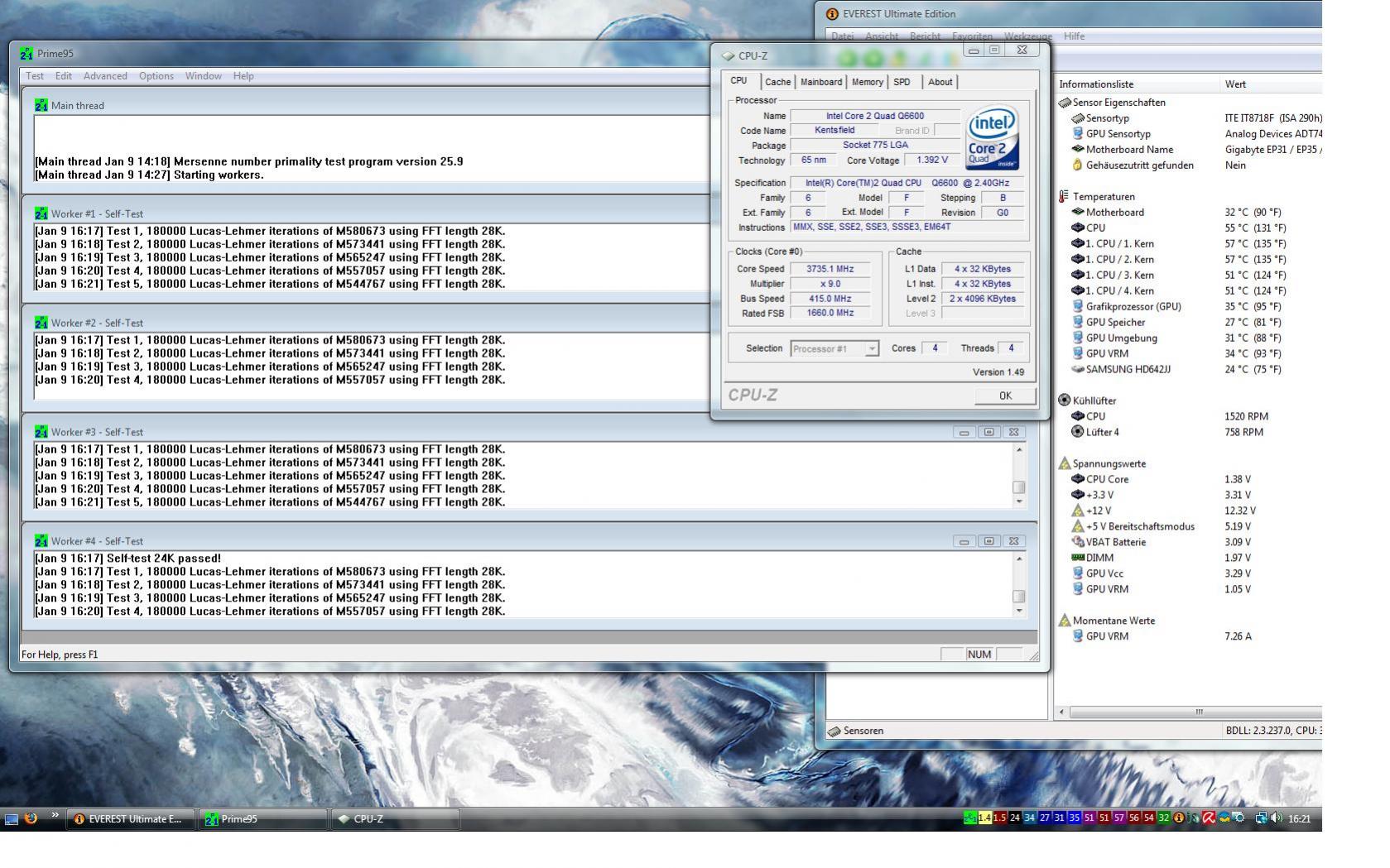

Q6600 @ 3.735 MHz @ 1.39 Volt (VID = 1.2375 Volt).
Kerntemps maximal 57 Grad Celsius.
