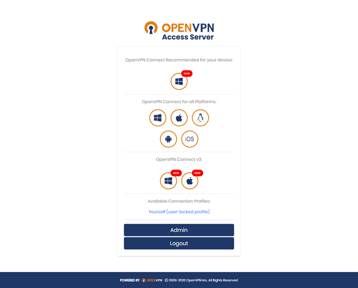

Am Ende, wenn alles per WebGui konfiguriert ist, macht man das hier:
OpenVPN Connect​
OpenVPN Connect is available for your end users and devices from your preferred web browser by navigating to the Client UI URL. This typically, https://[IPaddress]:943/. Make sure to replace [IPaddress] with the specific IP of your server.
When users log in to your Client UI, they’ll have the option to download the Connect app of their choice or a connection profile (client.ovpn), which can be imported into a VPN client. You may also download the Connect client directly, then enter the Client UI URL into the app to import the profile after authenticating with your credentials.
Dann ruft mal die URL des OpenVPN Servers auf, loggt sich mit den dort hinterlegten User Credentials ein, lädt sich den gewünschten Client runter, installieren, fertig.
