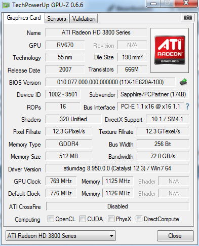

PS: Hier mein GPU-Z Screen: http://gpuz.techpowerup.com/13/08/03/8h4.png
