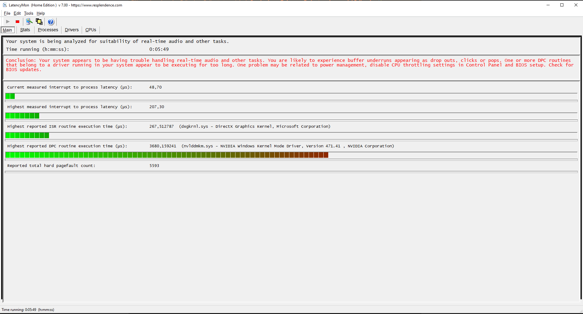

Was soll ich den deiner Meinung Nach tuhen, andere Grafikkarte kaufen ist schlecht ist alles zu teuer grad...
Ich kann die RTX2070 super nochmal wechseln lassen hab da noch Garantie drauf.
Conclusion: Your system appears to be having trouble handling real-time audio and other tasks. You are likely to experience buffer underruns appearing as drop outs, clicks or pops. One or more DPC routines that belong to a driver running in your system appear to be executing for too long. One problem may be related to power management, disable CPU throttling settings in Control Panel and BIOS setup. Check for BIOS updates.
Das steht da.
