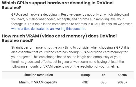

Hardware Recommendations for DaVinci Resolve:
oder hier: The Best GPU for DaVinci Resolve in 2021
