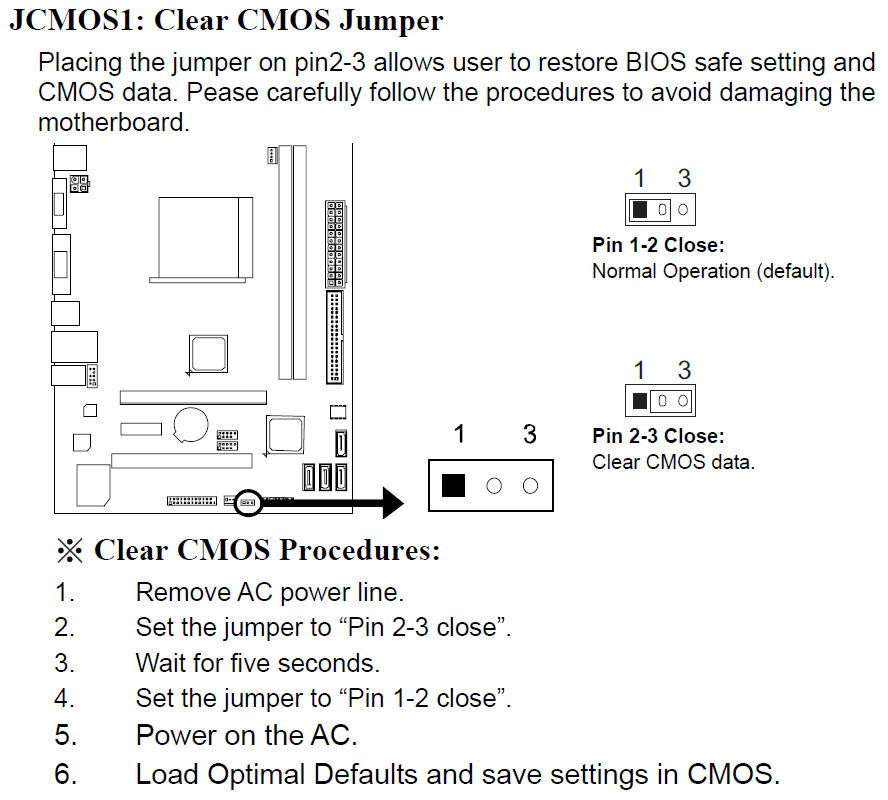

Try to clear the CMOS on your mainboard.
Please find attached a cutout of your mainboard manual.
815405

You could try resetting your BIOS / clearing your CMOS and give it another go, crosstesting the different RAM modules.
