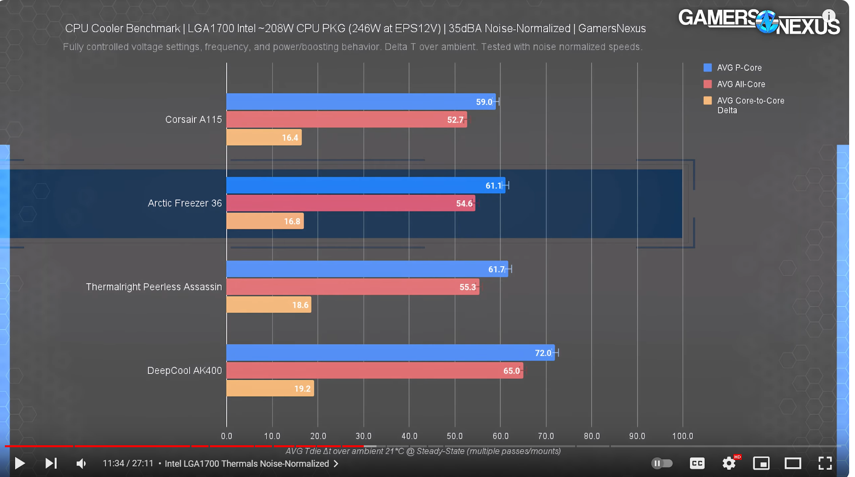

Nicht unbedingt:
https://www.club386.com/arctic-freezer-36-review-a-chilly-air-cooler-with-the-hottest-price/
https://www.computerbase.de/forum/attachments/1710617872248-png.1465487/
Reaktionen: coxon
