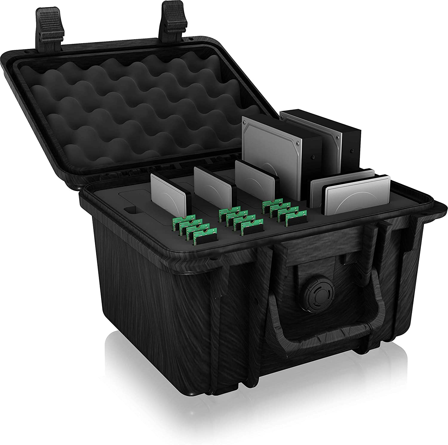

Mit oder ohne Gehäuse?Selter schrieb:ich würde gern eine Backup-Festplatte
Ohne:
- ICY BOX Festplatten Koffer IB-AC627
# - Schutzbox | Yottamaster B3-BK-EU
- Schutzbox | ORICO PHX-5S-GY

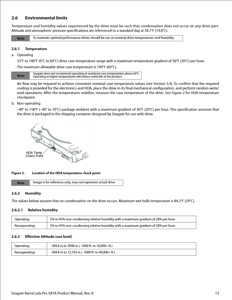

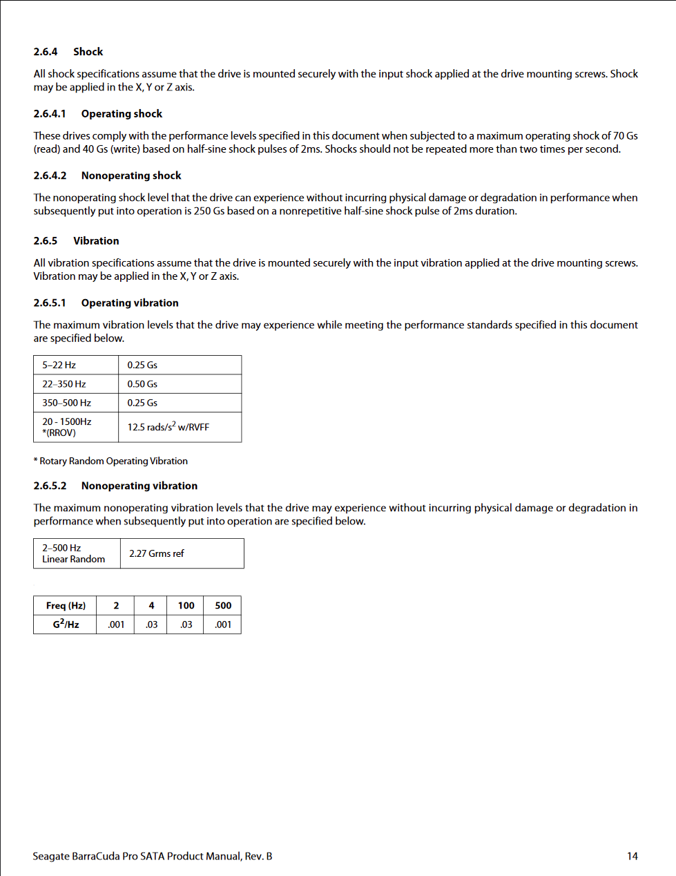

Zur Lagerung - es sind um die drei Monate:
Product Manual Seagate Kinetic HDD
Barracuda Pro SATA Product Manual
2.6 Environmental limits
2.5 ENVIRONMENTAL LIMITS
The recommended storage period:
- 1 year under controlled conditions of 34°C 90%RH or less
- 90 days in uncontrolled storage conditions
2.13 PRODUCT WARRANTY
Storage
The maximum recommended storage period for the drive in a non-operational environment is 90 days. Drives should bestored in the original unopened Seagate shipping packaging whenever possible. Once the drive is removed from theSeagate original packaging the recommended maximum period between drive operation cycles is 30 days. During anystorage period the drive non-operational temperature, humidity, wet bulb, atmospheric conditions, shock, vibration,magnetic and electrical field specifications should be followed.
2.10.2 Storage
Maximum storage periods are 180 days within original unopened Seagate shipping package or 60 days unpackaged within the defined non-operating limits (refer to environmental section in this manual). Storage can be extended to 1 year packaged or unpackaged under optimal environmental conditions (25°C, <40% relative humidity non-condensing, and non-corrosiveenvironment). During any storage period the drive non-operational temperature, humidity, wet bulb, atmospheric conditions, shock, vibration, magnetic and electrical field specifications should be followed.
