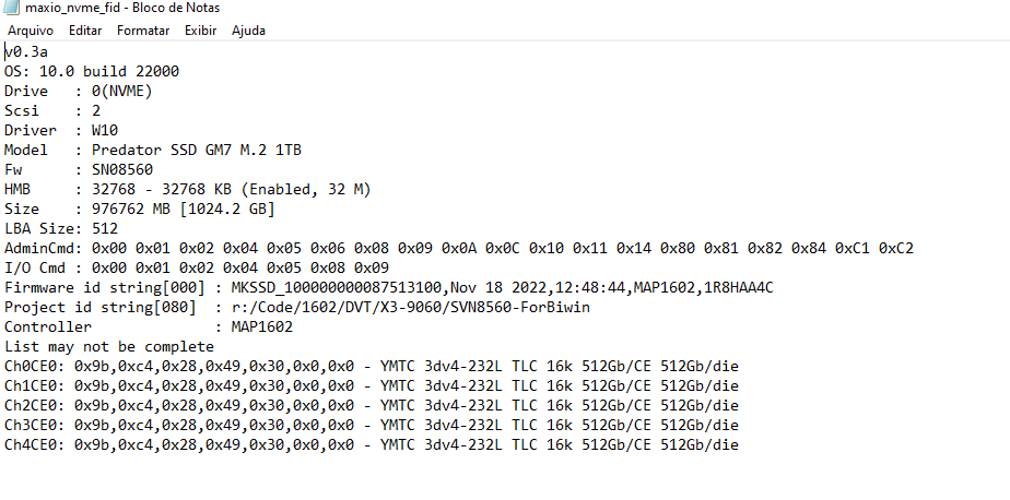

Great SSD, actually i was speaking with VLO himself and look what we found out:
Its very confusing i'm trying to help him figure out what's happening but YMTC CDT2B,1st revision of 128-L using a 1x4 plane layout as we'll see below, and this appears to be CDT2A which uses a 2x2 plane layout increasing efficiency .
I think it would be weird to run these "1200 MT/s" dies as 2400 MT/s, would decrease endurance byt a LOT, not even mentioning the signal integrity

Strange. And the Tool says 232 Layers. What is wrong? How does this tool even recognize which NAND is used?
Reaktionen: GabrielFerrazTP
MichaG schrieb:
strange. And the tool says 232 layers. What's wrong? How does this tool even recognize which NAND is used?

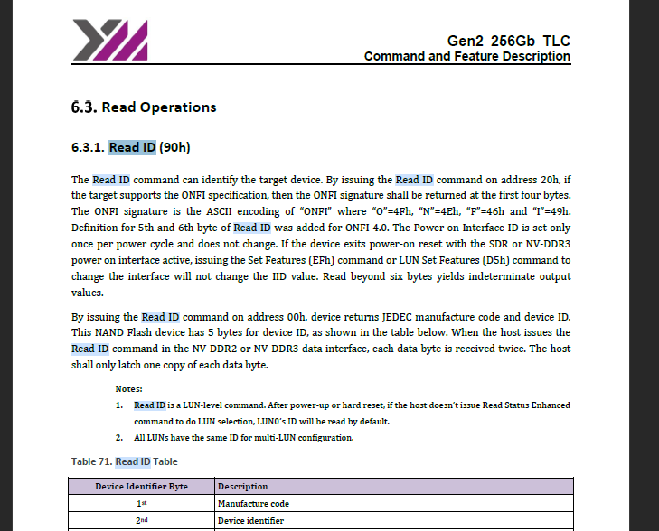

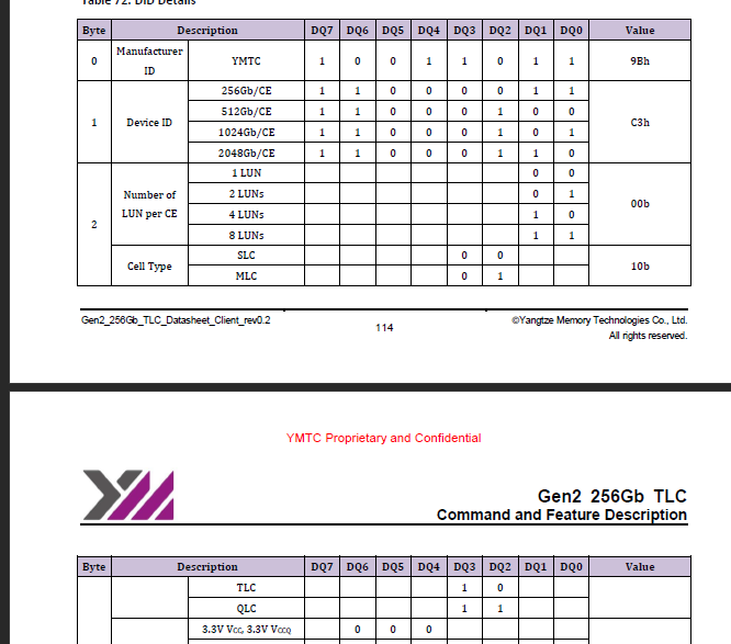

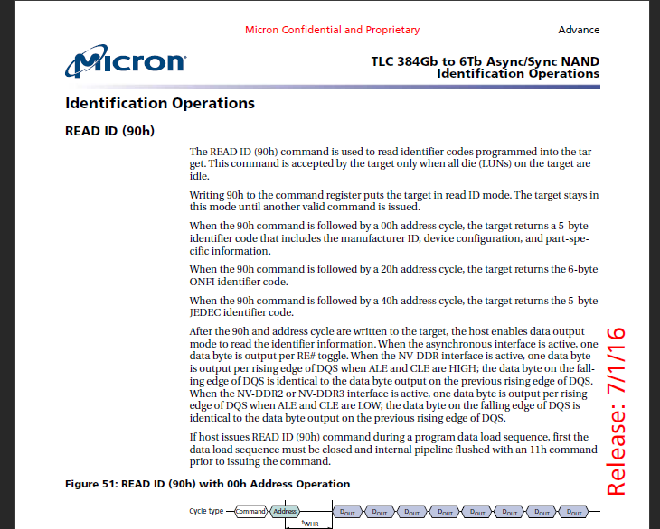

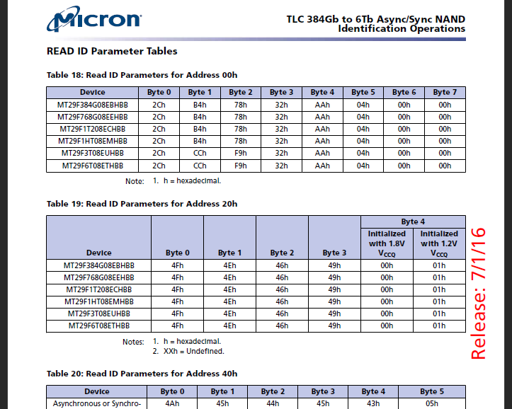

In order to recognize the Dies itself the "perfect world" solution would be to have the datasheet in hands, for example, check out this datasheet from micron, it's their "BOKB die" also know as 384Gb 32-Layer TLC
We use the Read ID parameters to get the Flash information, in this example its "READ ID (90h) as follows

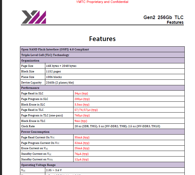

For YMTC i have a datasheet only for their 256Gb 64-Layer TLC die
