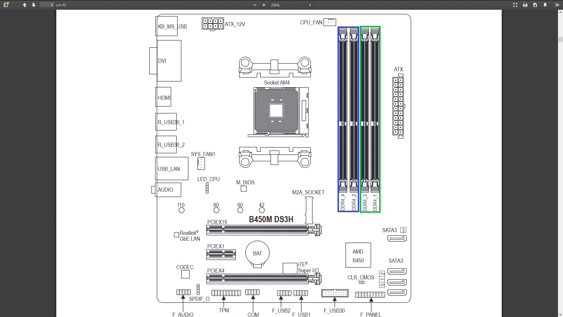

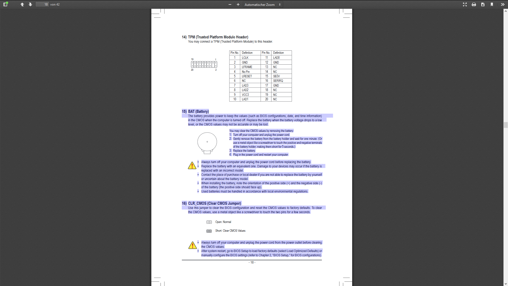

Dual Channel Memory Configuration
This motherboard provides four memory sockets and supports Dual Channel Technology. After the memory is installed, the BIOS will automatically detect the specifications and capacity of the memory. Enabling Dual Channel memory mode will double the original memory bandwidth.The four memory sockets are divided into two channels and each channel has two memory sockets as following:
Channel A: DDR4_2, DDR4_4
Channel B: DDR4_1, DDR4_3
Reaktionen: BFF

Bitte BIOS reset per Dip Schalter durchführen.
Das Mobo muss den RAM in Kombination ggf. mit der CPU neu erkennen müssen.

BIOS reset ohne Kabel 5min ohne Batterie brachte keine Verbesserung.
Per jumper kahm zumindest das pipen wieder. 1xlang
