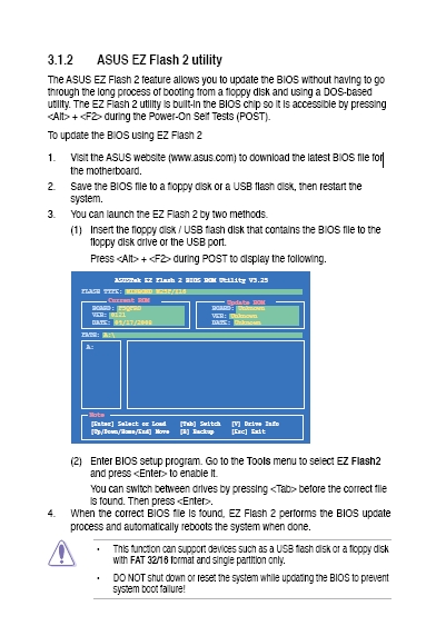

Ist im Handbuch sehr gut beschrieben. Siehe Bild.
Hier bekommst das neuste Bios: http://support.asus.com/download/download.aspx?SLanguage=en-us&model=P5Q%20PRO
-> P5Q PRO BIOS 1306

1. Visit the Asus website to download the latest IOS file for the motherboard.
2. Save the BIOS file to a USB flash disk, then restart the system.
3. You can launch the EZ Flash 2 by two methods.
- Insert USB flash disk that contains the BIOS file to the USB port.
Press<Alt> + <F2> during POST to display the following.
- Enter Bios setup programm. Go to the TOOLS menu to select EZ FLASH 2 and press <Enter> to enable it. You can switch between drives by pressing <Tab> before the orrect file is found. Then press <Enter>
4. When the correct BIOS file is found, EZ Flash 2 performs the BIOS update process and automatically reboots the system when done.
