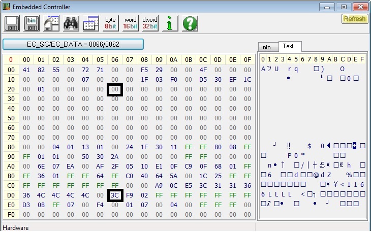

First of all I'd like to thank author of this software, since after one week of studying and two days of testing it's proving to work.
I'm using HP Probook 4520s with currently F.20 BIOS installed.
Based on information that I studied in the net it's pretty shitty configuration as well as version F.21 where OEM restricted all the access to the fan controls.
And maybe this is the reason why NoteBook FanControl doesn't have config file for it.
Before finding this software I did study of my DSDT and found no information on fan control in there, none of the sofware like SpeedFan, etc. worked for this laptop.
Observations:
But following NBFC manual and using Read and Write tool I was able to identify only one register (offset 214 cell D0/06) which seems to control fan speed. Register with offset 38 (cell 20/06) showing CPU temperature.
During loading and unloading CPU its (offset 214) values were changing from 00 to 64 meaning from 0% to 100% of fan speed.
NBFC adjustments
1. Chose HP Probook config supplied with software (in my case HP 4530s).
2. Changed EC poll interval to 800-1000ms (cause after changing the value of 214 offset it tends to be overridden by some default "BIOS values") you have to write very often to the EC register.
3. In Fan Configuration tab I changed Write and Read registers to the 214 for both.
4. Adjusted temperature thresholds as I liked it.
And it did a trick, now for the second day my laptop is running quietly.
I understand that it might be not the best adjustment and may cause some problems in future, but this is the only solution which worked in a very long time I'm trying to silence my fan.
I hope that you can also have a look on my RW data and suggest some additional solutions.
