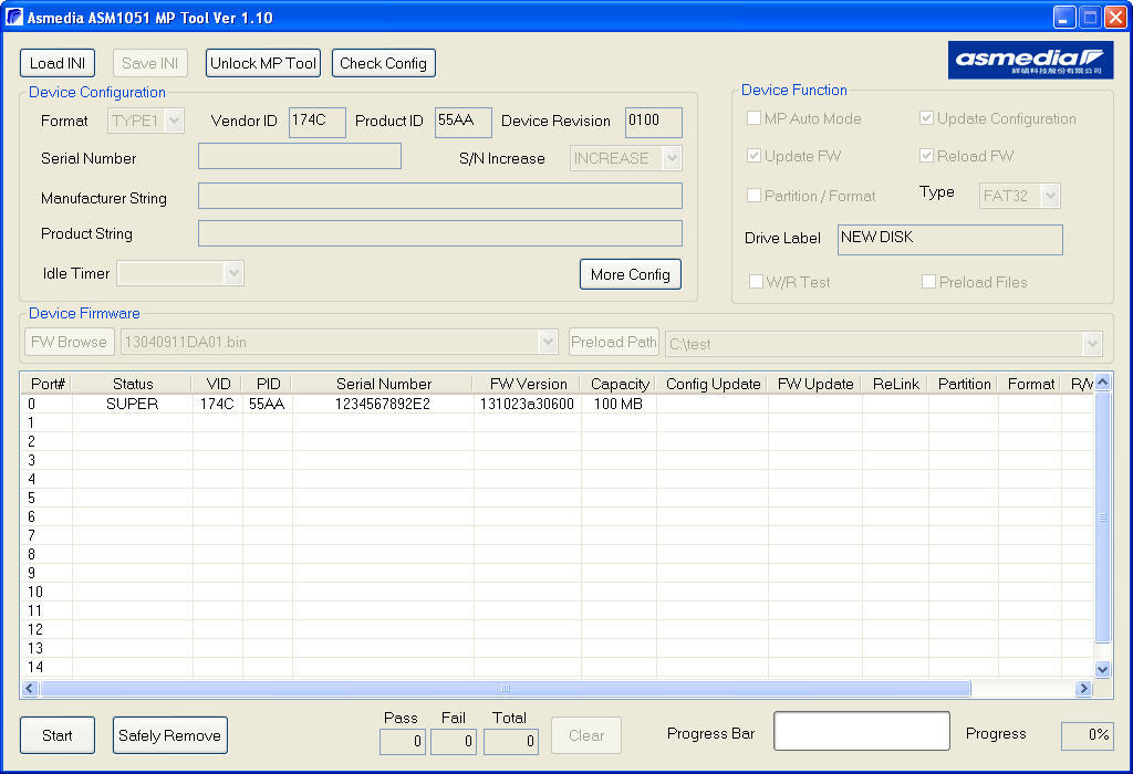

CnMemory Spaceloop
Kontroller: ASMedia 1053
EEPROM: 25Q512T
Es wurde geflasht:
- unter Windows 10 und Windows 7
- durch USB 2.0 und USB 3.0
- mit und ohne Festplatte
- mit MPTool 2.1.20.1, MPTool 2.0.2, MPTool 1.10
- mit 3 Computer
- mit allen verfügbaren Firmwares für ASM1053
MPTool 2.1.20.1 zeigt FAIL
MPTool 2.0.2, MPTool 1.10 zeigen PASS aber bleibt 110922110000
Hat jemand noch eine Lösung? :p

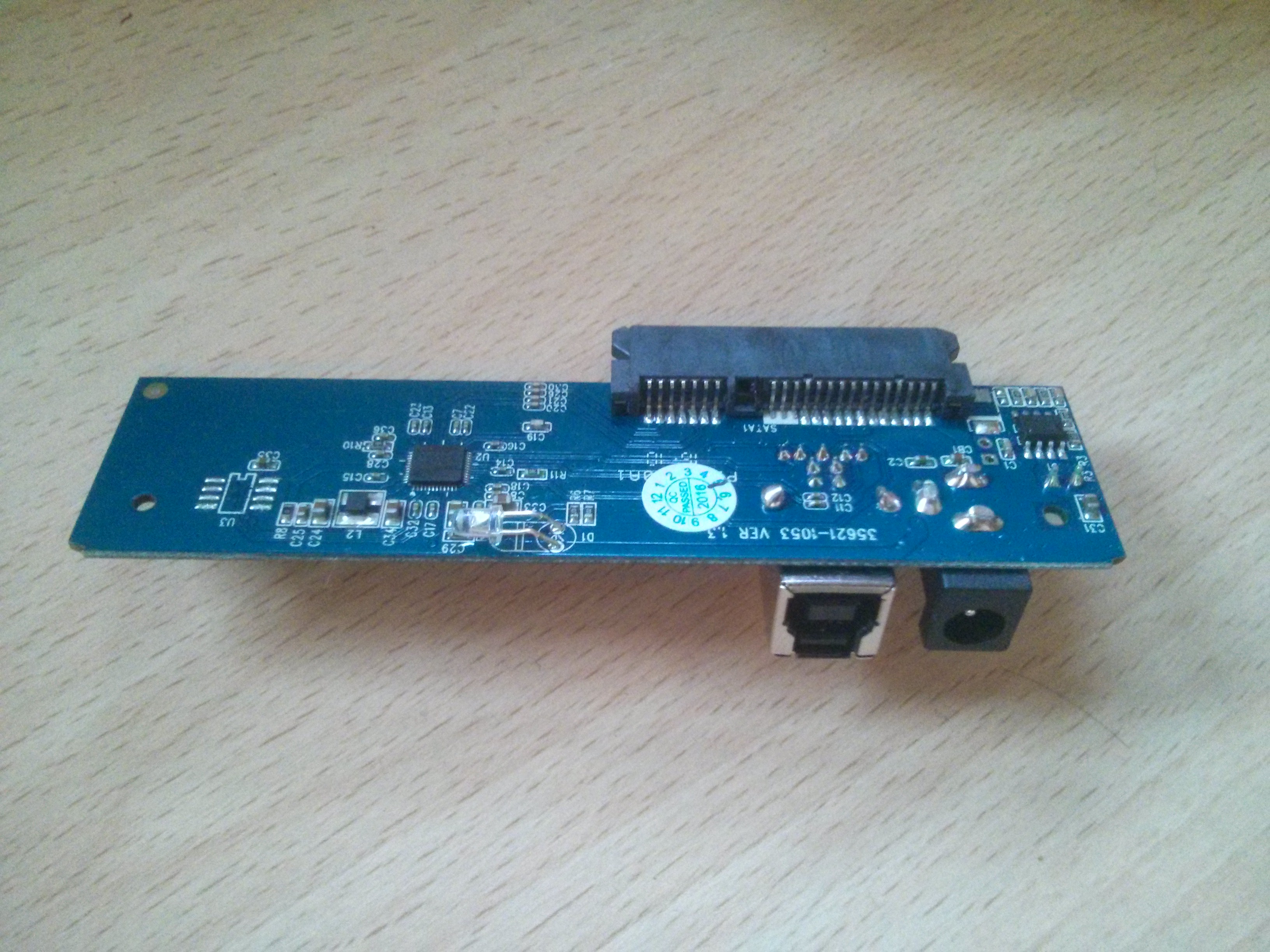

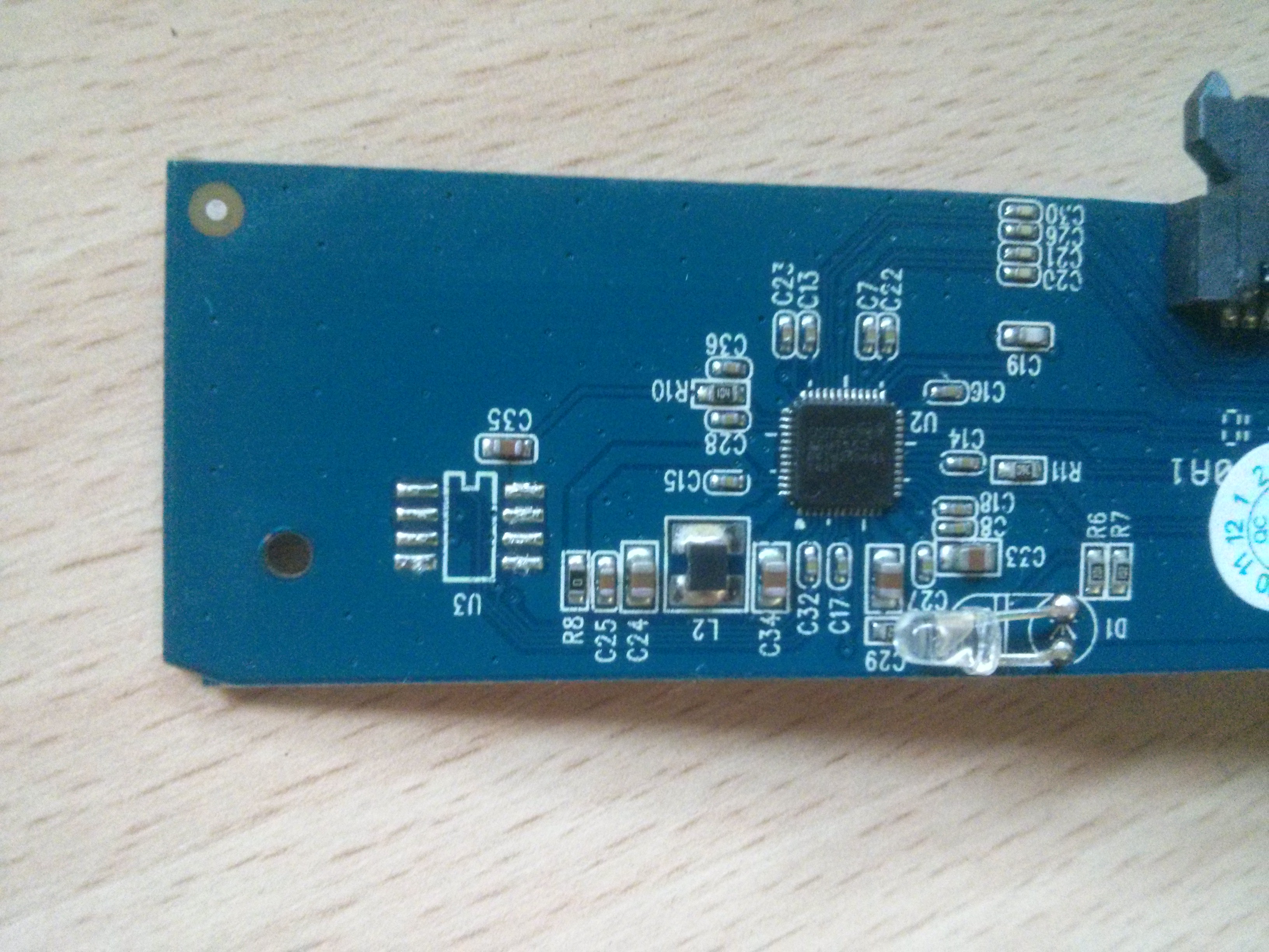

Could I please write a question here in about ASM1153 disk? Sorry to bother but I do not know Deutsch :(
OK, I will try writing in English, with the google translated text below. Sorry about that.
I bought two Tooq TQE-3527B USB 3.0 external 3.5" HDD enclosures. The problem I have with them, is that they never power down. I would like them to have a 10 minute sleep timeout. So I started investigating, opened an enclosure, and found an ASM1153 chip. I googled and found this forum. Then tried flashing the firmware using MPTool without success. Flash attempts always fail.
Then I noticed that the PCB Festplatten-Gehäuselacks a SOIC8 chip, that I suppose must be a 25L512 or 25LQ512 SPI flash chip (see the images below). I suppose that as the unit lacks this chip, it can store neither firmware updates nor configuration parameters changes.
So the question is: do you recommend me buying a 25L512 chip and soldering it to the board? Should I be able to flash the firmware after doing it, or is there anything else I should take into account?
Thanks!

OK, I have no 25LQ512 chips right now, but I have several 25LV040 lying around. The 040 has 8 times more memory than the 512, but they are supposed to be compatible, so I soldered the chip and gave it a try.
With the 25LV040, now when I launch MPTool and program the chip, the process successfully completes. But something does not work, because nothing else changes: firmware version, VID/PID, manufacturer and product strings, etc. I have tried using lots of different versions of MPTool, with and without disk, changing several configuration parameters, rebooting the disk after flash, etc. But there is no way, the firmware just does not get updated. The only thing that I have not tested is using a USB 3.0 port for the flash, but I suppose this does not make a difference.
I have seen more people in this forum reporting this problem (MPTool completes with success, but firmware does not get updated). Unfortunately it looks like there is no solution, right?
Any suggestions?

Bitte Versuche nichtzu löten das bringt meist nichts . Leider :jumpin:.
wenn nicht besorge dir ein Fantec oder Schau hier rein: ASMedia 1 Bay Gehäuse Chip Firmware für 8TB ++
Die Fantec Gehäuse lassen sich flashen
und die Firmware Läuft mit ihnen ohne Probleme getestet bis 12 TB,
aber denn noch übernehme ich keine Garantie.
