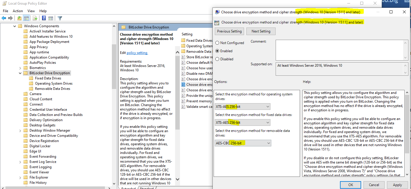

Und denke daran, für softwarebasiertes BitLocker vorher die Verschlüsselungsstärke auf ein aktuelles Niveau anzuheben:

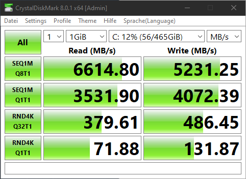

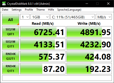

Mein Ergebnis soweit: Durch BitLocker braucht das System beim CrystalDiskMark ca. 5-6% bei einem 5900X im Vergleich zu 1% ohne.
Die Performanceeinbußen bei einer PCIe 4.0 NVME SSD sind vernachlässigbar. Warum Sequential Write schneller ist trotz Verschlüsselung weiß ich nicht, aber das zeigt wohl, dass einiges in der Margin of Error liegt.
Mit Verschlüsselung:
Ohne Verschlüsselung:
Reaktionen: massaker und Bob.Dig

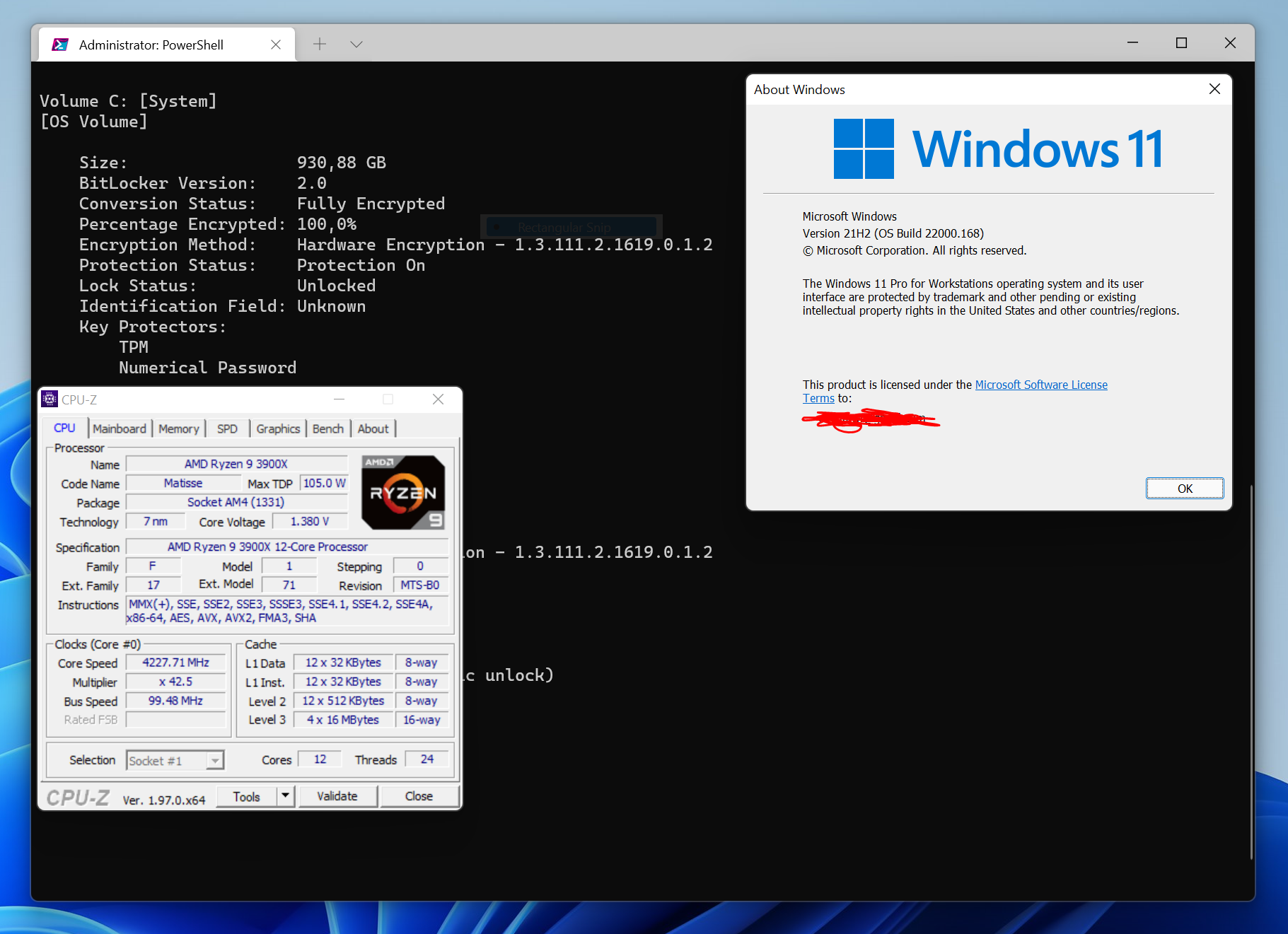

I did! (Sorry an English speaker here)
After months of searching, I found your awesome thread and learned about the Disable SID Block thing on my Gigabyte x570 Aorus.
Exact steps I used to activate hardware encryption on my Samsung 1TB 980 Pro NVMe on Windows 11:
  1. My PC had already Windows 11 installed and running using another drive (Samsung 500GB 960 EVO NVMe), no Bitlocker.
  2. Installed the 980 Pro as primary NVMe (CPU lane slot), and moved the 960 EVO to the other NVMe port (chipset)
  3. Booted Windows 11, enabled encryption via Samsung Magician (did not do a secure erase as the drive is basically untouched)
  4. Obtained ISO of Windows 10 version 1903 and put it on a bootable USB.
  5. Enabled "Disabled SID Block" on my UEFI, rebooted, F10 to confirm, and booted from the Windows 10 USB and installed it.
  6. During Windows 10 setup, I removed all partitions on old 960 EVO, and created a partition on the 980 Pro and installed Windows 10 1903 on that.
Important note: At every reboot, I always go to the UEFI and Enable "Disabled SID Block", do not know if it helped or not. Also I kept my LAN cable disconnected as I did not want Windows to do any updates that will disable hardware encryption at this point.
  1. Did the group policy things, held my breath...
  2. Voila! could enable hardware encryption on drive C: (SYSTEM DRIVE).
  3. Connected my LAN cable and joined the insider program and installed Windows 11!
  4. Hardware encryption carried on as you see on screenshot.
THANKS for everyone help in this thread and I hope I could contribute a little to the amazing amount of information here.
Best,
Mohamed Eltantawi
