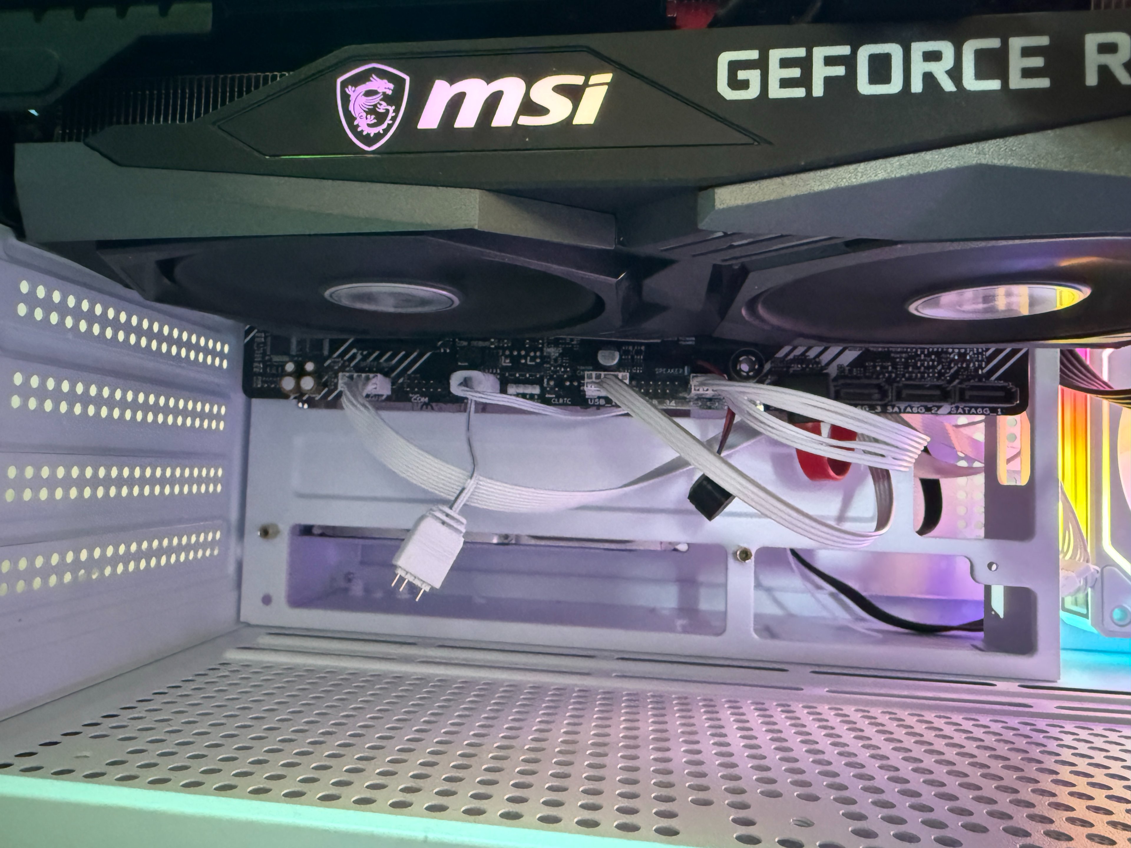

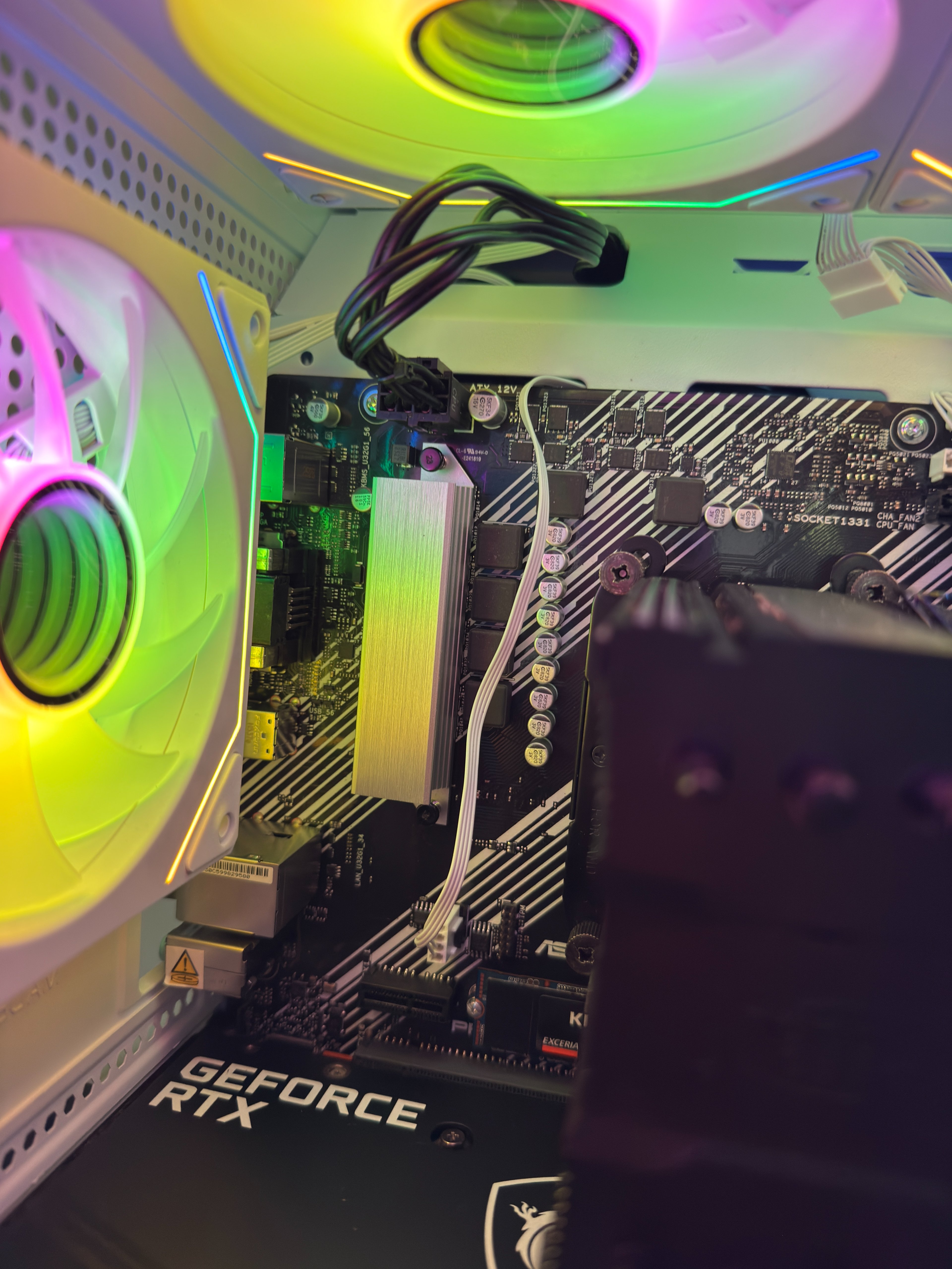

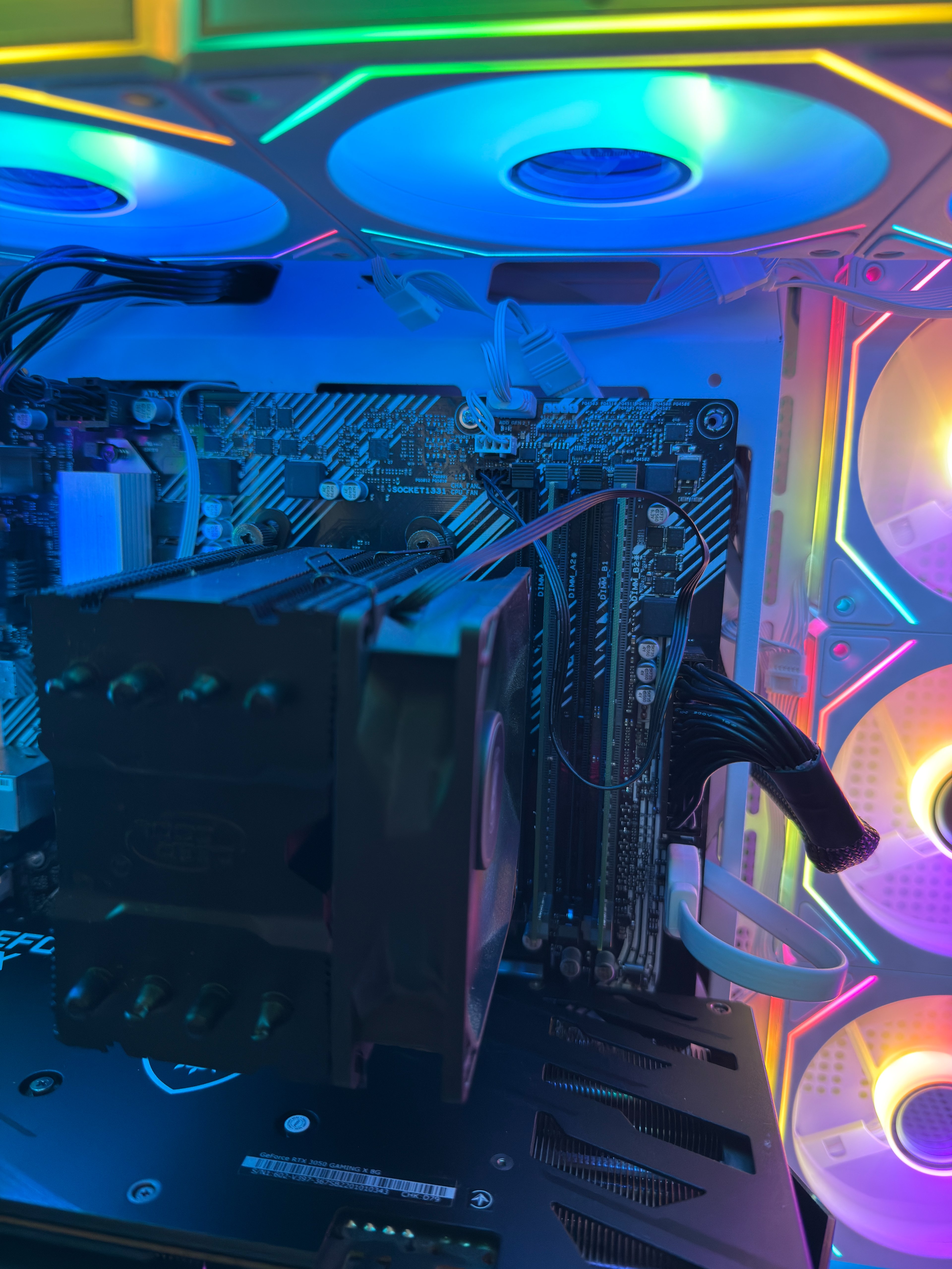

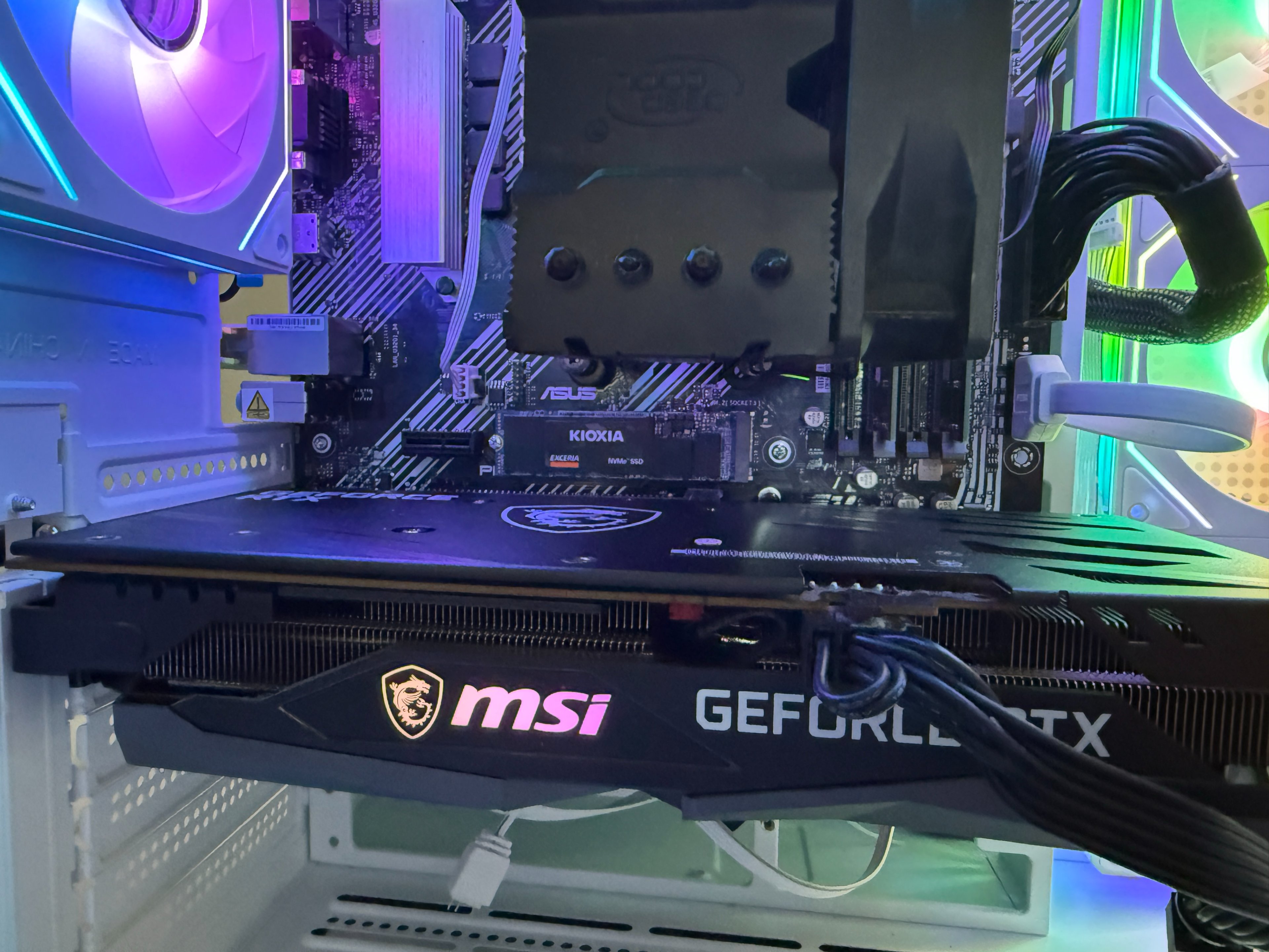

@TorenAltair its plugged in. here are pics from the pc inside and the HWINFO
  • HWMonitor.txt
    HWMonitor.txt
The CPU only gets 0.74V and the internal GPU isn‘t recognized either. Try to flash the UEFI with the latest version and load default settings after reboot. Then check the settings for CPU in the UEFI.
Da fehlen Befestigungsschrauben am MB.
Abstandshalter sind drunter?
Reaktionen: Volvo480, motorazrv3, UK Monkey und eine weitere Person
