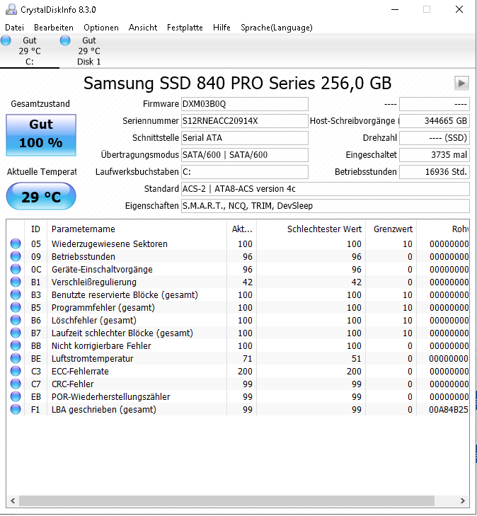

Disk-Test mittels CrystalDiskInfo
Und was kam raus? Mach nen Screenshot mit allen Werten, lade ihn hoch.

Die Tests mache ich sonst mit obengenannter Software nochmal und lade hier die Ergebnisse hoch.

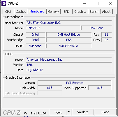

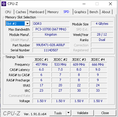

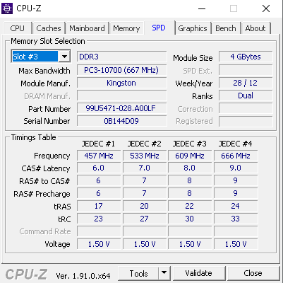

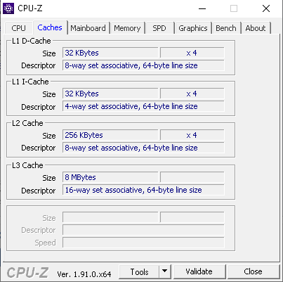

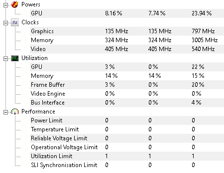

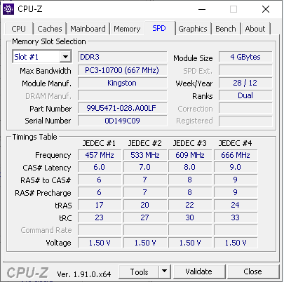

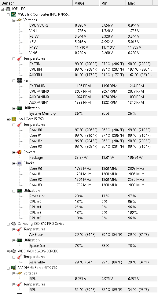

Soo bin nun endlich hier angekommen.
Fangs mal das erste was ich hab:
Leistungs Index
CPUID
CPUID HWMonitor Report

Mainboard Model        P7P55D-E (0x000001F7 - 0x00B685E4)
LPCIO
LPCIO Vendor            Winbond
LPCIO Model            W83667HG-A
LPCIO Vendor ID            0x5CA3
LPCIO Chip ID            0xB3
LPCIO Revision ID        0x53
Config Mode I/O address        0x2E
Config Mode LDN            0xB
Config Mode registers
        00 01 02 03 04 05 06 07 08 09 0A 0B 0C 0D 0E 0F
    00    FF FF FF FF FF FF FF 0B FF FF FF FF FF FF FF FF
    10    FF FF FF FF FF FF FF FF FF FF FF FF FF FF FF FF
    20    B3 53 FF 00 40 00 00 F8 40 00 00 7F 62 00 00 43
    30    01 FF FF FF FF FF FF FF FF FF FF FF FF FF FF FF
    40    FF FF FF FF FF FF FF FF FF FF FF FF FF FF FF FF
    50    FF FF FF FF FF FF FF FF FF FF FF FF FF FF FF FF
    60    02 90 FF FF FF FF FF FF FF FF FF FF FF FF FF FF
    70    00 FF FF FF FF FF FF FF FF FF FF FF FF FF FF FF
Register space            LPC, base address = 0x0290
Hardware Monitors
Hardware monitor        Winbond W83667HG
    Voltage 0        0.89 Volts [0x6F] (CPU VCORE)
    Voltage 1        1.74 Volts [0xD9] (VIN1)
    Voltage 2        3.34 Volts [0xD1] (+3.3V)
    Voltage 3        5.02 Volts [0xD1] (+5V)
    Voltage 4        11.71 Volts [0xD2] (+12V)
    Voltage 6        0.28 Volts [0x23] (VIN6)
    Temperature 0        98 degC (208 degF) [0x62] (SYSTIN)
    Temperature 1        99 degC (209 degF) [0xC5] (CPUTIN)
    Temperature 2        81 degC (177 degF) [0xA2] (AUXTIN)
    Fan 0            1214 RPM [0x8B] (SYSFANIN)
    Fan 1            2109 RPM [0x28] (CPUFANIN0)
    Fan 2            1089 RPM [0x9B] (AUXFANIN0)
    Fan 3            1232 RPM [0x89] (AUXFANIN1)

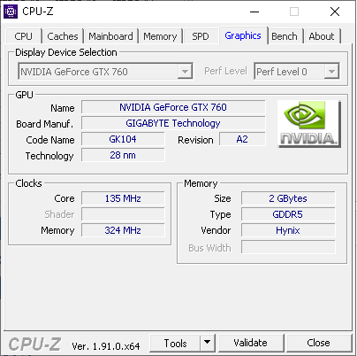

Hardware monitor        D3D
Hardware monitor        NVIDIA NVAPI
    Voltage 0        0.98 Volts [0x3CF] (GPU)
    Power 0            7.74 pc (GPU)
    Temperature 0        32 degC (89 degF) [0x20] (GPU)
    Fan 0            900 RPM [0x384] (GPU #0)
    Fan PWM 0        20 pc [0x14] (FANPWMIN0)
    Clock Speed 0        135.00 MHz [0x87] (Graphics)
    Clock Speed 1        324.00 MHz [0x144] (Memory)
    Clock Speed 2        n.a. (Processor)

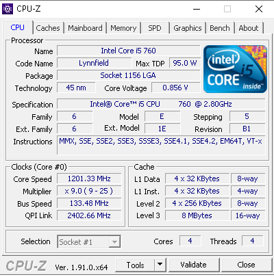

Processors Information
Socket 1            ID = 0
    Number of cores        4 (max 4)
    Number of threads    4 (max 4)
    Manufacturer        GenuineIntel
    Name            Intel Core i5 760
    Codename        Lynnfield
    Specification        Intel(R) Core(TM) i5 CPU         760  @ 2.80GHz
    Package (platform ID)    Socket 1156 LGA (0x1)
    CPUID            6.E.5
    Extended CPUID        6.1E
    Core Stepping        B1
    Technology        45 nm
    TDP Limit        95.0 Watts
    Core Speed        1335.2 MHz
    Multiplier x Bus Speed    10.0 x 133.5 MHz
    Base frequency (cores)    133.5 MHz
    Base frequency (ext.)    133.5 MHz
    Rated Bus speed        2403.3 MHz
    Stock frequency        2800 MHz
    Instructions sets    MMX, SSE, SSE2, SSE3, SSSE3, SSE4.1, SSE4.2, EM64T, VT-x
    Microcode Revision    0xA
    L1 Data cache        4 x 32 KBytes, 8-way set associative, 64-byte line size
    L1 Instruction cache    4 x 32 KBytes, 4-way set associative, 64-byte line size
    L2 cache        4 x 256 KBytes, 8-way set associative, 64-byte line size
    L3 cache        8 MBytes, 16-way set associative, 64-byte line size
    Max CPUID level        0000000Bh
    Max CPUID ext. level    80000008h
    Cache descriptor    Level 1, D, 32 KB, 2 thread(s)
    Cache descriptor    Level 1, I, 32 KB, 2 thread(s)
    Cache descriptor    Level 2, U, 256 KB, 2 thread(s)
    Cache descriptor    Level 3, U, 8 MB, 16 thread(s)
    FID/VID Control        yes
    Turbo Mode        supported, enabled
    Max turbo frequency    3333 MHz
    Max non-turbo ratio    21x
    Max turbo ratio        25x
    Max efficiency ratio    9x

    Temperature 0        97 degC (206 degF) (Core #0)
    Temperature 1        98 degC (208 degF) (Core #1)
    Temperature 2        96 degC (204 degF) (Core #2)
    Temperature 3        97 degC (206 degF) (Core #3)
    Power 00        24.50 W (Package)
    Clock Speed 0        1335.17 MHz (Core #0)
    Clock Speed 1        1468.69 MHz (Core #1)
    Clock Speed 2        1468.69 MHz (Core #2)
    Clock Speed 3        1468.69 MHz (Core #3)
    Core 0 max ratio    25.0 (effective 21.0)

Storage
Drive    0
    Name            Samsung SSD 840 PRO Series
    Revision        DXM03B0Q
    Serial            S12RNEACC20914X
    Capacity        238.5 GB
    Type            Fixed, SSD
    Bus Type        SATA (11)
    Features        SMART, TRIM
    Volume            c:\, 237.9 GBytes (22.0 percent available)

Hier noch die Werte von CPU Z

Leistung ! Ca. 350 TAUSEND Gigabyte schon auf der SSD geschrieben.
ok, kann sein dass die Mühle auch mit DREIEN der Arbeitsspeicher auch schneller läuft,
es gibt da Scenarios da will das Board KEIN VIER Speicherriegelbetrieb annehmen,
das aber nur wenn die Riegel identisch sind. Weis bis heute nicht warum !?
Meinste damit dass ich ne neue SSD brauche? :D
Reaktionen: emeraldmine
yo, die TBW (Terabytes written ?) liegt bei ca. 73-74 TB diesen Wert hast Du schon ca. 4.fach überschritten.
Reaktionen: FirstDau
Findet es keiner seltsam, dass die CPU-Temp. bei knapp 100°C liegt? Kein Wunder, dass die regelmäßig die Leistung drosselt.
Dass eine SSD auch mal (deutlich) mehr aushalten kann als die offiziellen Angaben wurde schon mehrfach getestet und mit der Samsung hast du auch kein Billig-Produkt. Außerdem wird der Wert für die ganze Baureihe angegeben und nicht explizit für das 250GB Modell. Lt. CDI gibt es keine Probleme, der geteilte Screenshot ist aber auch schwer zu lesen. Die 2 CRC-Fehler auf 16.000h kann man ignorieren. Auch mal im TaskManager die Datenträgerauslastung prüfen.
Reaktionen: FirstDau und kroto
Kühler ab und neue WLP drauf, wenn er Glück hat.
Stimmt, darauf hätte ich mich jetzt gar nicht geachtet, dann wirds definitiv wohl Zeit für die andere SSD, wenn nicht gleich ne neue kaufen, sind ja nicht mehr so teuer.

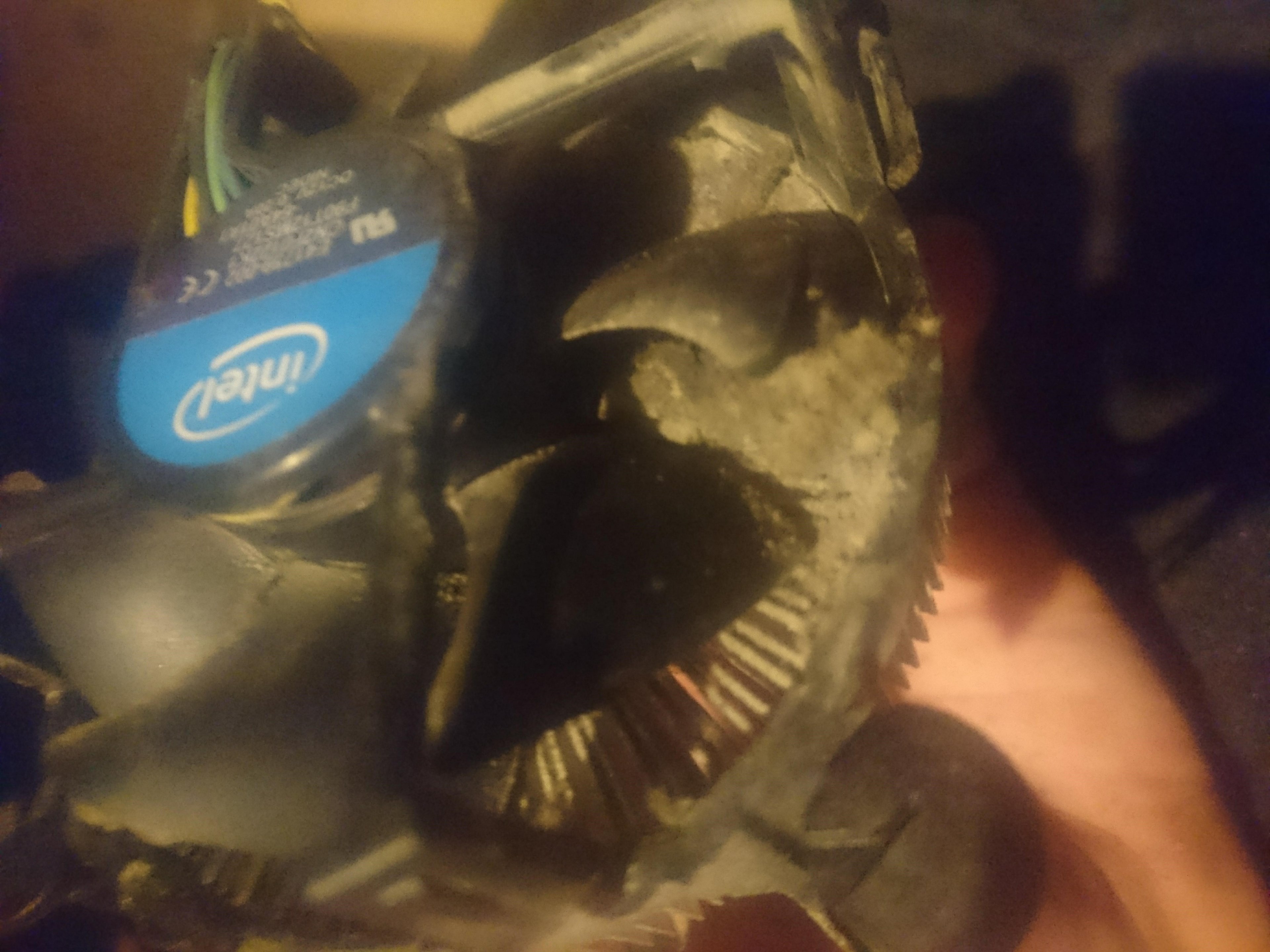

Habe die Kiste mal wieder geöffnet und siehe da, es hat sich doch so einiges mehr an Staub angesammelt als gedacht. :lol: Gleich auch die WLP erneuert, die dran klebte wie ne versteinerte Kruste.
Sogar gemerkt dass ich nebenbei noch ne EVGA GeForce GTX 770 rumliegen hab und mit dieser die Gigabyte GeForce GTX 760 WindForce ersetzt. Liege schon richtig dass diese (miiiinimal) besser ist?
Ist definitiv auch wieder viel schneller und die CPU Temperatur folglich viel tiefer als 100 Grad.
