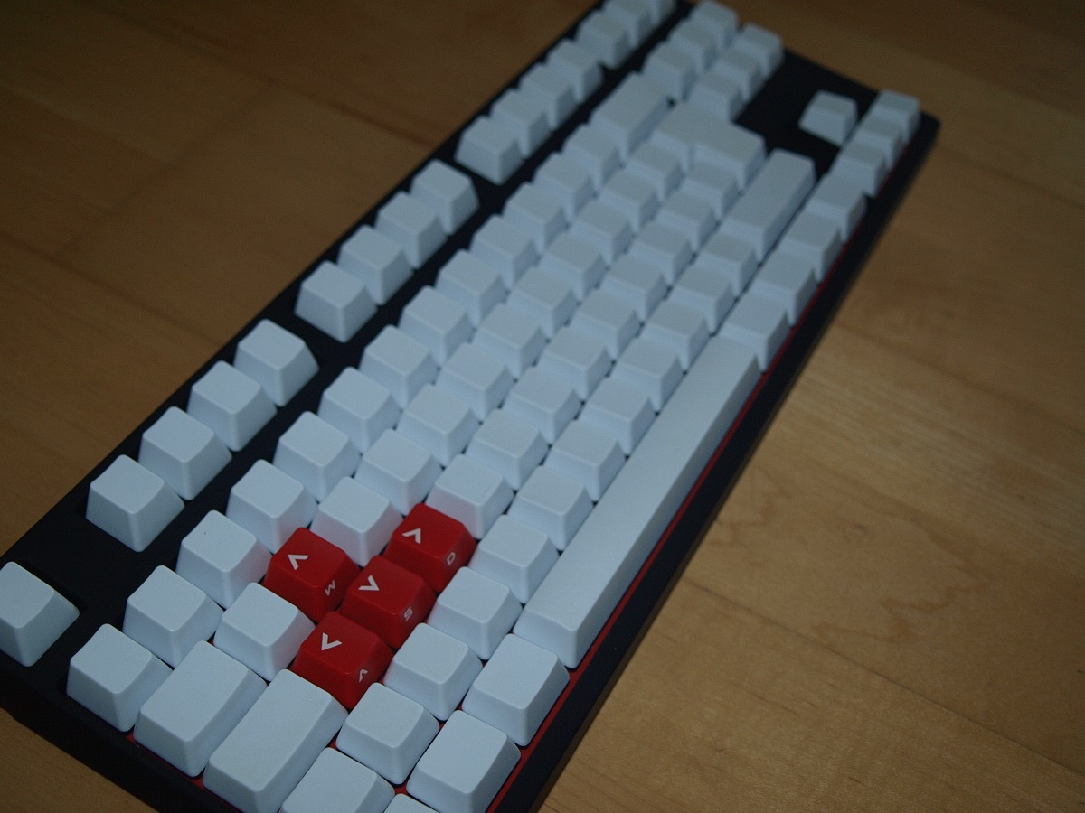

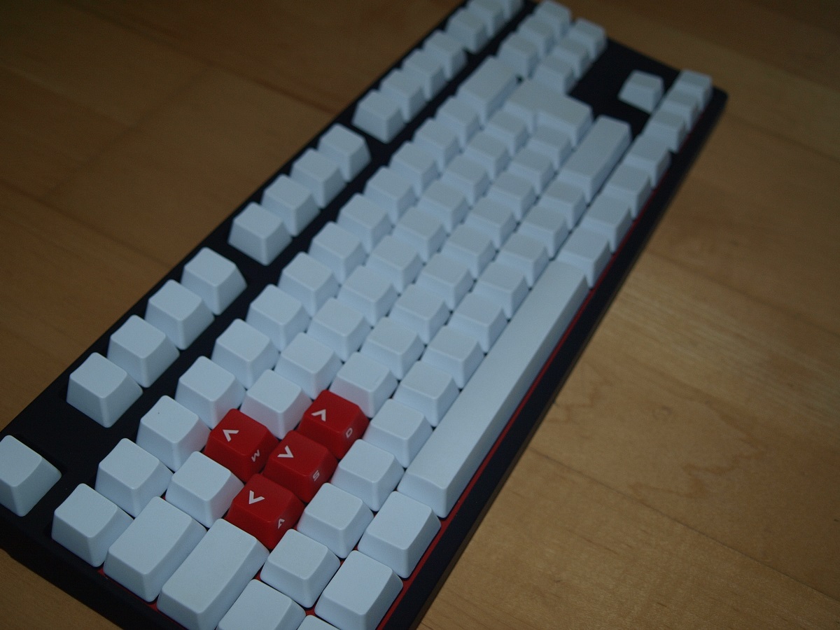

About This Design
Think Different – Base Set
PBT keyset.
Dye sublimation.
DSA profile.
Icon modifiers. No weird typography, no crazy colors, no fuss. This is the reserved, high-quality PBT set you’ve been waiting for.
For a full set, you will need at least this Base Set and the Standard Modifiers set. BaseSet
Color codes:
Light Gray (alphas): GSJ
Dark Gray (mods): GSK
Red: RCF
Base Set + Standard Modifiers:
TD_Overview
Other Think Different sets include:
Alternate Modifiers Kit (Supports most non-standard layouts)
Numpad Kit
ISO Kit
6.5u Spacebar
7u Spacebar
http://www.pimpmykeyboard.com/deals/think-different-dsa-dye-sub-pbt/
Da wirst du alles kriegen, die Tasten sind sogar dyesub PBT.
