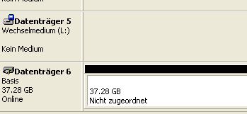

Im Anhang der Datenträgerverwaltung

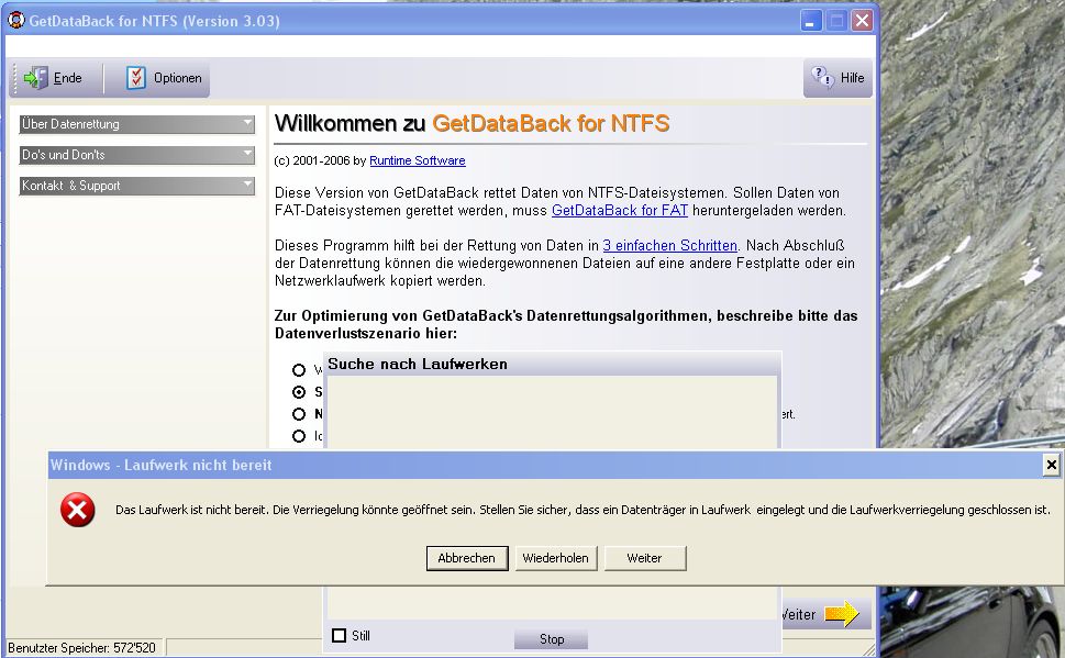

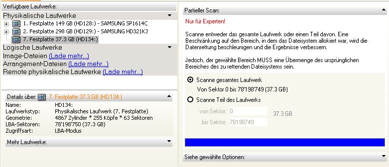

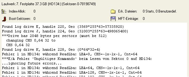

Hier mal ein paar Screenshots vom Getdataback:

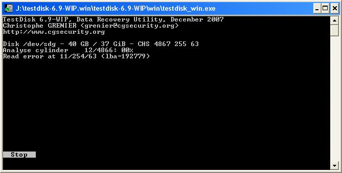

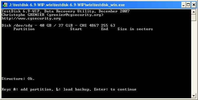

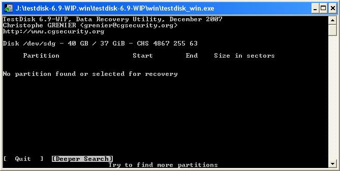

Hier noch der Auszug und die Screenshots von Testdisk:
Disk /dev/sda - 160 GB / 149 GiB - CHS 19457 255 63, sector size=512
Disk /dev/sdb - 320 GB / 298 GiB - CHS 38913 255 63, sector size=512
Disk /dev/sdg - 40 GB / 37 GiB - CHS 4867 255 63, sector size=512
Partition table type: Intel
Analyse Disk /dev/sdg - 40 GB / 37 GiB - CHS 4867 255 63
Current partition structure:
Partition: Read error
Ask the user for vista mode
Allow partial last cylinder : No
search_vista_part: 0
search_part()
file_read(6,16,buffer,36(0/0/37)) read err: Invalid argument
file_read(6,1,buffer,36(0/0/37)) read err: Invalid argument
file_read(6,1,buffer,37(0/0/38)) read err: Invalid argument
file_read(6,16,buffer,34(0/0/35)) read err: Invalid argument
file_read(6,1,buffer,34(0/0/35)) read err: Invalid argument
file_read(6,1,buffer,35(0/0/36)) read err: Invalid argument
file_read(6,1,buffer,38(0/0/39)) read err: Invalid argument
file_read(6,1,buffer,39(0/0/40)) read err: Invalid argument
file_read(6,1,buffer,40(0/0/41)) read err: Invalid argument
file_read(6,1,buffer,41(0/0/42)) read err: Invalid argument
file_read(6,16,buffer,42(0/0/43)) read err: Invalid argument
file_read(6,1,buffer,42(0/0/43)) read err: Invalid argument
file_read(6,1,buffer,43(0/0/44)) read err: Invalid argument
file_read(6,1,buffer,44(0/0/45)) read err: Invalid argument
file_read(6,1,buffer,45(0/0/46)) read err: Invalid argument
file_read(6,1,buffer,46(0/0/47)) read err: Invalid argument
file_read(6,1,buffer,47(0/0/48)) read err: Invalid argument
file_read(6,1,buffer,48(0/0/49)) read err: Invalid argument
file_read(6,1,buffer,49(0/0/50)) read err: Invalid argument
file_read(6,16,buffer,50(0/0/51)) read err: Invalid argument
file_read(6,1,buffer,50(0/0/51)) read err: Invalid argument
file_read(6,1,buffer,51(0/0/52)) read err: Invalid argument
file_read(6,1,buffer,52(0/0/53)) read err: Invalid argument
file_read(6,16,buffer,97(0/1/35)) read err: Invalid argument
file_read(6,1,buffer,97(0/1/35)) read err: Invalid argument
file_read(6,1,buffer,98(0/1/36)) read err: Invalid argument
file_read(6,1,buffer,99(0/1/37)) read err: Invalid argument
file_read(6,16,buffer,113(0/1/51)) read err: Invalid argument
file_read(6,1,buffer,113(0/1/51)) read err: Invalid argument
file_read(6,1,buffer,114(0/1/52)) read err: Invalid argument
file_read(6,1,buffer,116(0/1/54)) read err: Invalid argument
file_read(6,1,buffer,117(0/1/55)) read err: Invalid argument
file_read(6,1,buffer,118(0/1/56)) read err: Invalid argument
file_read(6,1,buffer,119(0/1/57)) read err: Invalid argument
file_read(6,1,buffer,120(0/1/58)) read err: Invalid argument
file_read(6,16,buffer,160(0/2/35)) read err: Invalid argument
file_read(6,1,buffer,160(0/2/35)) read err: Invalid argument
file_read(6,1,buffer,161(0/2/36)) read err: Invalid argument
file_read(6,1,buffer,162(0/2/37)) read err: Invalid argument
file_read(6,1,buffer,163(0/2/38)) read err: Invalid argument
file_read(6,1,buffer,164(0/2/39)) read err: Invalid argument
file_read(6,1,buffer,165(0/2/40)) read err: Invalid argument
file_read(6,1,buffer,167(0/2/42)) read err: Invalid argument
file_read(6,1,buffer,168(0/2/43)) read err: Invalid argument
file_read(6,1,buffer,169(0/2/44)) read err: Invalid argument
file_read(6,1,buffer,170(0/2/45)) read err: Invalid argument
file_read(6,16,buffer,66(0/1/4)) read err: Invalid argument
file_read(6,16,buffer,142(0/2/17)) read err: Invalid argument
file_read(6,1,buffer,142(0/2/17)) read err: Invalid argument
file_read(6,1,buffer,143(0/2/18)) read err: Invalid argument
file_read(6,1,buffer,144(0/2/19)) read err: Invalid argument
file_read(6,1,buffer,145(0/2/20)) read err: Invalid argument
file_read(6,1,buffer,146(0/2/21)) read err: Invalid argument
file_read(6,1,buffer,147(0/2/22)) read err: Invalid argument
file_read(6,1,buffer,148(0/2/23)) read err: Invalid argument
file_read(6,1,buffer,149(0/2/24)) read err: Invalid argument
file_read(6,16,buffer,189(0/3/1)) read err: Invalid argument
file_read(6,1,buffer,189(0/3/1)) read err: Invalid argument
file_read(6,1,buffer,190(0/3/2)) read err: Invalid argument
file_read(6,1,buffer,191(0/3/3)) read err: Invalid argument
file_read(6,1,buffer,192(0/3/4)) read err: Invalid argument
file_read(6,1,buffer,196(0/3/8)) read err: Invalid argument
file_read(6,1,buffer,197(0/3/9)) read err: Invalid argument
file_read(6,1,buffer,199(0/3/11)) read err: Invalid argument
file_read(6,16,buffer,137(0/2/12)) read err: Invalid argument
file_read(6,1,buffer,137(0/2/12)) read err: Invalid argument
file_read(6,1,buffer,138(0/2/13)) read err: Invalid argument
file_read(6,16,buffer,205(0/3/17)) read err: Invalid argument
file_read(6,1,buffer,206(0/3/18)) read err: Invalid argument
file_read(6,1,buffer,207(0/3/19)) read err: Invalid argument
file_read(6,1,buffer,208(0/3/20)) read err: Invalid argument
file_read(6,1,buffer,209(0/3/21)) read err: Invalid argument
file_read(6,1,buffer,210(0/3/22)) read err: Invalid argument
file_read(6,1,buffer,211(0/3/23)) read err: Invalid argument
file_read(6,1,buffer,212(0/3/24)) read err: Invalid argument
file_read(6,16,buffer,252(0/4/1)) read err: Invalid argument
file_read(6,1,buffer,252(0/4/1)) read err: Invalid argument
file_read(6,1,buffer,253(0/4/2)) read err: Invalid argument
file_read(6,1,buffer,254(0/4/3)) read err: Invalid argument
file_read(6,1,buffer,255(0/4/4)) read err: Invalid argument
file_read(6,16,buffer,32132(2/0/3)) read err: Invalid argument
file_read(6,1,buffer,32133(2/0/4)) read err: Invalid argument
file_read(6,16,buffer,32130(2/0/1)) read err: Invalid argument
file_read(6,1,buffer,32131(2/0/2)) read err: Invalid argument
file_read(6,16,buffer,32138(2/0/9)) read err: Invalid argument
file_read(6,1,buffer,32138(2/0/9)) read err: Invalid argument
file_read(6,1,buffer,32139(2/0/10)) read err: Invalid argument
file_read(6,1,buffer,32140(2/0/11)) read err: Invalid argument
file_read(6,1,buffer,32142(2/0/13)) read err: Invalid argument
file_read(6,1,buffer,32144(2/0/15)) read err: Invalid argument
file_read(6,1,buffer,32145(2/0/16)) read err: Invalid argument
file_read(6,16,buffer,32146(2/0/17)) read err: Invalid argument

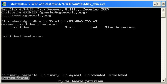

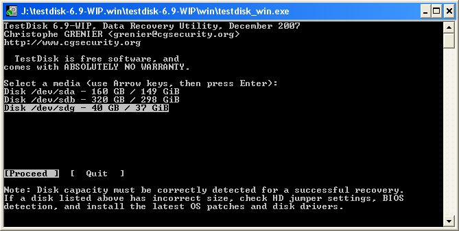

Schaue mal, ob Testdisk die Partition nach bestätigen bei Quick Search findet.
Kann auch sein, daß wenn die nicht in der Partitionstabelle steht, ein Scan startet.
Teile mal mit ob der scan das durchhält, laangsam ist oder abbricht.
Wenn dein Dateisystem NTFS ist, und die Dateien und Ordner angezeigt werden, kannst du diese kopieren.
Linux kann öfters bei Sektorfehler die Daten noch erkennen und die Daten kopieren.
Testdisk mounted Laufwerke wie Linux.
Mache daher mal eine Diagnose;
Mache mal eine Diagnose nach dieser Anleitung;
Lade dir mal Testdisk Version 6.9 beta für Windows.
Link dazu gibt es hier;
https://www.computerbase.de/downloads/systemtools/festplatten/testdisk/

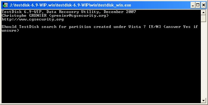

Starte Testdisk bestätige bei dem Log-Datei-Screen mit Enter, wähle deine betroffene Festplatte aus und bestätige mit Enter, bestätige bei Partition Table Typ Intel, bestätige bei Analyse mit Enter und setze mir einen Screenshot.
Bestätige auch bei Quick Search mit Enter (wenn nötig wegen Vista-check mit y) und setze mir auch den Screen.
Markiere mal die betroffenen Partitionen und drücke p auf der Tastatur ob deine Daten angezeigt werden oder eine Fehlermeldung.
Zurück kommst du mit q drücken.
Wenn keine Partition mit Daten gefunden wurde;
Bestätige weiter bis du zum Menü kommst wo unten steht [Quit] Deeper [Search] [Write] und gehe mit dem Pfeil auf [Deeper Search] (tiefere Suche) und lasse es laufen.
Setze mir auch einen Screenshot.
Die betroffene Partition sollte wenn du den Screen machst markiert sein.
Viele Grüße
Fiona
Hi Fiona,
Besten Dank!
Anscheinend hat sich unser Post überschnitten :-).
Hier noch der Printscreen, -> nun mit Enter weiter?
Gruss Reto

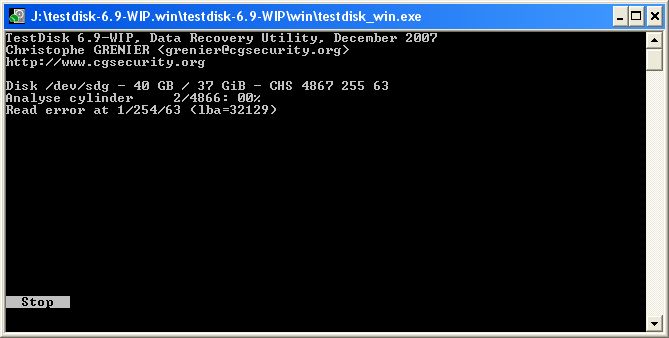

Nun läuft der Deeper Search.
Hier ein Auszug aus dem Log:
Results
interface_write()
No partition found or selected for recovery
search_part()
file_read(6,16,buffer,6(0/0/7)) read err: Invalid argument
Der Deeper Search ist extrem langsam, hier kam nun der erste Error:
Auch bei Fehler in Sektoren kann Testdisk die Daten noch anzeigen.
Teile es mal mit, wenn zu viele kommen und der scan zu langsam wird.
Bei der tieferen Suche werden Partitionen anhand vom Backup vom Bootsektor gesucht.
Vielleicht klappts.
Viele Grüße
Fiona
Hi Fiona,
Der Scan läuft nun schon ca. 30min und steht immer noch bei 00% (siehe Anhang)!
Soll ich den Scan abbrechen oder laufen lassen?
Was meinst du der Gefriermethode wurde mir auch schon in einem anderen Forum empfohlen?
Gruss Reto
Ich weiß es nicht mit der Gefriermethode in der Datenrettung?
Habe darüber bereits einiges gehört und sollte in einigen Fällen schon geholfen haben.
USB ist nicht gerade stabil bei Probleme mit Lesefehler, wenn du die extern eingebaut hast.
Vielleicht bringt es vielleicht was, wenn du die Festplatte intern einbaust, die zusätzlich noch mit Ventilator bei einem Wärmeproblem kühlst und den Rechner offen läßt.
Versuche dann vielleicht mal eine Diagnose unter DOS mit der Testdisk BootCD oder Knoppix?
Auch könnte Datenrettungssoftware wie www.uneraser unter DOS vielleicht was bringen.
In der Tesversion, könntest du einen scan versuchen, ob es besser ist.
Viele Grüße
Fiona
