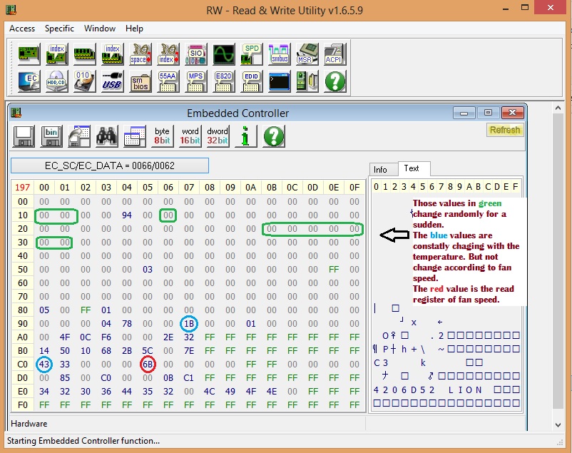

Sorry. i'm portuguese. Have to speak in english. I can't configure my Samsung NP550P5C. I see a value 05xC0 that is the reading of the speed fan goes from 6B (min) to 50 (max), but editing that value doesn't change anything to the fan. The write registers are too many to understand the behavior of the EC to the constant changes... I really need some help 'cause I'm lost in here. :(
Here's an screenshot of my EC in standby and with some resume.
Thanks in advance. Nice tool BTW.
