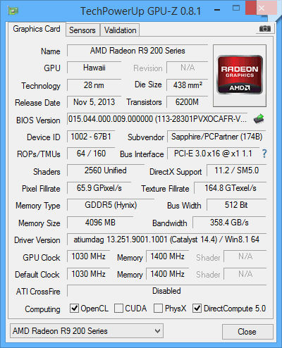

Bus Interface: PCI-E 3.0x16 @ x1 1.1

click on the question mark by "PCIe 3.0x16 @ x1 1.1"
then run the render test.
watch the pcie 1.1 label.
it will change to pcie 3.0.
it changes it based on what your doing in order to save power,and task the power supply less.
