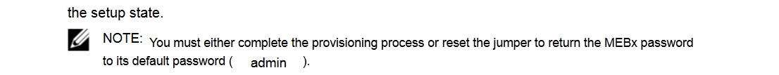

http://www.manualslib.com/manual/227526/Dell-Optiplex-745.html?page=9
Am besten hier nochmal erklärt. http://kb.stonegroup.co.uk/index.php?View=entry&EntryID=196

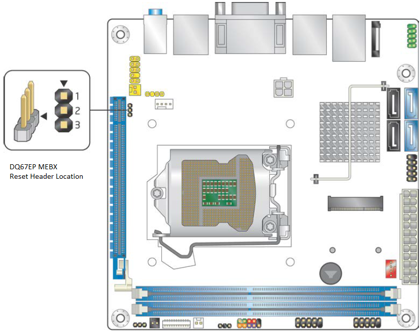

Clearing the AMT Configuration or Settings
Intel Q Series desktop motherboards contain AMT functionality. AMT functionality and settings are not cleared by resetting the main CMOS by loading BIOS defaults. Intel B series boards can also have AMT functionality and again the AMT settings are not cleared by resetting the main CMOS by loading BIOS defaults.
To clear the AMT settings, either perform a full manual settings clear or using the dedicated MEBX (Management Engine BIOS Extension) Reset Jumper.
Using the MEBX Reset Jumper (the recommended method)
Locate the MEBX Reset Header (see diagrams below).
Shut the system down and disconnect the AC mains.
Short pins 1 and 2 of the header together for 5 seconds.
Reconnect the AC mains.
Test that the password has been cleared.
Mhhh das sieht gut aus...

Ich habe leider keine PINS wie auf dem Bild habe das ganze wirklich das ganze Board dannach abgesucht...
