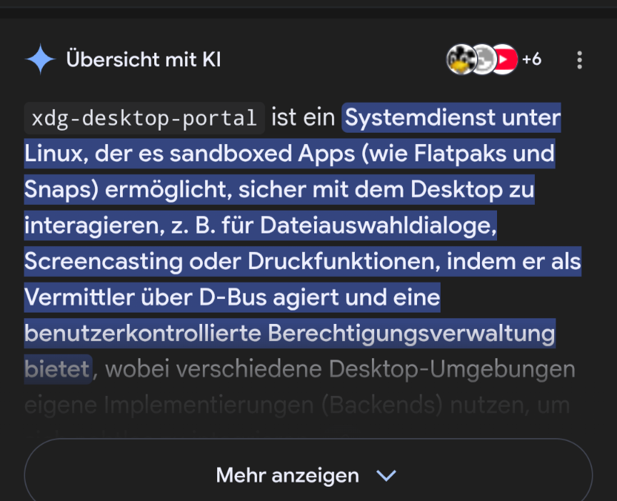

The error "A backend call failed: Inhibiting other than idle not supported" indicates that a desktop portal service is unable to handle inhibition requests for purposes other than idle, such as preventing system sleep during specific operations like screen recording or audio processing.
This issue commonly arises with the xdg-desktop-portal-gtk service, particularly in non-GNOME desktop environments like XFCE or Wayland compositors such as Wayfire.
The error occurs because the backend does not support non-idle inhibition, which is required by some applications for proper functionality. For example, in XFCE with EasyEffects, the xdg-desktop-portal-xapp service may be correctly running, but the EnableAutostart call fails due to the absence of the org.freedesktop.impl.portal.Background interface, which is related to background service management.
The root cause is often a missing or incorrect XDG_CURRENT_DESKTOP environment variable, which can prevent the portal service from properly initializing its features.
For instance, in Wayfire, setting Environment=XDG_CURRENT_DESKTOP=Wayfire in the systemd service file for xdg-desktop-portal-wlr resolved similar issues. Similarly, ensuring the correct session environment is established via xinitrc or the desktop session startup script is crucial for proper D-Bus and session bus access, which are necessary for portal services to function correctly.
To resolve this, ensure the XDG_CURRENT_DESKTOP variable is set appropriately for your environment, and verify that the portal service is started through the correct session initialization method rather than manually via systemctl --user start.
Additionally, confirm that the correct portal backend (e.g., xdg-desktop-portal-gtk, xdg-desktop-portal-xapp, or xdg-desktop-portal-wlr) is enabled and properly configured in the portals.conf file.
Quelle: search.brave.com
Suchbegriff: "xdg-desktop-portal backend call failed - inhibiting other than idle not supported"
